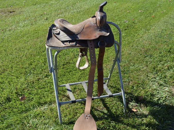

    • Unbuckle the fender.
  2. Western Saddle Fender Replacement: crwdns2935265:02crwdnd2935265:01crwdnd2935265:01crwdne2935265:0
    • Remove the stirrup from the fender.
  3. Western Saddle Fender Replacement: crwdns2935265:03crwdnd2935265:01crwdnd2935265:01crwdne2935265:0
    • Pull on the fender leather to remove the fender from the saddle.

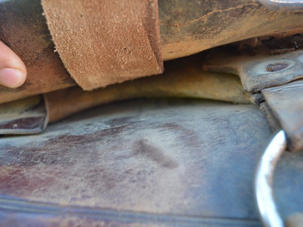

    • Run the new stirrup leather over the bar.
  6. Western Saddle Fender Replacement: crwdns2935265:06crwdnd2935265:01crwdnd2935265:02crwdne2935265:0 Western Saddle Fender Replacement: crwdns2935265:06crwdnd2935265:02crwdnd2935265:02crwdne2935265:0
    • Bring the fender leather out on the underside of the saddle.
  7. Western Saddle Fender Replacement: crwdns2935265:07crwdnd2935265:01crwdnd2935265:02crwdne2935265:0 Western Saddle Fender Replacement: crwdns2935265:07crwdnd2935265:02crwdnd2935265:02crwdne2935265:0
    • Push the leather back under the bar over the rigging.
  8. Western Saddle Fender Replacement: crwdns2935265:08crwdnd2935265:01crwdnd2935265:01crwdne2935265:0
    • Pull the stirrup leather tight.
  9. Western Saddle Fender Replacement: crwdns2935265:09crwdnd2935265:01crwdnd2935265:02crwdne2935265:0 Western Saddle Fender Replacement: crwdns2935265:09crwdnd2935265:02crwdnd2935265:02crwdne2935265:0
    • Put stirrup, blevins, and hobble back on the new stirrup.
  10. Western Saddle Fender Replacement: crwdns2935265:010crwdnd2935265:01crwdnd2935265:02crwdne2935265:0 Western Saddle Fender Replacement: crwdns2935265:010crwdnd2935265:02crwdnd2935265:02crwdne2935265:0
    • Slide the blevins over the stirrup holes.
  11. Western Saddle Fender Replacement: crwdns2935265:011crwdnd2935265:01crwdnd2935265:01crwdne2935265:0
    • After the fender is fixed the saddle should be ready to ride.
The fender is replaced and you are ready to ride!
