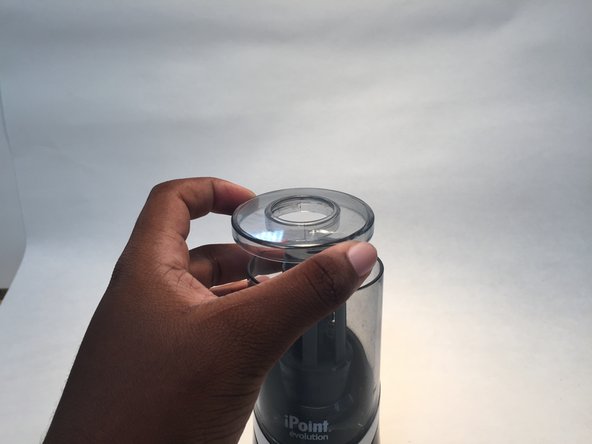

    • There are three parts of the sharpener.
    • Step 3: Grab the very top of the sharpener, twist it to the right and lift it up to remove it.

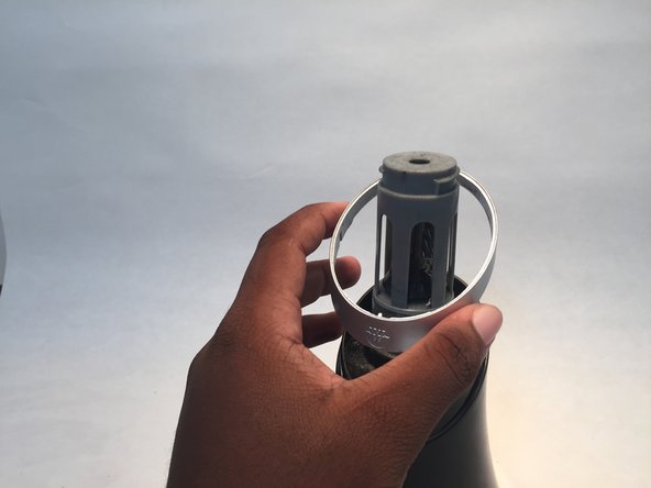

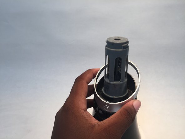

    • Step 4: Grab the center of the sharpener and lift it up to remove the piece.
  5. Westcott iPoint Evolution Outer Casing Replacement: crwdns2935265:05crwdnd2935265:01crwdnd2935265:03crwdne2935265:0 Westcott iPoint Evolution Outer Casing Replacement: crwdns2935265:05crwdnd2935265:02crwdnd2935265:03crwdne2935265:0 Westcott iPoint Evolution Outer Casing Replacement: crwdns2935265:05crwdnd2935265:03crwdnd2935265:03crwdne2935265:0
    • Step 5: Remove the small ring that is around the sharpener.
    • This piece is below the center of the sharpener that you just removed.
