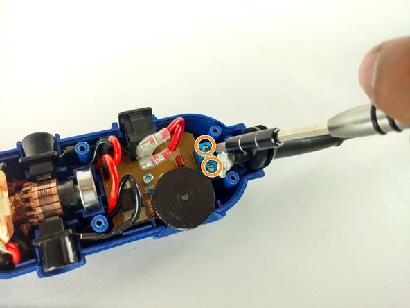

    1. Wen 2307 Power Cable Replacement, Power Cable: crwdns2935265:06crwdnd2935265:01crwdnd2935265:02crwdne2935265:0 Wen 2307 Power Cable Replacement, Power Cable: crwdns2935265:06crwdnd2935265:02crwdnd2935265:02crwdne2935265:0
      • Identify the screws.
      • Unscrew the two 3mm phillips PH2.
      • Don't forget to put them appart from the ones unscrewed before.
      • Phillips PH2
      • Flathead 2.5mm
    2. Wen 2307 Power Cable Replacement: crwdns2935265:07crwdnd2935265:01crwdnd2935265:01crwdne2935265:0
      • Remove the place boar carefully.
    3. Wen 2307 Power Cable Replacement: crwdns2935265:08crwdnd2935265:01crwdnd2935265:01crwdne2935265:0
      • Pull out the power cable connectors.
    4. Wen 2307 Power Cable Replacement: crwdns2935265:09crwdnd2935265:01crwdnd2935265:01crwdne2935265:0
      • Pull out the cord sleve for the new cable replacement.
