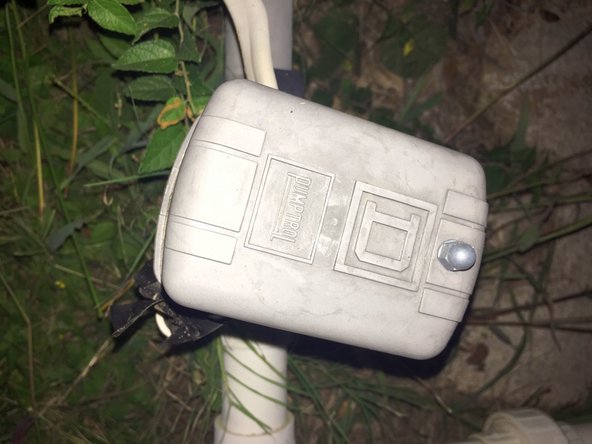

    • Here is a time lapse of what the pressure gauge showed. The pressure switch did not cutoff and rising pressure caused some faucets to develop leaks.

    • WARNING: The switch is supplied with 220V so one has to be careful not to get zapped. The first thing before doing anything is to flip the breaker to the pump switch and check it with a meter to ensure it is off.
    • Remove the small nut from the cover to gain access to the switch.

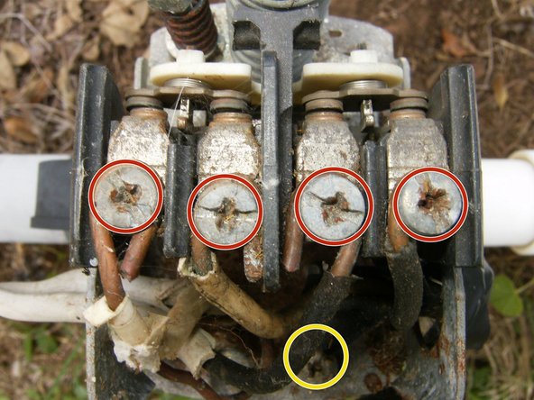

    • With the cover removed, check for power across the switch from supply lines L1 and L2 (Blue marker). Ensure that there is 0 volt.

    • Loosen the 4 screws that hold the wires to the switch
    • The ground screw on the bottom of the switch shares the ground from the supply line and from the pump. Remove those as well.

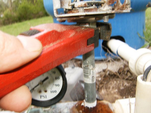

    • With the wires removed from the switch and the water line drained, remove the switch from the nipple attached to the check valve. Use a suitable wrench like an adjustable or in this case a pipe wrench

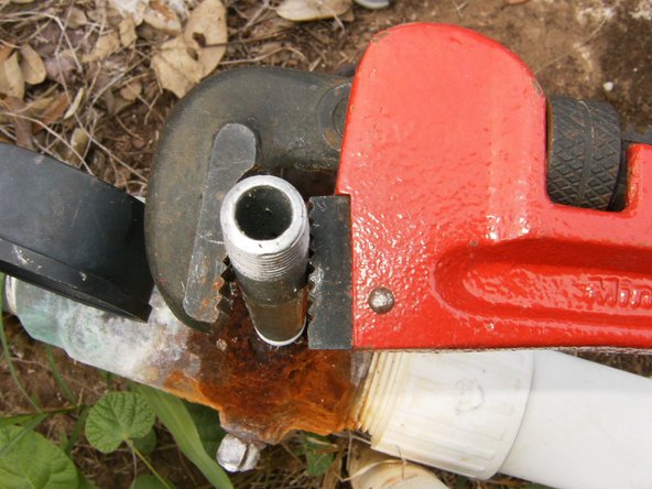

    • It became immediately obvious that the nipple was almost completely corroded of the check valve. It broke off while attempting to remove the pressure switch.
    • After the use of a couple of choice words and cleaning the damage on check valve, it turned out that the thread was not damaged.
    • In this case the nipple needs to be replaced as well. The bottom one is the corroded one and the top is the new one.
    • Corrosion and debris on the inside of the nipple show that it is almost entirely occluded.
  4. Well Pump  Pressure Switch Replacement: crwdns2935265:05crwdnd2935265:01crwdnd2935265:03crwdne2935265:0 Well Pump  Pressure Switch Replacement: crwdns2935265:05crwdnd2935265:02crwdnd2935265:03crwdne2935265:0 Well Pump  Pressure Switch Replacement: crwdns2935265:05crwdnd2935265:03crwdnd2935265:03crwdne2935265:0
    • Here is the inlet to the pressure switch. Again visible is the large amount of corrosion and debris from the corroded nipple. this is what most likely caused the pressure switch to fail.
