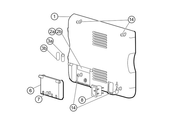

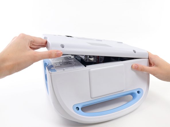

  13. Welch Allyn Connex Vital Signs Monitor 6000 Motherboard Replacement, Rear Housing: crwdns2935265:013crwdnd2935265:01crwdnd2935265:02crwdne2935265:0 Welch Allyn Connex Vital Signs Monitor 6000 Motherboard Replacement, Rear Housing: crwdns2935265:013crwdnd2935265:02crwdnd2935265:02crwdne2935265:0
    • Open the communications door to access the lower left-hand rear housing screw.
    • Remove the four Phillips #2 screws (labeled 14 in the service manual) from the rear housing.
  14. Welch Allyn Connex Vital Signs Monitor 6000 Motherboard Replacement: crwdns2935265:014crwdnd2935265:01crwdnd2935265:02crwdne2935265:0 Welch Allyn Connex Vital Signs Monitor 6000 Motherboard Replacement: crwdns2935265:014crwdnd2935265:02crwdnd2935265:02crwdne2935265:0
    • With the handle/alert bar facing you, begin to lift the rear housing from the left side, holding the right side securely.
    • Do not attempt to separate the rear housing from the monitor, it is still attached with several cables.

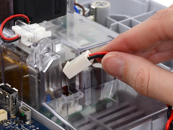

  16. Welch Allyn Connex Vital Signs Monitor 6000 Motherboard Replacement: crwdns2935265:016crwdnd2935265:01crwdnd2935265:03crwdne2935265:0 Welch Allyn Connex Vital Signs Monitor 6000 Motherboard Replacement: crwdns2935265:016crwdnd2935265:02crwdnd2935265:03crwdne2935265:0 Welch Allyn Connex Vital Signs Monitor 6000 Motherboard Replacement: crwdns2935265:016crwdnd2935265:03crwdnd2935265:03crwdne2935265:0

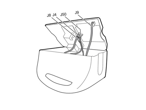

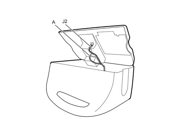

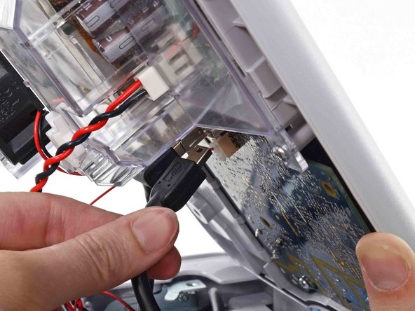

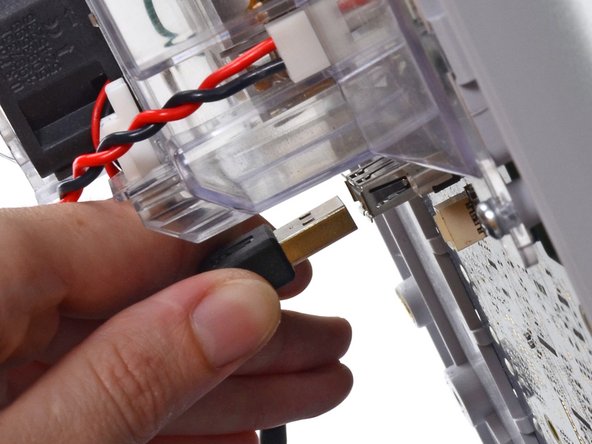

    • Disconnect the fan cable (labeled connector A in the service manual) from its socket in the power supply.
  17. Welch Allyn Connex Vital Signs Monitor 6000 Motherboard Replacement: crwdns2935265:017crwdnd2935265:01crwdnd2935265:03crwdne2935265:0 Welch Allyn Connex Vital Signs Monitor 6000 Motherboard Replacement: crwdns2935265:017crwdnd2935265:02crwdnd2935265:03crwdne2935265:0 Welch Allyn Connex Vital Signs Monitor 6000 Motherboard Replacement: crwdns2935265:017crwdnd2935265:03crwdnd2935265:03crwdne2935265:0
    • Unplug the small USB connector from its socket (labeled J4 in the service manual).
  18. Welch Allyn Connex Vital Signs Monitor 6000 Motherboard Replacement: crwdns2935265:018crwdnd2935265:01crwdnd2935265:03crwdne2935265:0 Welch Allyn Connex Vital Signs Monitor 6000 Motherboard Replacement: crwdns2935265:018crwdnd2935265:02crwdnd2935265:03crwdne2935265:0 Welch Allyn Connex Vital Signs Monitor 6000 Motherboard Replacement: crwdns2935265:018crwdnd2935265:03crwdnd2935265:03crwdne2935265:0

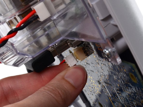

    • Disconnect the communications power cable from its socket (labeled J50 in the service manual).
    • Only pull on the connector itself and not the socket. This connection is very tight, work the connector slowly and gently.
  19. Welch Allyn Connex Vital Signs Monitor 6000 Motherboard Replacement: crwdns2935265:019crwdnd2935265:01crwdnd2935265:03crwdne2935265:0 Welch Allyn Connex Vital Signs Monitor 6000 Motherboard Replacement: crwdns2935265:019crwdnd2935265:02crwdnd2935265:03crwdne2935265:0 Welch Allyn Connex Vital Signs Monitor 6000 Motherboard Replacement: crwdns2935265:019crwdnd2935265:03crwdnd2935265:03crwdne2935265:0
    • Unplug the large USB connector from its socket (labeled J8 in the service manual).
  20. Welch Allyn Connex Vital Signs Monitor 6000 Motherboard Replacement: crwdns2935265:020crwdnd2935265:01crwdnd2935265:03crwdne2935265:0 Welch Allyn Connex Vital Signs Monitor 6000 Motherboard Replacement: crwdns2935265:020crwdnd2935265:02crwdnd2935265:03crwdne2935265:0 Welch Allyn Connex Vital Signs Monitor 6000 Motherboard Replacement: crwdns2935265:020crwdnd2935265:03crwdnd2935265:03crwdne2935265:0
    • Press the tab on the ethernet cable and unplug it from its socket (labeled J9 in the service manual).

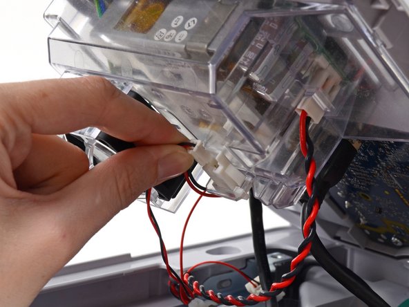

    • The following connector requires two hands to disconnect. Flip the rear case over, and lay it on its back to gain access to the power supply cable.

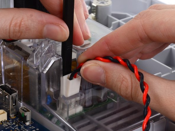

  22. Welch Allyn Connex Vital Signs Monitor 6000 Motherboard Replacement: crwdns2935265:022crwdnd2935265:01crwdnd2935265:03crwdne2935265:0 Welch Allyn Connex Vital Signs Monitor 6000 Motherboard Replacement: crwdns2935265:022crwdnd2935265:02crwdnd2935265:03crwdne2935265:0 Welch Allyn Connex Vital Signs Monitor 6000 Motherboard Replacement: crwdns2935265:022crwdnd2935265:03crwdnd2935265:03crwdne2935265:0
    • The power supply cable is secured by an interlocking connector that must be held open to unplug the connector.
    • Insert the flat end of a spudger down into the power supply cover between the socket clip and the power supply connector.
  23. Welch Allyn Connex Vital Signs Monitor 6000 Motherboard Replacement: crwdns2935265:023crwdnd2935265:01crwdnd2935265:03crwdne2935265:0 Welch Allyn Connex Vital Signs Monitor 6000 Motherboard Replacement: crwdns2935265:023crwdnd2935265:02crwdnd2935265:03crwdne2935265:0 Welch Allyn Connex Vital Signs Monitor 6000 Motherboard Replacement: crwdns2935265:023crwdnd2935265:03crwdnd2935265:03crwdne2935265:0
    • Grasp the power supply cable firmly and lift both it and the spudger from the channel in the power supply housing to unplug the connector.

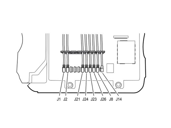

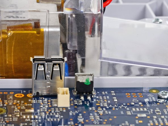

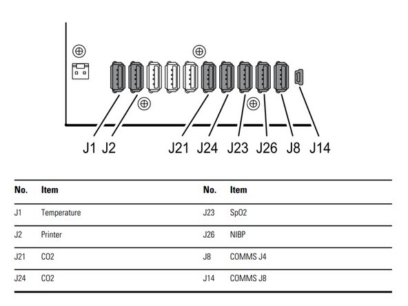

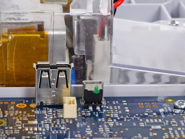

  24. Welch Allyn Connex Vital Signs Monitor 6000 Motherboard Replacement, Motherboard: crwdns2935265:024crwdnd2935265:01crwdnd2935265:03crwdne2935265:0 Welch Allyn Connex Vital Signs Monitor 6000 Motherboard Replacement, Motherboard: crwdns2935265:024crwdnd2935265:02crwdnd2935265:03crwdne2935265:0 Welch Allyn Connex Vital Signs Monitor 6000 Motherboard Replacement, Motherboard: crwdns2935265:024crwdnd2935265:03crwdnd2935265:03crwdne2935265:0
    • Remove all USB connectors from their ports on the motherboard.
    • Note the USB locations before removal for ease of reassembly. The locations of the USB as seen in the manual are shown in the third image. Your unit may differ depending on options.

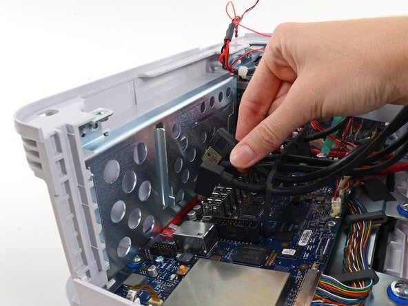

  25. Welch Allyn Connex Vital Signs Monitor 6000 Motherboard Replacement: crwdns2935265:025crwdnd2935265:01crwdnd2935265:02crwdne2935265:0 Welch Allyn Connex Vital Signs Monitor 6000 Motherboard Replacement: crwdns2935265:025crwdnd2935265:02crwdnd2935265:02crwdne2935265:0
    • Fold the USB cable bundle out of the way.
    • When reassembling, position each cable to extend approximately 1.5 inches past the separator as shown.

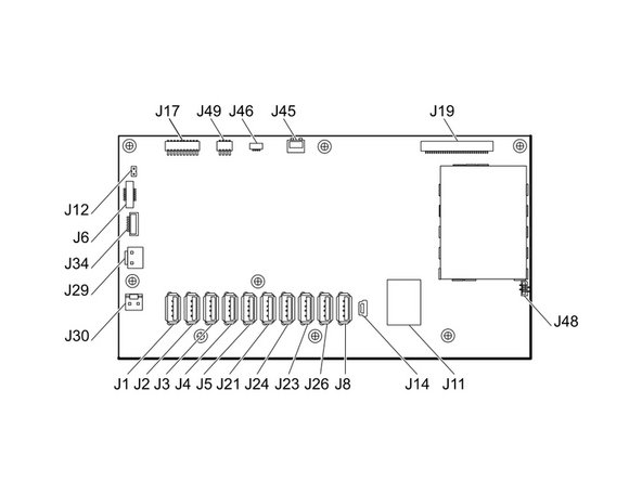

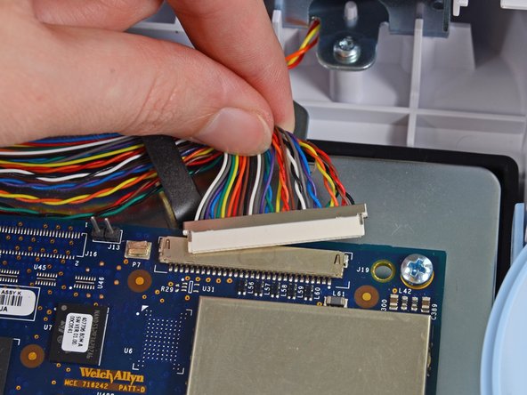

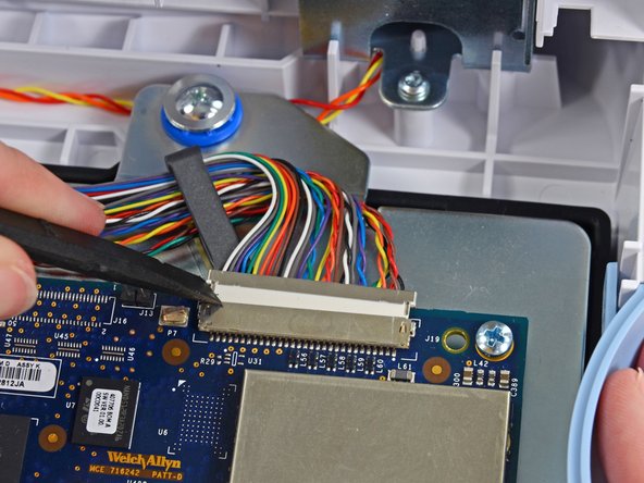

  26. Welch Allyn Connex Vital Signs Monitor 6000 Motherboard Replacement: crwdns2935265:026crwdnd2935265:01crwdnd2935265:03crwdne2935265:0 Welch Allyn Connex Vital Signs Monitor 6000 Motherboard Replacement: crwdns2935265:026crwdnd2935265:02crwdnd2935265:03crwdne2935265:0 Welch Allyn Connex Vital Signs Monitor 6000 Motherboard Replacement: crwdns2935265:026crwdnd2935265:03crwdnd2935265:03crwdne2935265:0
    • Use the flat end of a spudger to "walk" the LCD cable connector (labeled J19 in the service manual) out of its socket.
    • Press first on one side of the connector, then the other to push it free. Be sure to press the connector itself, not the socket on the motherboard.
    • Pull the cable straight out of its socket.
  27. Welch Allyn Connex Vital Signs Monitor 6000 Motherboard Replacement: crwdns2935265:027crwdnd2935265:01crwdnd2935265:03crwdne2935265:0 Welch Allyn Connex Vital Signs Monitor 6000 Motherboard Replacement: crwdns2935265:027crwdnd2935265:02crwdnd2935265:03crwdne2935265:0 Welch Allyn Connex Vital Signs Monitor 6000 Motherboard Replacement: crwdns2935265:027crwdnd2935265:03crwdnd2935265:03crwdne2935265:0
    • Pinch the fan cable connector (labeled J45 in the service manual) and pull straight up to remove it from its socket.
    • Be sure to pull only on the connector itself, not the socket on the motherboard.
  28. Welch Allyn Connex Vital Signs Monitor 6000 Motherboard Replacement: crwdns2935265:028crwdnd2935265:01crwdnd2935265:03crwdne2935265:0 Welch Allyn Connex Vital Signs Monitor 6000 Motherboard Replacement: crwdns2935265:028crwdnd2935265:02crwdnd2935265:03crwdne2935265:0 Welch Allyn Connex Vital Signs Monitor 6000 Motherboard Replacement: crwdns2935265:028crwdnd2935265:03crwdnd2935265:03crwdne2935265:0

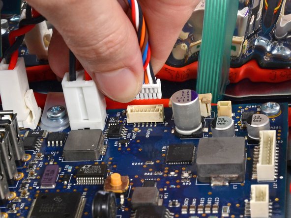

    • Pull the light bar cable connector (labeled J46 in the service manual) straight up out of its socket.
  29. Welch Allyn Connex Vital Signs Monitor 6000 Motherboard Replacement: crwdns2935265:029crwdnd2935265:01crwdnd2935265:03crwdne2935265:0 Welch Allyn Connex Vital Signs Monitor 6000 Motherboard Replacement: crwdns2935265:029crwdnd2935265:02crwdnd2935265:03crwdne2935265:0 Welch Allyn Connex Vital Signs Monitor 6000 Motherboard Replacement: crwdns2935265:029crwdnd2935265:03crwdnd2935265:03crwdne2935265:0
    • Remove the communications board cable connector from its socket (labeled J49 in the service manual).
    • If you have a printer unit in your model, remove the printer power cable at this time, it is labeled J17 in the service manual.
  30. Welch Allyn Connex Vital Signs Monitor 6000 Motherboard Replacement: crwdns2935265:030crwdnd2935265:01crwdnd2935265:03crwdne2935265:0 Welch Allyn Connex Vital Signs Monitor 6000 Motherboard Replacement: crwdns2935265:030crwdnd2935265:02crwdnd2935265:03crwdne2935265:0 Welch Allyn Connex Vital Signs Monitor 6000 Motherboard Replacement: crwdns2935265:030crwdnd2935265:03crwdnd2935265:03crwdne2935265:0
    • Carefully remove the speaker cable connector (labeled J12 in the service manual) from the motherboard.

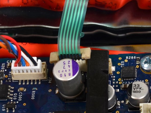

  31. Welch Allyn Connex Vital Signs Monitor 6000 Motherboard Replacement: crwdns2935265:031crwdnd2935265:01crwdnd2935265:03crwdne2935265:0 Welch Allyn Connex Vital Signs Monitor 6000 Motherboard Replacement: crwdns2935265:031crwdnd2935265:02crwdnd2935265:03crwdne2935265:0 Welch Allyn Connex Vital Signs Monitor 6000 Motherboard Replacement: crwdns2935265:031crwdnd2935265:03crwdnd2935265:03crwdne2935265:0
    • Lift the ZIF collar securing the power button cable (labeled J6 in the service manual) with the flat end of a spudger to loosen its grip.
    • Pull the power button cable straight up from its socket.

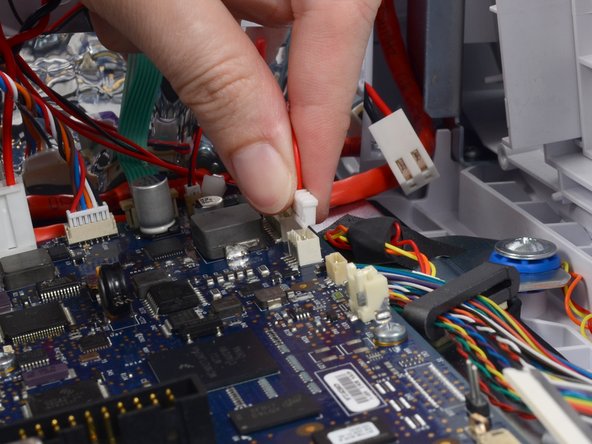

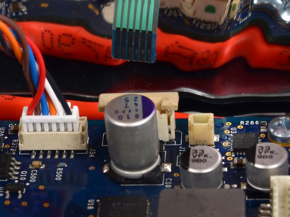

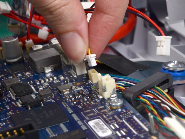

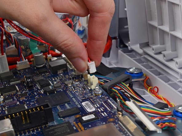

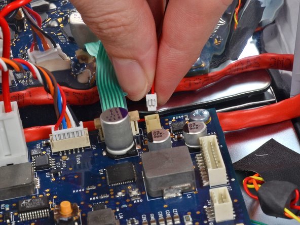

  32. Welch Allyn Connex Vital Signs Monitor 6000 Motherboard Replacement: crwdns2935265:032crwdnd2935265:01crwdnd2935265:03crwdne2935265:0 Welch Allyn Connex Vital Signs Monitor 6000 Motherboard Replacement: crwdns2935265:032crwdnd2935265:02crwdnd2935265:03crwdne2935265:0 Welch Allyn Connex Vital Signs Monitor 6000 Motherboard Replacement: crwdns2935265:032crwdnd2935265:03crwdnd2935265:03crwdne2935265:0
    • Remove the smart-battery cable connector from its socket (labeled J34 in the service manual).

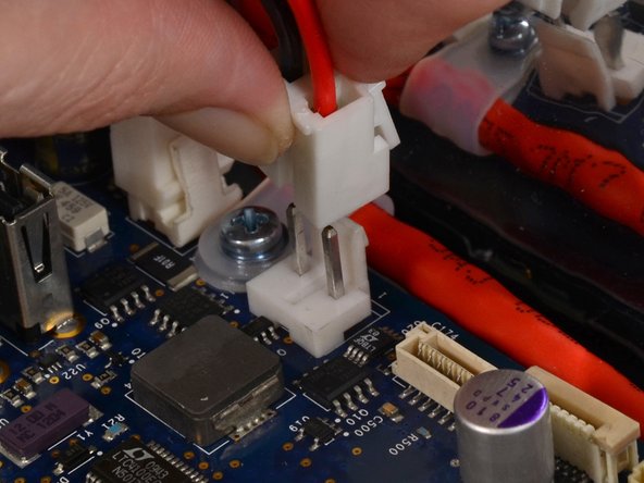

  33. Welch Allyn Connex Vital Signs Monitor 6000 Motherboard Replacement: crwdns2935265:033crwdnd2935265:01crwdnd2935265:03crwdne2935265:0 Welch Allyn Connex Vital Signs Monitor 6000 Motherboard Replacement: crwdns2935265:033crwdnd2935265:02crwdnd2935265:03crwdne2935265:0 Welch Allyn Connex Vital Signs Monitor 6000 Motherboard Replacement: crwdns2935265:033crwdnd2935265:03crwdnd2935265:03crwdne2935265:0
    • Pinch the battery power connector and lift straight up to unclip it from its socket on the motherboard (labeled J29 in the service manual).

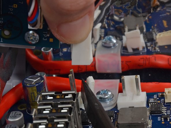

  34. Welch Allyn Connex Vital Signs Monitor 6000 Motherboard Replacement: crwdns2935265:034crwdnd2935265:01crwdnd2935265:02crwdne2935265:0 Welch Allyn Connex Vital Signs Monitor 6000 Motherboard Replacement: crwdns2935265:034crwdnd2935265:02crwdnd2935265:02crwdne2935265:0
    • Use the flat end of a spudger to separate the battery supply cable connector bracket from the socket (labeled J30 in the service manual).
    • Pull the battery supply cable connector straight up from the board.

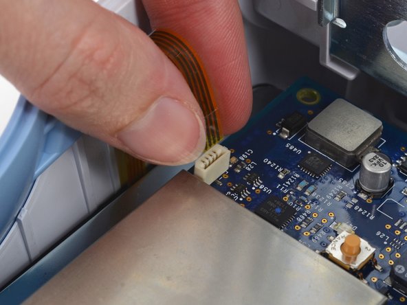

  35. Welch Allyn Connex Vital Signs Monitor 6000 Motherboard Replacement: crwdns2935265:035crwdnd2935265:01crwdnd2935265:02crwdne2935265:0 Welch Allyn Connex Vital Signs Monitor 6000 Motherboard Replacement: crwdns2935265:035crwdnd2935265:02crwdnd2935265:02crwdne2935265:0
    • Carefully pull the LCD flex cable straight up from its socket in the motherboard (labeled J48 in the service manual).
  36. Welch Allyn Connex Vital Signs Monitor 6000 Motherboard Replacement: crwdns2935265:036crwdnd2935265:01crwdnd2935265:02crwdne2935265:0 Welch Allyn Connex Vital Signs Monitor 6000 Motherboard Replacement: crwdns2935265:036crwdnd2935265:02crwdnd2935265:02crwdne2935265:0

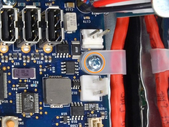

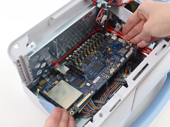

    • Remove the eight Phillips #1 screws from the motherboard.
    • The screw securing the ethernet cable bracket has a washer between it and the bracket. Take care not to lose it.

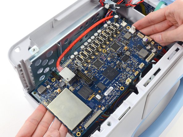

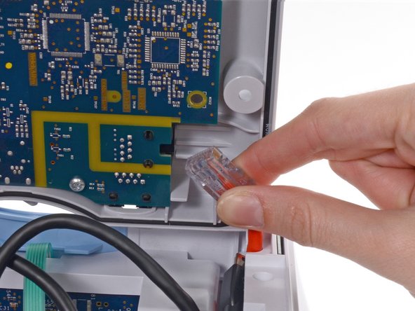

  37. Welch Allyn Connex Vital Signs Monitor 6000 Motherboard Replacement: crwdns2935265:037crwdnd2935265:01crwdnd2935265:03crwdne2935265:0 Welch Allyn Connex Vital Signs Monitor 6000 Motherboard Replacement: crwdns2935265:037crwdnd2935265:02crwdnd2935265:03crwdne2935265:0 Welch Allyn Connex Vital Signs Monitor 6000 Motherboard Replacement: crwdns2935265:037crwdnd2935265:03crwdnd2935265:03crwdne2935265:0
    • Lift the motherboard from the light-bar side and pull it toward the edge of the case to free the ethernet cable connector from under the case.
    • Lift the motherboard out of the case to gain access to the ethernet cable connector.
    • Do not attempt to remove the board entirely as it is still connected to the monitor.
  38. Welch Allyn Connex Vital Signs Monitor 6000 Motherboard Replacement: crwdns2935265:038crwdnd2935265:01crwdnd2935265:02crwdne2935265:0 Welch Allyn Connex Vital Signs Monitor 6000 Motherboard Replacement: crwdns2935265:038crwdnd2935265:02crwdnd2935265:02crwdne2935265:0
    • Remove the ethernet cable connector (labeled J11 in the service manual) from the mother board.
