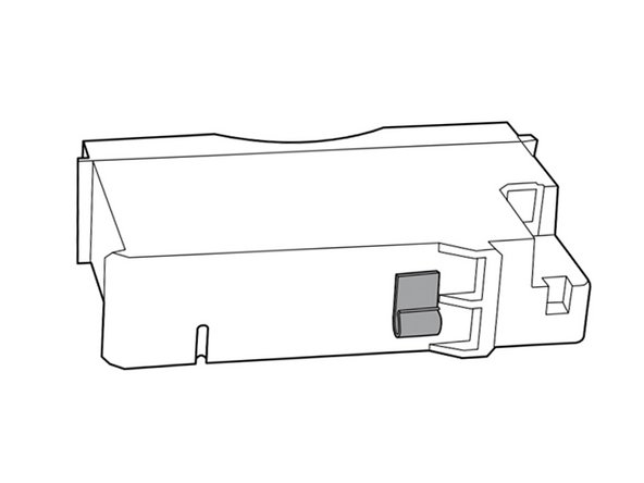

  5. Welch Allyn Connex Vital Signs Monitor 6000 Module Replacement: crwdns2935265:05crwdnd2935265:01crwdnd2935265:03crwdne2935265:0 Welch Allyn Connex Vital Signs Monitor 6000 Module Replacement: crwdns2935265:05crwdnd2935265:02crwdnd2935265:03crwdne2935265:0 Welch Allyn Connex Vital Signs Monitor 6000 Module Replacement: crwdns2935265:05crwdnd2935265:03crwdnd2935265:03crwdne2935265:0
    • Remove the cover of the temperature module by pressing the tab and sliding the cover to the right.
  6. Welch Allyn Connex Vital Signs Monitor 6000 Module Replacement: crwdns2935265:06crwdnd2935265:01crwdnd2935265:03crwdne2935265:0 Welch Allyn Connex Vital Signs Monitor 6000 Module Replacement: crwdns2935265:06crwdnd2935265:02crwdnd2935265:03crwdne2935265:0 Welch Allyn Connex Vital Signs Monitor 6000 Module Replacement: crwdns2935265:06crwdnd2935265:03crwdnd2935265:03crwdne2935265:0
    • Depress the spring tab on the temperature probe cable connector and withdraw it from the probe port.

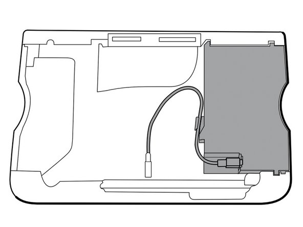

  11. Welch Allyn Connex Vital Signs Monitor 6000 Module Replacement, Battery: crwdns2935265:011crwdnd2935265:01crwdnd2935265:03crwdne2935265:0 Welch Allyn Connex Vital Signs Monitor 6000 Module Replacement, Battery: crwdns2935265:011crwdnd2935265:02crwdnd2935265:03crwdne2935265:0 Welch Allyn Connex Vital Signs Monitor 6000 Module Replacement, Battery: crwdns2935265:011crwdnd2935265:03crwdnd2935265:03crwdne2935265:0
    • Place the monitor upside down on a clean surface.
    • Insert a coin into the slot and push to open.
    • Choose a coin that fits comfortably into the slot.
    • Remove the battery cover.
  12. Welch Allyn Connex Vital Signs Monitor 6000 Module Replacement: crwdns2935265:012crwdnd2935265:01crwdnd2935265:03crwdne2935265:0 Welch Allyn Connex Vital Signs Monitor 6000 Module Replacement: crwdns2935265:012crwdnd2935265:02crwdnd2935265:03crwdne2935265:0 Welch Allyn Connex Vital Signs Monitor 6000 Module Replacement: crwdns2935265:012crwdnd2935265:03crwdnd2935265:03crwdne2935265:0
    • Use the plastic label to remove the battery from its recess.

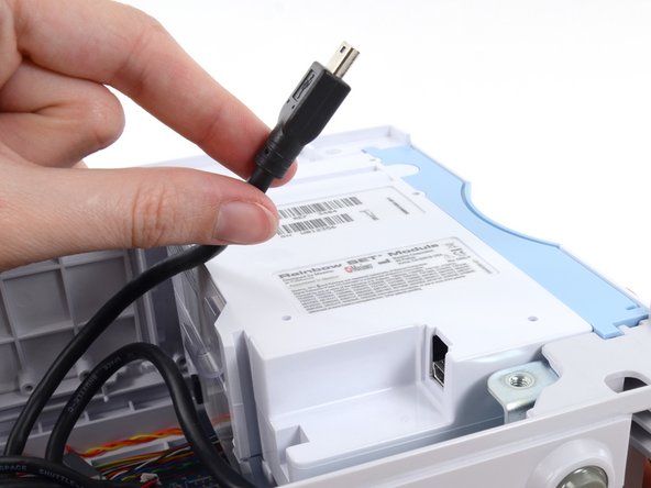

  24. Welch Allyn Connex Vital Signs Monitor 6000 Module Replacement, Module: crwdns2935265:024crwdnd2935265:01crwdnd2935265:03crwdne2935265:0 Welch Allyn Connex Vital Signs Monitor 6000 Module Replacement, Module: crwdns2935265:024crwdnd2935265:02crwdnd2935265:03crwdne2935265:0 Welch Allyn Connex Vital Signs Monitor 6000 Module Replacement, Module: crwdns2935265:024crwdnd2935265:03crwdnd2935265:03crwdne2935265:0
    • Disconnect the USB cable from the module.
    • For the extended chassis: Disconnect the two USB cables from the module.

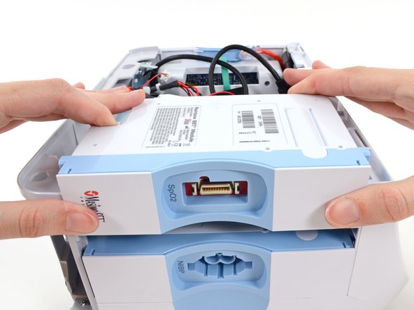

  25. Welch Allyn Connex Vital Signs Monitor 6000 Module Replacement: crwdns2935265:025crwdnd2935265:01crwdnd2935265:03crwdne2935265:0 Welch Allyn Connex Vital Signs Monitor 6000 Module Replacement: crwdns2935265:025crwdnd2935265:02crwdnd2935265:03crwdne2935265:0 Welch Allyn Connex Vital Signs Monitor 6000 Module Replacement: crwdns2935265:025crwdnd2935265:03crwdnd2935265:03crwdne2935265:0
    • Remove the USB cable from the retaining clip on the module.
  26. Welch Allyn Connex Vital Signs Monitor 6000 Module Replacement: crwdns2935265:026crwdnd2935265:01crwdnd2935265:03crwdne2935265:0 Welch Allyn Connex Vital Signs Monitor 6000 Module Replacement: crwdns2935265:026crwdnd2935265:02crwdnd2935265:03crwdne2935265:0 Welch Allyn Connex Vital Signs Monitor 6000 Module Replacement: crwdns2935265:026crwdnd2935265:03crwdnd2935265:03crwdne2935265:0
    • Slide the module out of the case.
    • Repeat the above procedure to remove any additional modules from the chassis.
    • During reassembly, install the module closest to the display first.
    • Reinsert modules into the housing with the serial number label facing up.
