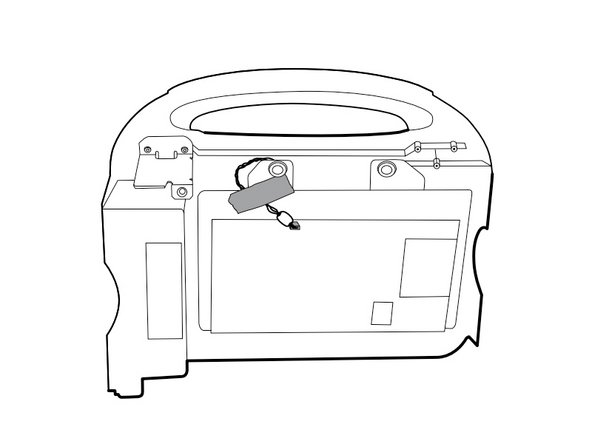

  11. Welch Allyn Connex Vital Signs Monitor 6000 LCD Replacement, Battery: crwdns2935265:011crwdnd2935265:01crwdnd2935265:03crwdne2935265:0 Welch Allyn Connex Vital Signs Monitor 6000 LCD Replacement, Battery: crwdns2935265:011crwdnd2935265:02crwdnd2935265:03crwdne2935265:0 Welch Allyn Connex Vital Signs Monitor 6000 LCD Replacement, Battery: crwdns2935265:011crwdnd2935265:03crwdnd2935265:03crwdne2935265:0
    • Place the monitor upside down on a clean surface.
    • Insert a coin into the slot and push to open.
    • Choose a coin that fits comfortably into the slot.
    • Remove the battery cover.
  12. Welch Allyn Connex Vital Signs Monitor 6000 LCD Replacement: crwdns2935265:012crwdnd2935265:01crwdnd2935265:03crwdne2935265:0 Welch Allyn Connex Vital Signs Monitor 6000 LCD Replacement: crwdns2935265:012crwdnd2935265:02crwdnd2935265:03crwdne2935265:0 Welch Allyn Connex Vital Signs Monitor 6000 LCD Replacement: crwdns2935265:012crwdnd2935265:03crwdnd2935265:03crwdne2935265:0
    • Use the plastic label to remove the battery from its recess.

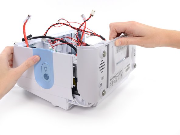

  13. Welch Allyn Connex Vital Signs Monitor 6000 LCD Replacement, Rear Housing: crwdns2935265:013crwdnd2935265:01crwdnd2935265:02crwdne2935265:0 Welch Allyn Connex Vital Signs Monitor 6000 LCD Replacement, Rear Housing: crwdns2935265:013crwdnd2935265:02crwdnd2935265:02crwdne2935265:0
    • Open the communications door to access the lower left-hand rear housing screw.
    • Remove the four Phillips #2 screws (labeled 14 in the service manual) from the rear housing.
  14. Welch Allyn Connex Vital Signs Monitor 6000 LCD Replacement: crwdns2935265:014crwdnd2935265:01crwdnd2935265:02crwdne2935265:0 Welch Allyn Connex Vital Signs Monitor 6000 LCD Replacement: crwdns2935265:014crwdnd2935265:02crwdnd2935265:02crwdne2935265:0
    • With the handle/alert bar facing you, begin to lift the rear housing from the left side, holding the right side securely.
    • Do not attempt to separate the rear housing from the monitor, it is still attached with several cables.
  15. Welch Allyn Connex Vital Signs Monitor 6000 LCD Replacement: crwdns2935265:015crwdnd2935265:01crwdnd2935265:01crwdne2935265:0

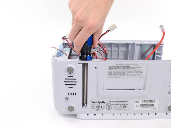

  39. Welch Allyn Connex Vital Signs Monitor 6000 LCD Replacement, LCD: crwdns2935265:039crwdnd2935265:01crwdnd2935265:02crwdne2935265:0 Welch Allyn Connex Vital Signs Monitor 6000 LCD Replacement, LCD: crwdns2935265:039crwdnd2935265:02crwdnd2935265:02crwdne2935265:0
    • Remove the two Phillips #2 side housing screws from the bottom housing.
    • There are holes above the screws into which you may insert a standard size screwdriver to unscrew them.
  40. Welch Allyn Connex Vital Signs Monitor 6000 LCD Replacement: crwdns2935265:040crwdnd2935265:01crwdnd2935265:01crwdne2935265:0
    • Remove the single Phillips #2 screw from the bottom housing near the speaker grille.

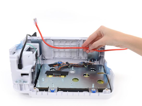

    • Remove the ethernet cable, or simply tuck it out of the way.

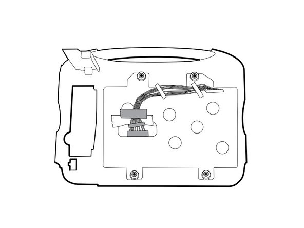

  43. Welch Allyn Connex Vital Signs Monitor 6000 LCD Replacement: crwdns2935265:043crwdnd2935265:01crwdnd2935265:03crwdne2935265:0 Welch Allyn Connex Vital Signs Monitor 6000 LCD Replacement: crwdns2935265:043crwdnd2935265:02crwdnd2935265:03crwdne2935265:0 Welch Allyn Connex Vital Signs Monitor 6000 LCD Replacement: crwdns2935265:043crwdnd2935265:03crwdnd2935265:03crwdne2935265:0

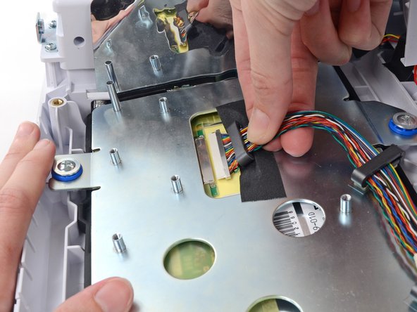

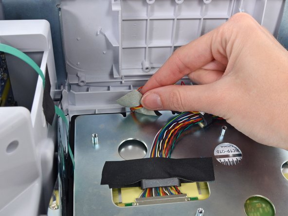

    • Remove the light-bar cable from the LCD bracket and move it out of the way.
    • During reassembly, refer to the third image for tape and cable replacement.

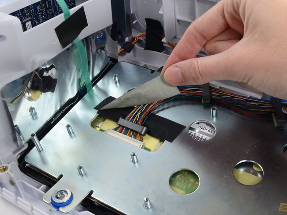

  44. Welch Allyn Connex Vital Signs Monitor 6000 LCD Replacement: crwdns2935265:044crwdnd2935265:01crwdnd2935265:03crwdne2935265:0 Welch Allyn Connex Vital Signs Monitor 6000 LCD Replacement: crwdns2935265:044crwdnd2935265:02crwdnd2935265:03crwdne2935265:0 Welch Allyn Connex Vital Signs Monitor 6000 LCD Replacement: crwdns2935265:044crwdnd2935265:03crwdnd2935265:03crwdne2935265:0
    • Remove any tape from the LCD cable connector.
    • For reassembly, refer to the third image for tape and cable replacement.
  45. Welch Allyn Connex Vital Signs Monitor 6000 LCD Replacement: crwdns2935265:045crwdnd2935265:01crwdnd2935265:02crwdne2935265:0 Welch Allyn Connex Vital Signs Monitor 6000 LCD Replacement: crwdns2935265:045crwdnd2935265:02crwdnd2935265:02crwdne2935265:0
    • Pull the LCD cable connector, firmly and evenly, straight out of its socket.

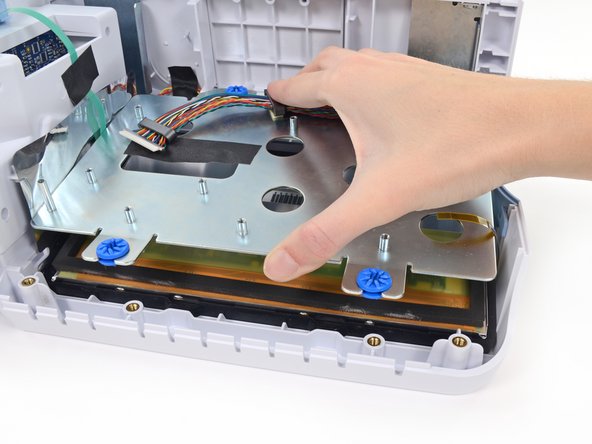

    • Remove the four Phillips #2 screws from the LCD bracket.
  47. Welch Allyn Connex Vital Signs Monitor 6000 LCD Replacement: crwdns2935265:047crwdnd2935265:01crwdnd2935265:02crwdne2935265:0 Welch Allyn Connex Vital Signs Monitor 6000 LCD Replacement: crwdns2935265:047crwdnd2935265:02crwdnd2935265:02crwdne2935265:0
    • Remove the LCD bracket.

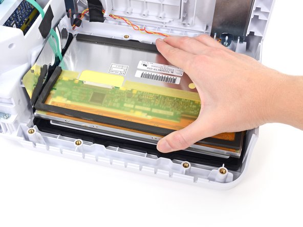

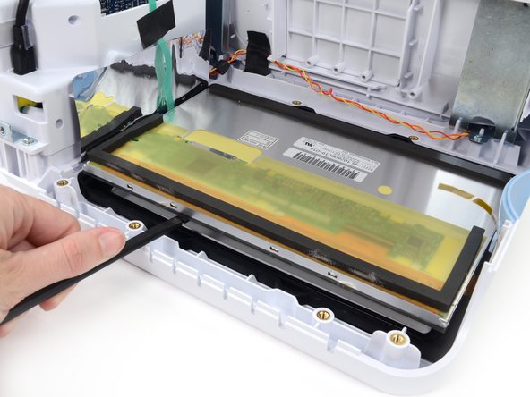

  48. Welch Allyn Connex Vital Signs Monitor 6000 LCD Replacement: crwdns2935265:048crwdnd2935265:01crwdnd2935265:02crwdne2935265:0 Welch Allyn Connex Vital Signs Monitor 6000 LCD Replacement: crwdns2935265:048crwdnd2935265:02crwdnd2935265:02crwdne2935265:0
    • Use the flat end of a spudger to lift the LCD out of the rubber gasket frame.
  49. Welch Allyn Connex Vital Signs Monitor 6000 LCD Replacement: crwdns2935265:049crwdnd2935265:01crwdnd2935265:02crwdne2935265:0 Welch Allyn Connex Vital Signs Monitor 6000 LCD Replacement: crwdns2935265:049crwdnd2935265:02crwdnd2935265:02crwdne2935265:0
    • Remove the LCD from the front housing.
