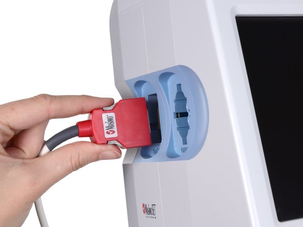

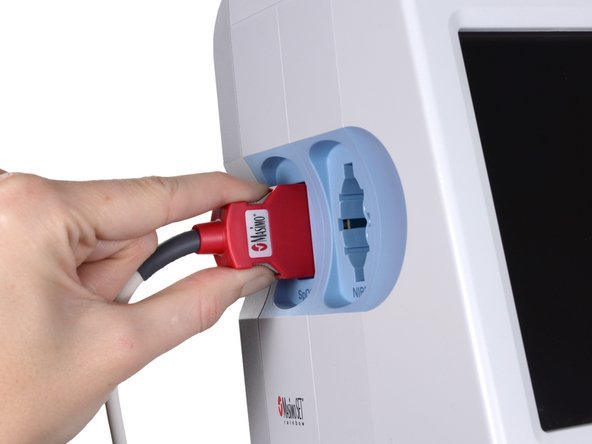

    • Place your thumb and forefinger on the Pulse oximetry (SpO2 or combined SpO2/SpHb) cable connector. Squeeze the side tabs until the connector releases.
    • Always grasp the cable by the connector. Do not pull on the cable itself.
    • Pull the connector away from the connector port.

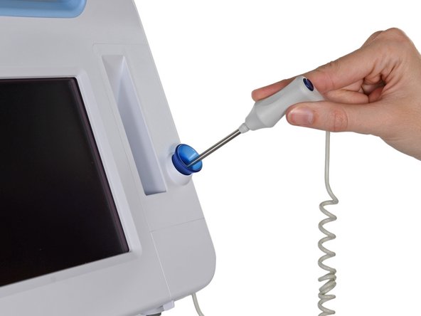

  4. Welch Allyn Connex Vital Signs Monitor 6000 Battery Replacement: crwdns2935265:04crwdnd2935265:01crwdnd2935265:02crwdne2935265:0 Welch Allyn Connex Vital Signs Monitor 6000 Battery Replacement: crwdns2935265:04crwdnd2935265:02crwdnd2935265:02crwdne2935265:0
    • Grasp the temperature probe and pull it up to remove it from the monitor.

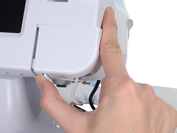

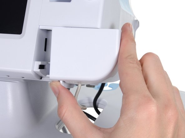

  5. Welch Allyn Connex Vital Signs Monitor 6000 Battery Replacement: crwdns2935265:05crwdnd2935265:01crwdnd2935265:03crwdne2935265:0 Welch Allyn Connex Vital Signs Monitor 6000 Battery Replacement: crwdns2935265:05crwdnd2935265:02crwdnd2935265:03crwdne2935265:0 Welch Allyn Connex Vital Signs Monitor 6000 Battery Replacement: crwdns2935265:05crwdnd2935265:03crwdnd2935265:03crwdne2935265:0
    • Remove the cover of the temperature module by pressing the tab and sliding the cover to the right.
  6. Welch Allyn Connex Vital Signs Monitor 6000 Battery Replacement: crwdns2935265:06crwdnd2935265:01crwdnd2935265:03crwdne2935265:0 Welch Allyn Connex Vital Signs Monitor 6000 Battery Replacement: crwdns2935265:06crwdnd2935265:02crwdnd2935265:03crwdne2935265:0 Welch Allyn Connex Vital Signs Monitor 6000 Battery Replacement: crwdns2935265:06crwdnd2935265:03crwdnd2935265:03crwdne2935265:0
    • Depress the spring tab on the temperature probe cable connector and withdraw it from the probe port.

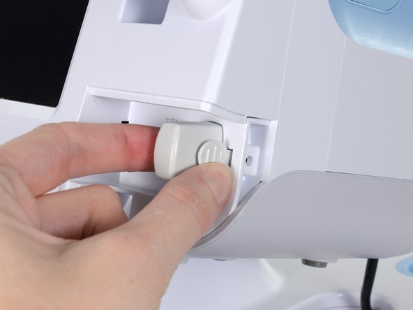

    • Remove the flathead screw on the USB networking door.
    • Loosen the captive Phillips #2 screw securing the monitor to the stand.
  8. Welch Allyn Connex Vital Signs Monitor 6000 Battery Replacement: crwdns2935265:08crwdnd2935265:01crwdnd2935265:01crwdne2935265:0
    • Holding the monitor securely, open the USB networking door.
    • You may have to lift the monitor slightly to allow the door to swing out from the stand mount.

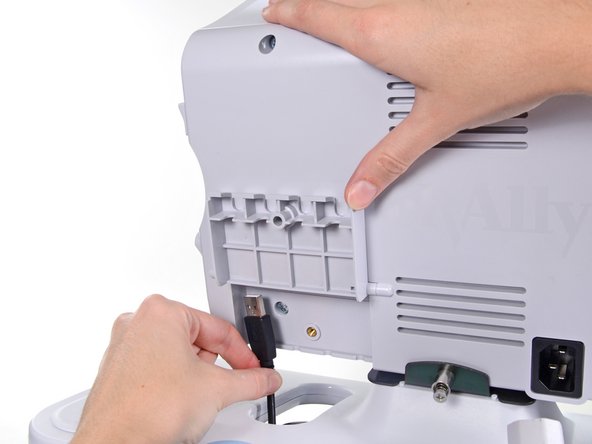

  9. Welch Allyn Connex Vital Signs Monitor 6000 Battery Replacement: crwdns2935265:09crwdnd2935265:01crwdnd2935265:02crwdne2935265:0 Welch Allyn Connex Vital Signs Monitor 6000 Battery Replacement: crwdns2935265:09crwdnd2935265:02crwdnd2935265:02crwdne2935265:0
    • Detach any accessory USB cables from USB ports on the monitor.

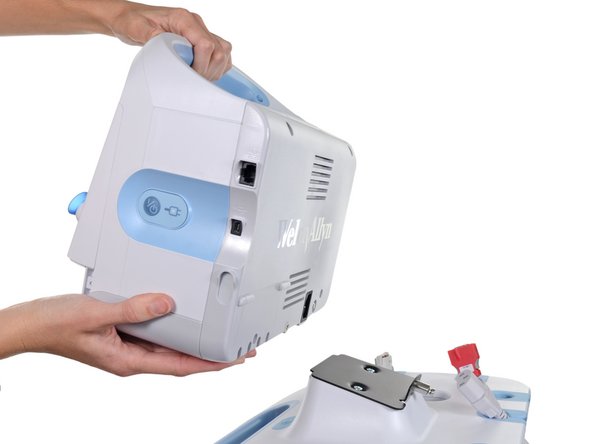

    • Slide the monitor off of the stand tray.

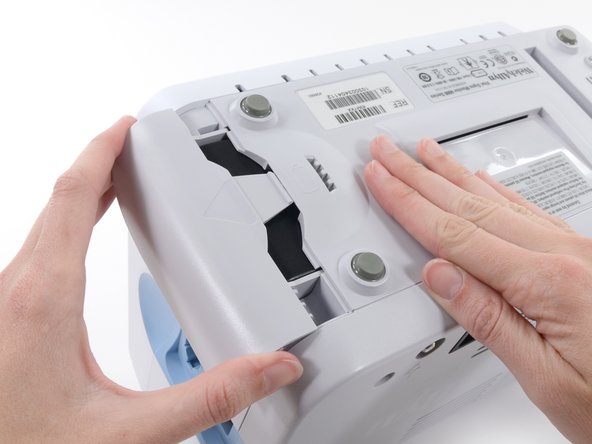

  11. Welch Allyn Connex Vital Signs Monitor 6000 Battery Replacement, Battery: crwdns2935265:011crwdnd2935265:01crwdnd2935265:03crwdne2935265:0 Welch Allyn Connex Vital Signs Monitor 6000 Battery Replacement, Battery: crwdns2935265:011crwdnd2935265:02crwdnd2935265:03crwdne2935265:0 Welch Allyn Connex Vital Signs Monitor 6000 Battery Replacement, Battery: crwdns2935265:011crwdnd2935265:03crwdnd2935265:03crwdne2935265:0

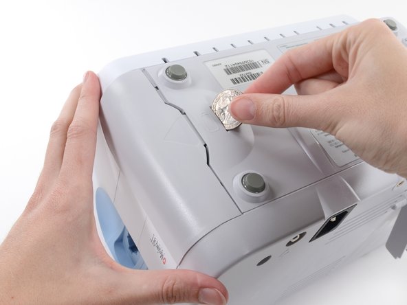

    • Place the monitor upside down on a clean surface.
    • Insert a coin into the slot and push to open.
    • Choose a coin that fits comfortably into the slot.
    • Remove the battery cover.

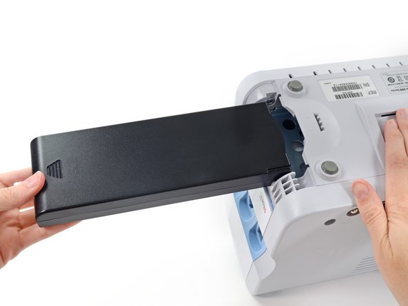

  12. Welch Allyn Connex Vital Signs Monitor 6000 Battery Replacement: crwdns2935265:012crwdnd2935265:01crwdnd2935265:03crwdne2935265:0 Welch Allyn Connex Vital Signs Monitor 6000 Battery Replacement: crwdns2935265:012crwdnd2935265:02crwdnd2935265:03crwdne2935265:0 Welch Allyn Connex Vital Signs Monitor 6000 Battery Replacement: crwdns2935265:012crwdnd2935265:03crwdnd2935265:03crwdne2935265:0

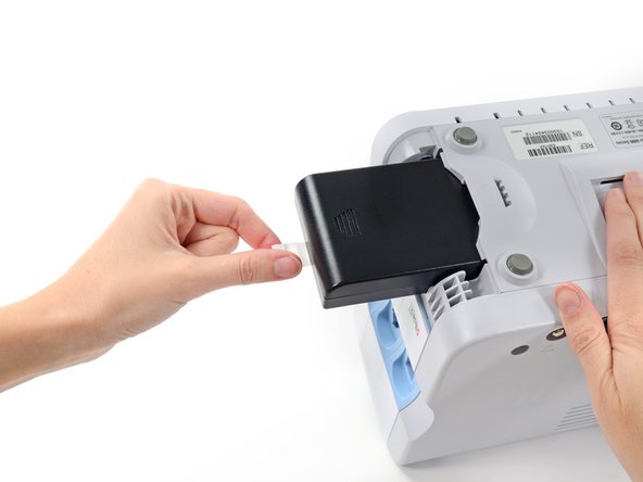

    • Use the plastic label to remove the battery from its recess.
