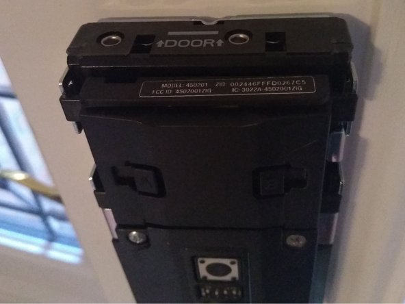

    • Find the battery pack (marked "DOOR" in between two arrows) at the top of the lock.
  5. Weiser Smartcode 10 Touchscreen Electronic Lock Battery Replacement: crwdns2935265:05crwdnd2935265:01crwdnd2935265:02crwdne2935265:0 Weiser Smartcode 10 Touchscreen Electronic Lock Battery Replacement: crwdns2935265:05crwdnd2935265:02crwdnd2935265:02crwdne2935265:0
    • Slide the battery pack upwards.
    • Turn the pack over to reveal the batteries.
    • Replace the four AA batteries.
  6. Weiser Smartcode 10 Touchscreen Electronic Lock Battery Replacement: crwdns2935265:06crwdnd2935265:01crwdnd2935265:01crwdne2935265:0
    • Reinsert the battery pack with the word "DOOR" facing you.
    • Wait until you see a green LED light flashing and/or hear two beeps to indicate working batteries.
    • If there is no green light, repeat steps 5 and 6. Check to see if the batteries are placed correctly or if newer batteries are required.

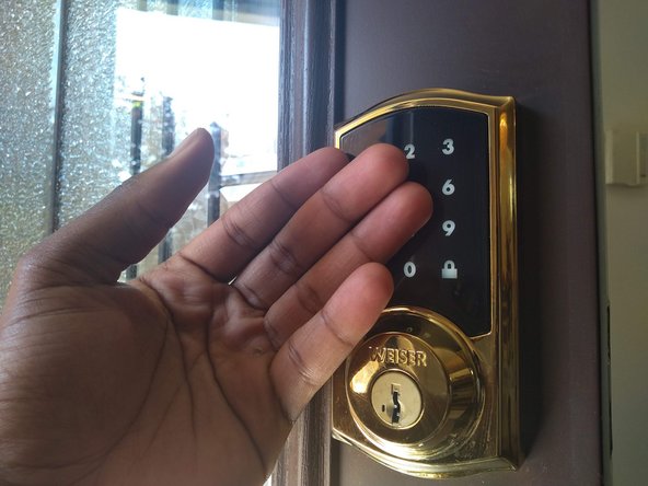

    • To confirm the finished repair, go to the front of the door and place the back of your hand on the touchscreen to activate the keypad.
Congratulations! Make sure to redo this process each year to ensure your device continues to work!
