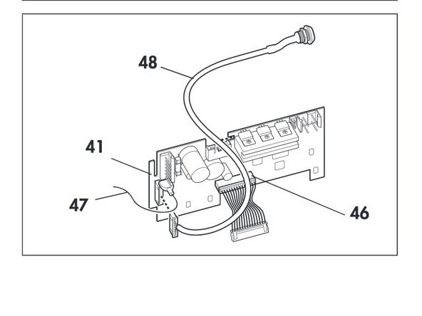

  6. Weinmann VENTImotion and VENTIlogic Power Board Replacement: crwdns2935265:08crwdnd2935265:01crwdnd2935265:01crwdne2935265:0
    • Disconnect the cables of the old power board and plug them into the appropriate slots of the new power board 41:
    • –power board/control board connecting cable (46)
    • –rechargeable battery connecting cable (48)
    • –earth cable (47)
  7. Weinmann VENTImotion and VENTIlogic Power Board Replacement: crwdns2935265:09crwdnd2935265:01crwdnd2935265:02crwdne2935265:0 Weinmann VENTImotion and VENTIlogic Power Board Replacement: crwdns2935265:09crwdnd2935265:02crwdnd2935265:02crwdne2935265:0
    • Connect the power board/mains supply unit connecting cable (45) to the new power board.
    • Position the new power board in the top part of the housing.
