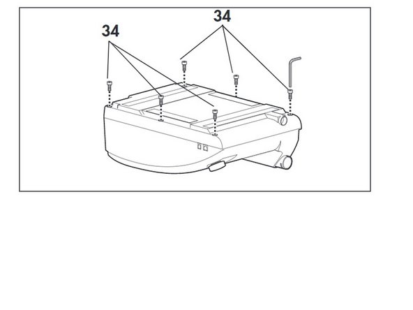

    • Open the device
    • 1.Place the device on a non-slip surface with the top facing downwards
    • 2.Remove the filter cassette from the top part of the housing.
    • 3.Undo and remove the 6 screws (34)
