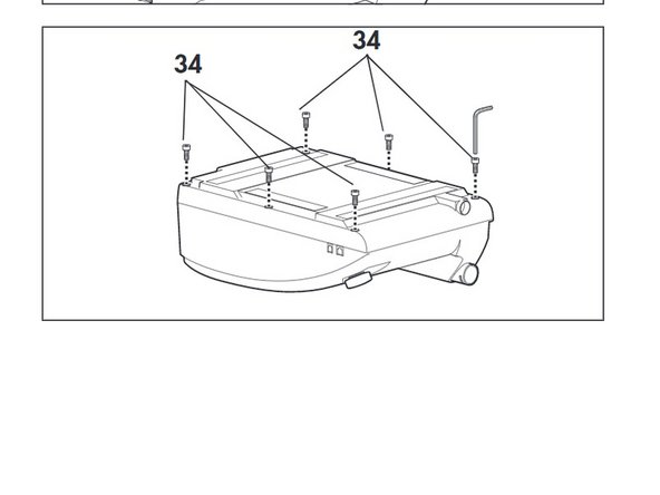

    • Open the device
    • 1) Place the device on a non-slip surface with the top facing downwards.
    • 2) Remove the filter cassette from the top part of the housing.
    • 3) Undo and remove the 6 screws (34)

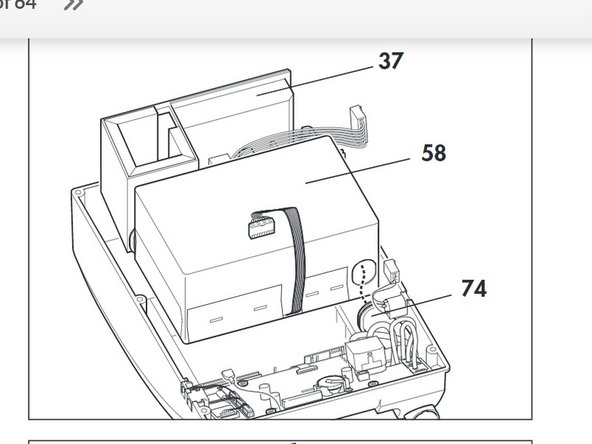

    • Refit the box and filter holder.
    • Connect the box and the filter holder to one another by reconnecting the intake side hose (73) from both parts.
    • Refit box (58) and filter holder (37) back on the top part of the housing together.
    • Connect the pressure-side hose (74) from the box.
