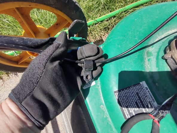

    • Disconnect the spark plug wire and tuck it away from the spark plug to avoid any accidental startups.
    • CAUTION: failure to disconnect the spark plug wire may lead to bodily injury and/or equipment damage.
  2. Weed Eater Rotary Lawn Mower Engine Control Cable Replacement: crwdns2935265:02crwdnd2935265:01crwdnd2935265:03crwdne2935265:0 Weed Eater Rotary Lawn Mower Engine Control Cable Replacement: crwdns2935265:02crwdnd2935265:02crwdnd2935265:03crwdne2935265:0 Weed Eater Rotary Lawn Mower Engine Control Cable Replacement: crwdns2935265:02crwdnd2935265:03crwdnd2935265:03crwdne2935265:0

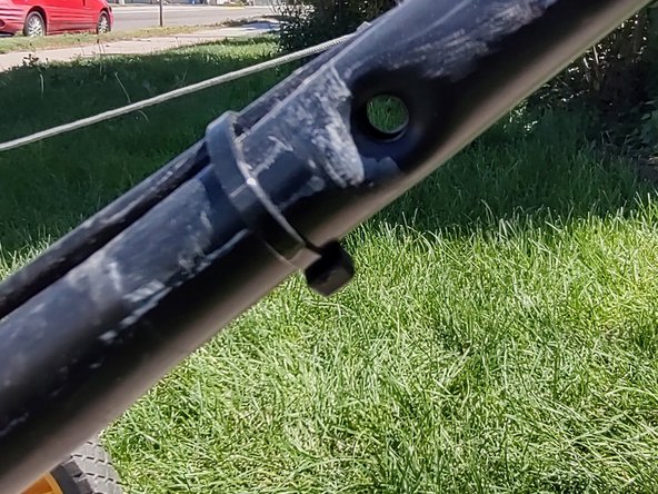

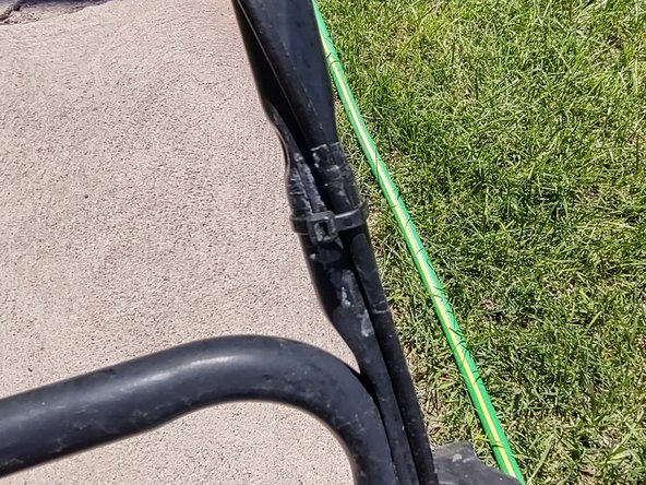

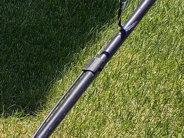

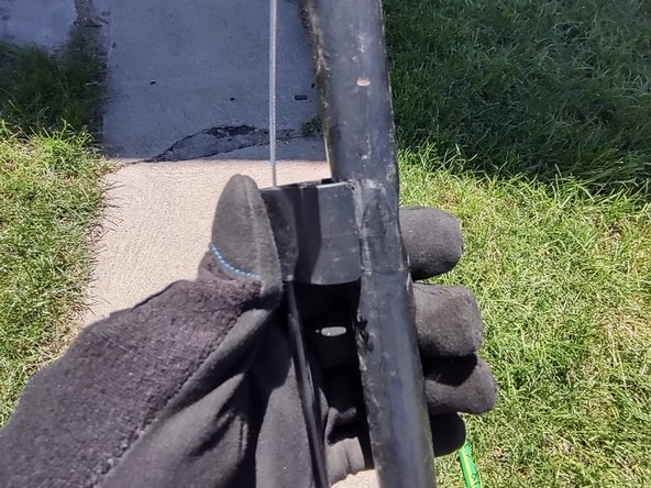

    • To remove the cable bracket from the handle, insert the flathead screwdriver into the bottom of the bracket and pry it off.

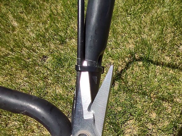

  3. Weed Eater Rotary Lawn Mower Engine Control Cable Replacement: crwdns2935265:03crwdnd2935265:01crwdnd2935265:03crwdne2935265:0 Weed Eater Rotary Lawn Mower Engine Control Cable Replacement: crwdns2935265:03crwdnd2935265:02crwdnd2935265:03crwdne2935265:0 Weed Eater Rotary Lawn Mower Engine Control Cable Replacement: crwdns2935265:03crwdnd2935265:03crwdnd2935265:03crwdne2935265:0

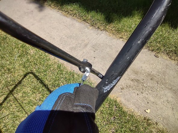

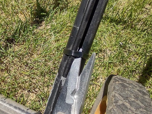

    • Use the utility shears to cut the zip ties which secure the cable to the upper and lower handles of the mower.

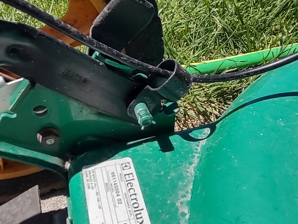

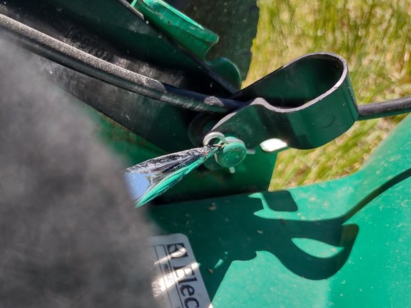

    • Use the needle nose pliers to remove the cotter pin holding the rear wheel cable clip in place.
    • Remove the clip from the retaining post.

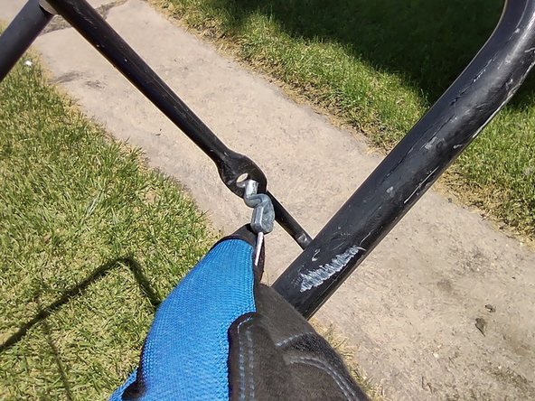

  5. Weed Eater Rotary Lawn Mower Engine Control Cable Replacement: crwdns2935265:05crwdnd2935265:01crwdnd2935265:03crwdne2935265:0 Weed Eater Rotary Lawn Mower Engine Control Cable Replacement: crwdns2935265:05crwdnd2935265:02crwdnd2935265:03crwdne2935265:0 Weed Eater Rotary Lawn Mower Engine Control Cable Replacement: crwdns2935265:05crwdnd2935265:03crwdnd2935265:03crwdne2935265:0

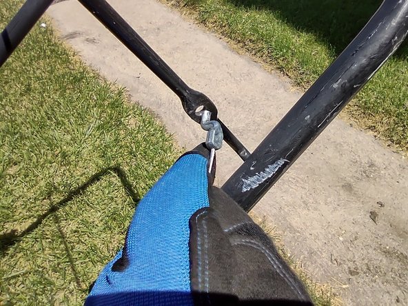

    • Disconnect the Z end of the cable from the control bar.
    • You may need to slightly pull the cable toward the control bar to get enough slack to remove the hook.

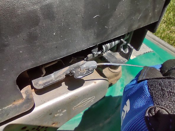

  6. Weed Eater Rotary Lawn Mower Engine Control Cable Replacement: crwdns2935265:06crwdnd2935265:01crwdnd2935265:03crwdne2935265:0 Weed Eater Rotary Lawn Mower Engine Control Cable Replacement: crwdns2935265:06crwdnd2935265:02crwdnd2935265:03crwdne2935265:0 Weed Eater Rotary Lawn Mower Engine Control Cable Replacement: crwdns2935265:06crwdnd2935265:03crwdnd2935265:03crwdne2935265:0

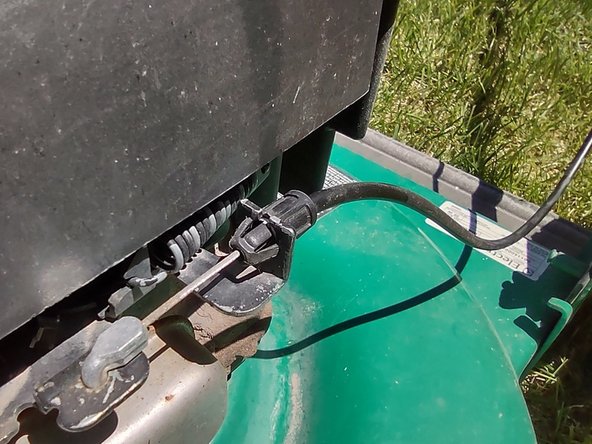

    • Use the needle nose pliers to squeeze the wings of the retaining clip together; push it through the hole in the brake assembly plate.
    • Remove the Z end of the cable from the brake assembly retaining plate.
  7. Weed Eater Rotary Lawn Mower Engine Control Cable Replacement: crwdns2935265:07crwdnd2935265:01crwdnd2935265:03crwdne2935265:0 Weed Eater Rotary Lawn Mower Engine Control Cable Replacement: crwdns2935265:07crwdnd2935265:02crwdnd2935265:03crwdne2935265:0 Weed Eater Rotary Lawn Mower Engine Control Cable Replacement: crwdns2935265:07crwdnd2935265:03crwdnd2935265:03crwdne2935265:0

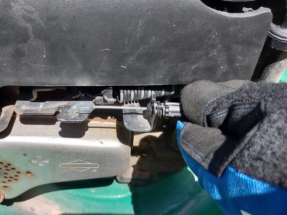

    • To install the new engine control cable:
    • Attach the Z end of the cable to the brake assembly retaining plate.
    • Push the plastic retaining clip through the hole in the brake assembly plate.

    • Attach the cable to the control bar by pushing the Z end of the cable into the hole.
