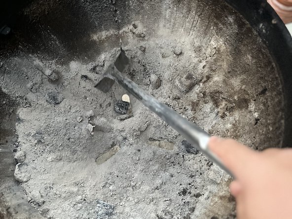

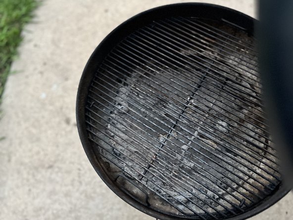

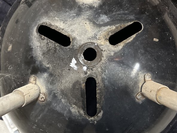

    • Start with your grill upright and remove any grates that are inside of the grill.
    • Use a charcoal rake or a small garden shovel to remove excess ash and residue in the grill.

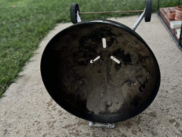

    • Turn the grill on its side and use a pressure washer or hose to clean the inside of it and any extra residue.
    • Caution: If using a pressure washer, make sure you handle with care. Improper use of the pressure washer could cause injury.

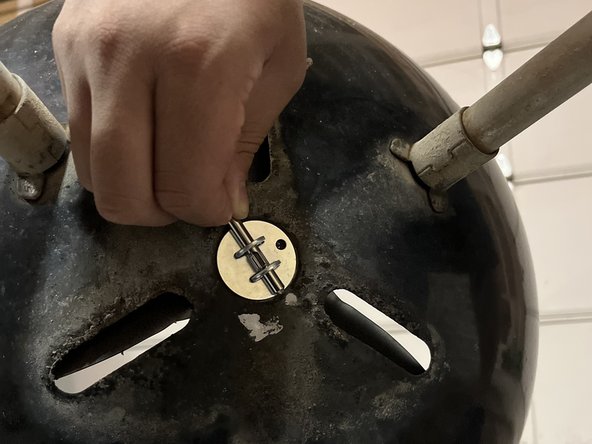

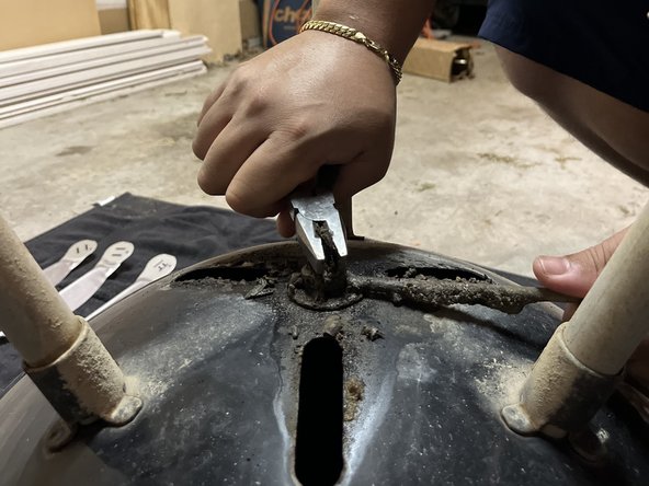

    • Lay the grill upside down on a flat surface.
    • Using a towel to lay your grill on will help to avoid damage to the grill or the flat surface.
    • Use a pair of pliers to remove the screw holding the old cleaning system in place. Once the screw is removed the assembly should come apart easily.
    • Turn the grill on its side.

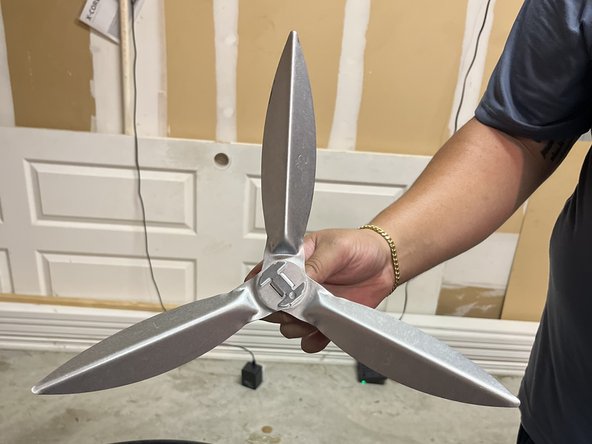

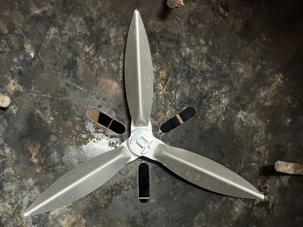

    • Lay the components of the new assembly on your towel next to your grill.
    • This will help you keep all parts of the assembly together.

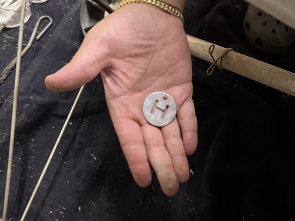

    • Once you've arranged all parts of your assembly, fit the top pieces of the assembly together. These will go inside of your grill.
    • The holding washer should be fitted to the assembly from the bottom of the grill.

    • With the grill still laying on its side, make sure the assembly fits properly and is able to turn.
    • Insert the pin/turning handle through the hole underneath the grill.
    • You will also need to lock the handle in place by turning it until it clicks.
    • Turn the grill right side up and assess the construction of your cleaning system assembly.
    • The blades should turn freely toward the bottom vent holes inside of the grill. This will allow ash and debris to be removed.
