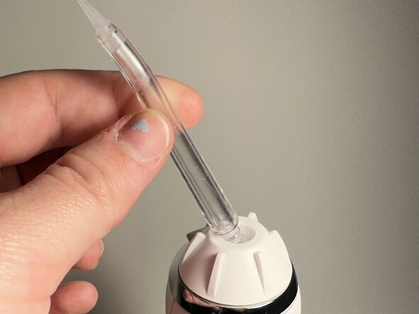

    • Depress the tip eject button and remove the tip.
    • Use an opening tool to pry off the tip rotator.
    • Avoid excessive force to prevent damaging the tip rotator.

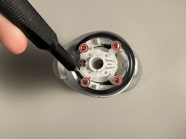

    • Remove the four Phillips screws beneath the tip rotator.
    • Remove the eject button assembly.
