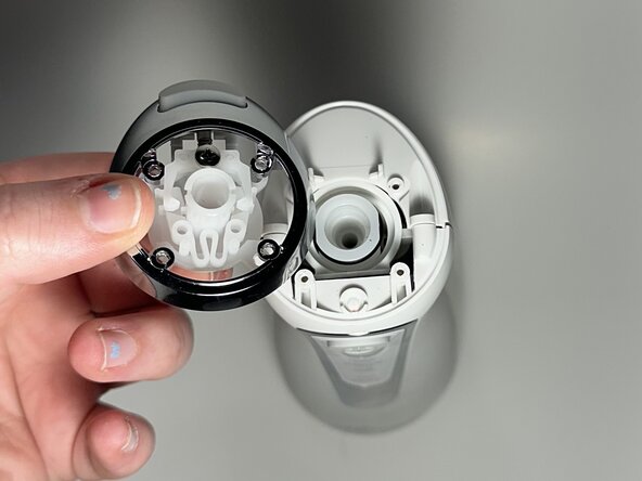

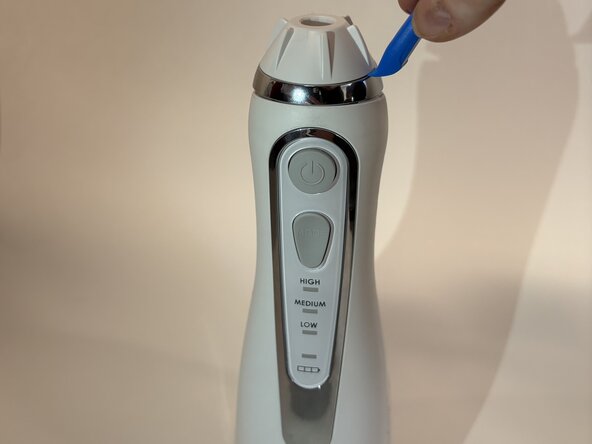

    • Depress the tip eject button and remove the tip.
    • Use an opening tool to pry off the tip rotator.
    • Avoid excessive force to prevent damaging the tip rotator.
  2. Waterpik Cordless Advanced 2.0 WP-580 Water Hose O-Ring Replacement: crwdns2935265:02crwdnd2935265:01crwdnd2935265:02crwdne2935265:0 Waterpik Cordless Advanced 2.0 WP-580 Water Hose O-Ring Replacement: crwdns2935265:02crwdnd2935265:02crwdnd2935265:02crwdne2935265:0
    • Remove the four Phillips screws beneath the tip rotator.
    • Remove the eject button assembly.
  3. Waterpik Cordless Advanced 2.0 WP-580 Water Hose O-Ring Replacement: crwdns2935265:03crwdnd2935265:01crwdnd2935265:03crwdne2935265:0 Waterpik Cordless Advanced 2.0 WP-580 Water Hose O-Ring Replacement: crwdns2935265:03crwdnd2935265:02crwdnd2935265:03crwdne2935265:0 Waterpik Cordless Advanced 2.0 WP-580 Water Hose O-Ring Replacement: crwdns2935265:03crwdnd2935265:03crwdnd2935265:03crwdne2935265:0

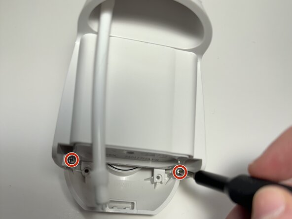

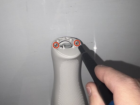

    • Use a Phillips #0 screwdriver to remove the two screws beneath the eject button assembly.

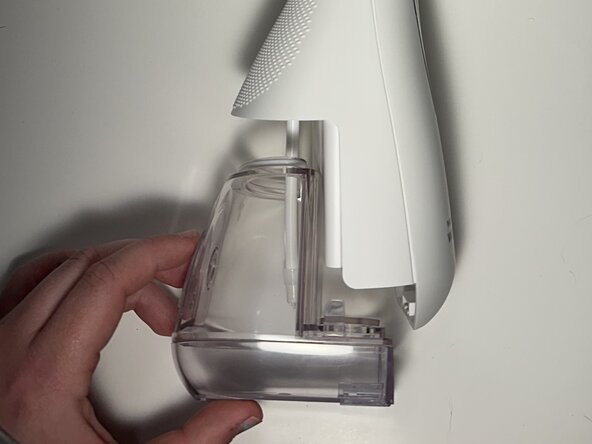

    • Remove the water reservoir and remove the two Phillips #0 screws toward the bottom of the device.

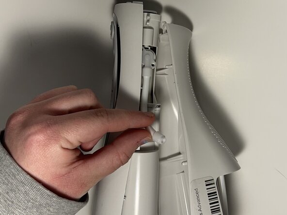

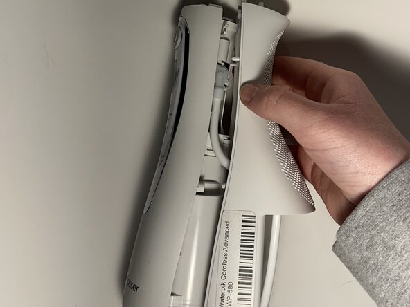

  4. Waterpik Cordless Advanced 2.0 WP-580 Water Hose O-Ring Replacement: crwdns2935265:04crwdnd2935265:01crwdnd2935265:03crwdne2935265:0 Waterpik Cordless Advanced 2.0 WP-580 Water Hose O-Ring Replacement: crwdns2935265:04crwdnd2935265:02crwdnd2935265:03crwdne2935265:0 Waterpik Cordless Advanced 2.0 WP-580 Water Hose O-Ring Replacement: crwdns2935265:04crwdnd2935265:03crwdnd2935265:03crwdne2935265:0

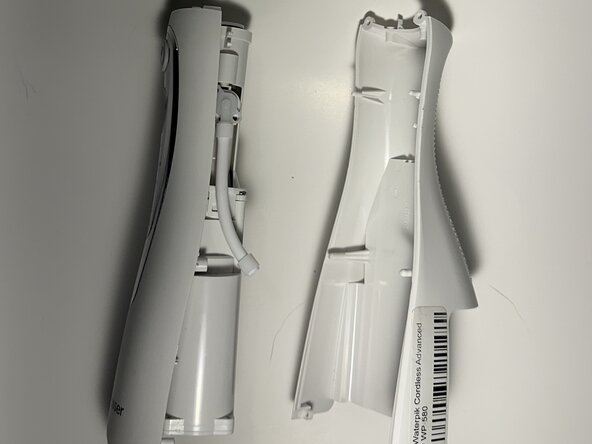

    • Insert the flat end of a spudger into the seam between the front and rear case and gently begin to pry the two halves of the case apart.
    • Disconnect the hose from the right side of the device and fully separate the two halves of the case apart.

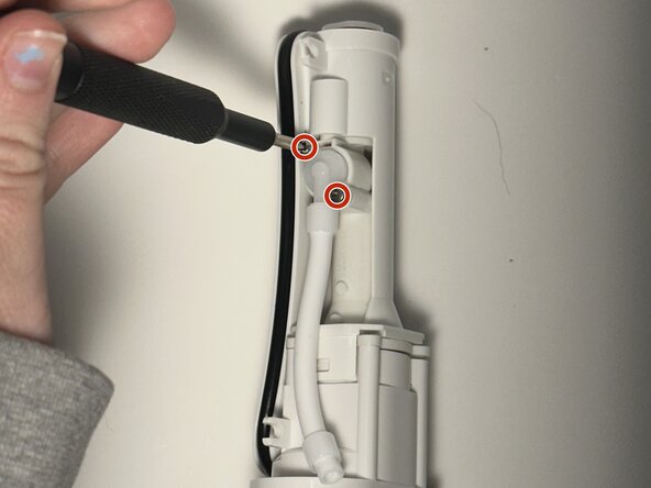

  5. Waterpik Cordless Advanced 2.0 WP-580 Water Hose O-Ring Replacement: crwdns2935265:05crwdnd2935265:01crwdnd2935265:02crwdne2935265:0 Waterpik Cordless Advanced 2.0 WP-580 Water Hose O-Ring Replacement: crwdns2935265:05crwdnd2935265:02crwdnd2935265:02crwdne2935265:0
    • Use a Phillips #0 screwdriver to remove the two screws securing the hose outtake.
    • Remove the hose.

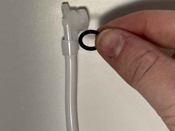

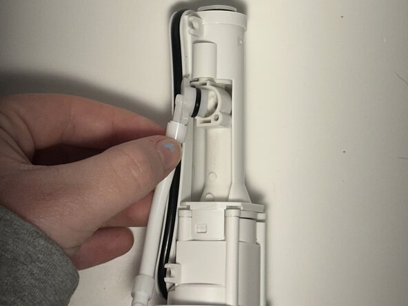

  6. Waterpik Cordless Advanced 2.0 WP-580 Water Hose O-Ring Replacement, Water Hose O-Ring: crwdns2935265:06crwdnd2935265:01crwdnd2935265:02crwdne2935265:0 Waterpik Cordless Advanced 2.0 WP-580 Water Hose O-Ring Replacement, Water Hose O-Ring: crwdns2935265:06crwdnd2935265:02crwdnd2935265:02crwdne2935265:0
    • Remove the O-ring from the top of the hose.
