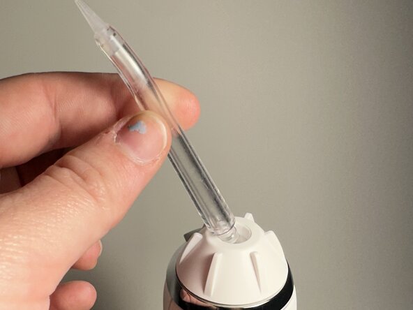

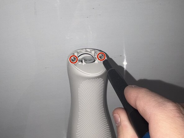

    • Depress the tip eject button and remove the tip.
    • Use an opening tool to pry off the tip rotator.
    • Avoid excessive force to prevent damaging the tip rotator.

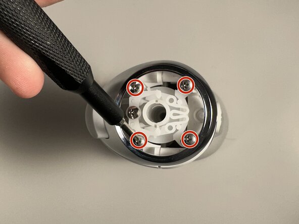

    • Remove the four Phillips screws beneath the tip rotator.
    • Remove the eject button assembly.

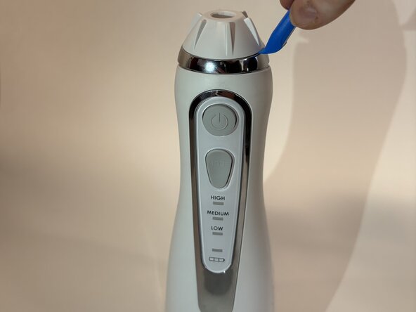

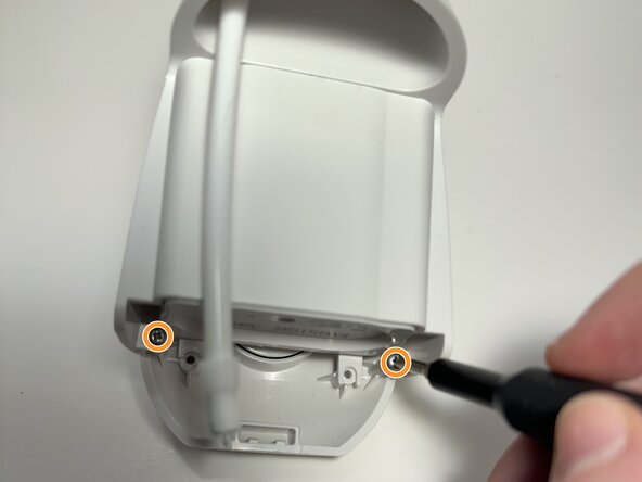

    • Use a Phillips #0 screwdriver to remove the two screws beneath the eject button assembly.

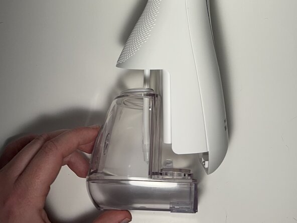

    • Remove the water reservoir.
    • Remove the two Phillips #0 screws toward the bottom of the device.

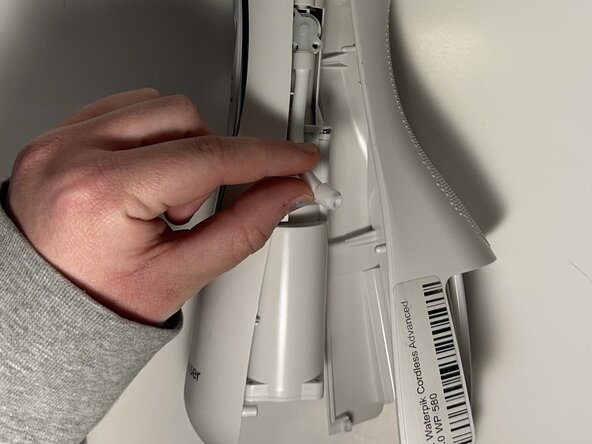

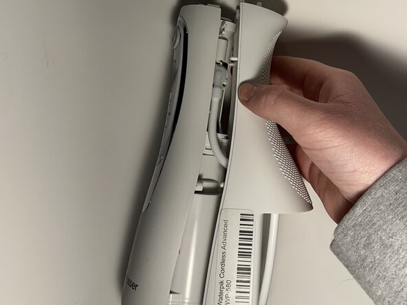

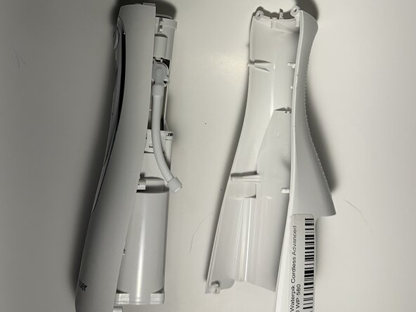

    • Insert the flat end of a spudger into the seam between the front and rear case and gently begin to pry the two halves apart.
    • Disconnect the hose from the right side of the device and fully separate the two halves.

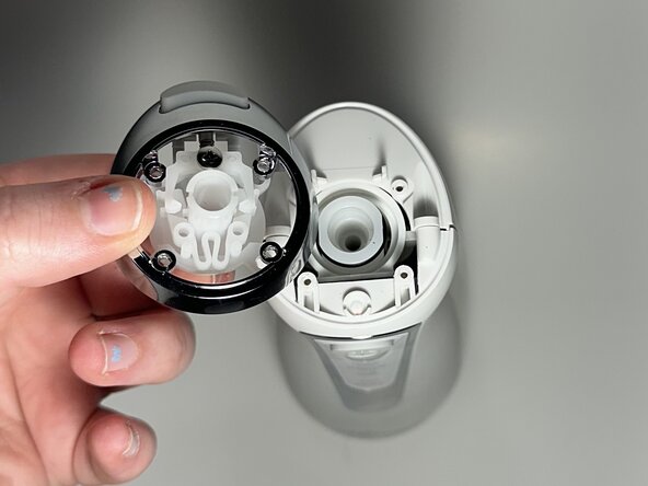

  5. Waterpik Cordless Advanced 2.0 WP-580 Nozzle O-Ring Replacement: crwdns2935265:05crwdnd2935265:01crwdnd2935265:01crwdne2935265:0

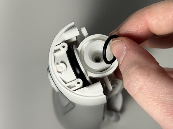

    • Remove the O-Ring at the top of the assembly.
