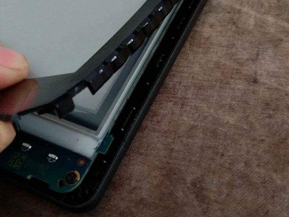

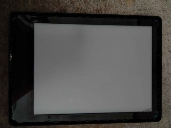

    • Use a piece of plastic, like a credit or store card, to open up the case.
  2. Water damage, Detach the secondary frame: crwdns2935265:02crwdnd2935265:01crwdnd2935265:03crwdne2935265:0 Water damage, Detach the secondary frame: crwdns2935265:02crwdnd2935265:02crwdnd2935265:03crwdne2935265:0 Water damage, Detach the secondary frame: crwdns2935265:02crwdnd2935265:03crwdnd2935265:03crwdne2935265:0
    • Lift the cover with a plastic card and carefully pull it off.
    • Tip: The glue is very strong, so I recommend helping things along with the plastic card.
    • If you remove the cover slowly and don't stick the plastic card in too far, you might be able to re-use the strip of glue.

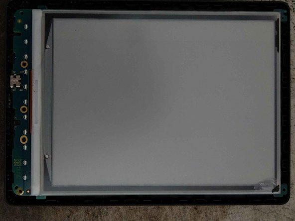

    • Loosen the seven 20mm T5 screws.
    • Then slide the display upwards.
  4. Water damage, Disconnect the battery: crwdns2935265:04crwdnd2935265:01crwdnd2935265:01crwdne2935265:0
    • Now the battery can be disconnected and replaced, if necessary.

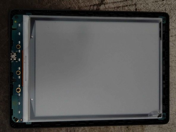

  5. Water damage, Detach the display cable: crwdns2935265:05crwdnd2935265:01crwdnd2935265:01crwdne2935265:0
    • This Kindle has water damage which corroded the display cable.
    • I think changing the display is not possible because it is glued to the mainboard, possibly even soldered. I won't try replacing it because I only need to clean the display connector.
