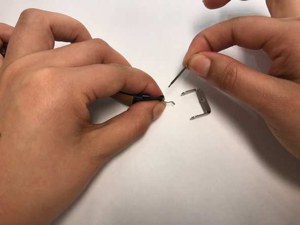

    • Hold the spring bar tool in your dominant hand and the watch strap with your non dominant hand.
    • Locate the pointed end of the spring bar.

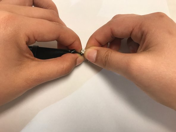

  2. Watch Strap Buckle Replacement: crwdns2935265:02crwdnd2935265:01crwdnd2935265:01crwdne2935265:0
    • Insert the pointed end of the spring bar tool into the hole on the side of the buckle.
    • Press down on the spring bar and gently push it to the side until the end of the spring bar comes out from under the metal buckle.

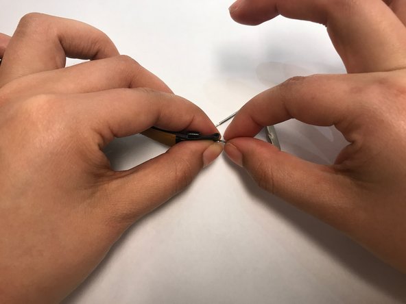

  3. Watch Strap Buckle Replacement: crwdns2935265:03crwdnd2935265:01crwdnd2935265:03crwdne2935265:0 Watch Strap Buckle Replacement: crwdns2935265:03crwdnd2935265:02crwdnd2935265:03crwdne2935265:0 Watch Strap Buckle Replacement: crwdns2935265:03crwdnd2935265:03crwdnd2935265:03crwdne2935265:0
    • Remove the U-shaped part of the buckle.
    • The spring bar may shoot out.

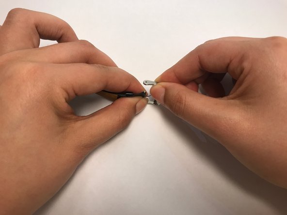

  4. Watch Strap Buckle Replacement: crwdns2935265:04crwdnd2935265:01crwdnd2935265:03crwdne2935265:0 Watch Strap Buckle Replacement: crwdns2935265:04crwdnd2935265:02crwdnd2935265:03crwdne2935265:0 Watch Strap Buckle Replacement: crwdns2935265:04crwdnd2935265:03crwdnd2935265:03crwdne2935265:0
    • Remove the spring bar and metal tongue.

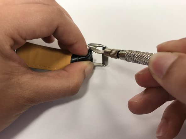

  5. Watch Strap Buckle Replacement: crwdns2935265:05crwdnd2935265:01crwdnd2935265:01crwdne2935265:0
    • Insert the new spring bar half way.
    • Do not cover the center of the buckle. This will prevent the completion of the next step.

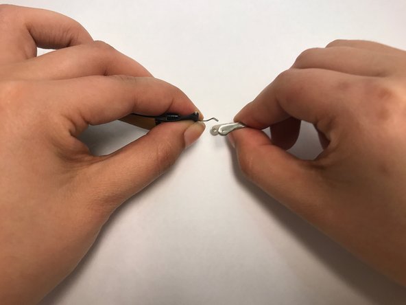

  6. Watch Strap Buckle Replacement: crwdns2935265:06crwdnd2935265:01crwdnd2935265:01crwdne2935265:0
    • Insert the new tongue, positioning the end facing down in relation to the watch strap.
    • Hold the tongue in place and slide the spring bar through the end of the strap.
    • You should be able to see both ends of the spring bar.
