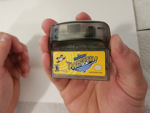

    • Use a Tri-point Y0 screwdriver to remove the single 3 mm screw located at the back of the game.
    • Remove the cover to expose the control module electronics board underneath.

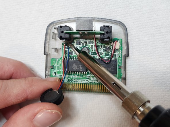

    • Heat up the soldering iron to approximately 350 degrees Fahrenheit.
    • Remove the rumble motor from the slot.
    • For more information on soldering, refer to How to Solder and Desolder Connections.
    • Apply the tip of the soldering iron to the connection points, causing the red and blue wires to melt and detach.
    • Separate the old rumble motor from the board and set it aside.
    • The soldering iron will be very hot. Do not touch the tip of the iron. It will cause severe burns.

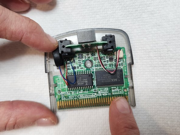

  4. WarioWare: Twisted! Rumble Motor Replacement: crwdns2935265:04crwdnd2935265:01crwdnd2935265:03crwdne2935265:0 WarioWare: Twisted! Rumble Motor Replacement: crwdns2935265:04crwdnd2935265:02crwdnd2935265:03crwdne2935265:0 WarioWare: Twisted! Rumble Motor Replacement: crwdns2935265:04crwdnd2935265:03crwdnd2935265:03crwdne2935265:0
    • Place the red wire onto the plus (left) side, and the blue wire onto the minus (right) side.
    • To reattach the red and blue wires, carefully bring the tip of the soldering iron into contact with the connection points.
    • The soldering iron will be hot. Do not touch the tip of the iron.
    • Place the new rumble motor back in its slot.
    • Turn off the soldering iron after you finish this step.

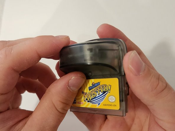

    • Put the cover back on the game.
    • Gently push the two sides back together.
  6. WarioWare: Twisted! Rumble Motor Replacement: crwdns2935265:06crwdnd2935265:01crwdnd2935265:02crwdne2935265:0 WarioWare: Twisted! Rumble Motor Replacement: crwdns2935265:06crwdnd2935265:02crwdnd2935265:02crwdne2935265:0

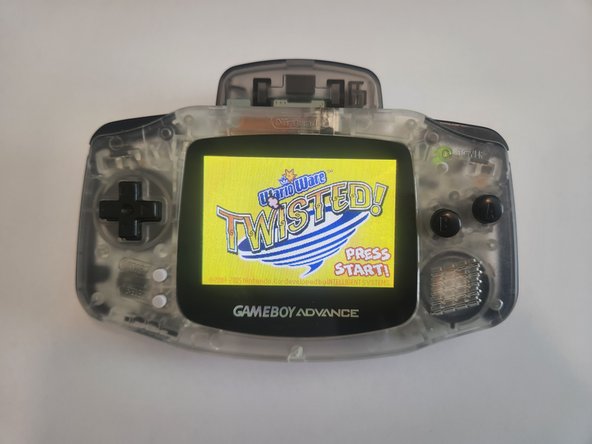

    • Use your Tri-point Y0 screwdriver to screw the single 3 mm screw back into place.
    • Test the game to make sure the problem is fixed and you should be ready to play!
