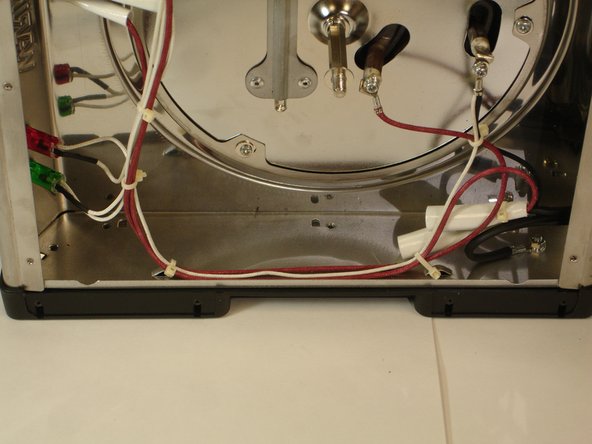

      • Remove the screws on the back panel with the #1 Phillips screwdriver bit.
      • The screws in the rubber legs of the burner do not need to be removed.
      • If the back panel has never been opened before, the screws may be more difficult to unscrew.
    2. Waring Pro SB30 Plastic Sides Replacement: crwdns2935265:02crwdnd2935265:01crwdnd2935265:02crwdne2935265:0 Waring Pro SB30 Plastic Sides Replacement: crwdns2935265:02crwdnd2935265:02crwdnd2935265:02crwdne2935265:0
      • Using a wrench, remove the bolt from the center of the back panel.
    3. Waring Pro SB30 Plastic Sides Replacement: crwdns2935265:03crwdnd2935265:01crwdnd2935265:01crwdne2935265:0
      • The back panel can now be easily lifted off.
    1. Waring Pro SB30 Plastic Sides Replacement, Plastic Sides: crwdns2935265:04crwdnd2935265:01crwdnd2935265:02crwdne2935265:0 Waring Pro SB30 Plastic Sides Replacement, Plastic Sides: crwdns2935265:04crwdnd2935265:02crwdnd2935265:02crwdne2935265:0
      • Using a #1 Phillips screwdriver bit or a ratchet wrench with a Phillips screwdriver bit to remove screws located on the interior frame.
      • The interior edges of the metal frame are sharp and can cause minor cuts.
    2. Waring Pro SB30 Plastic Sides Replacement: crwdns2935265:05crwdnd2935265:01crwdnd2935265:01crwdne2935265:0
      • Plastic sides should be easily removed after all screws are taken out.
