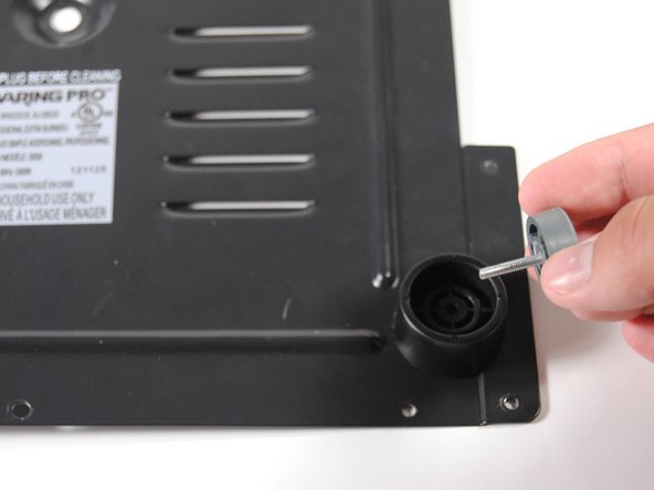

    • Remove the screws on the back panel with the #1 Phillips screwdriver bit.
    • The screws in the rubber legs of the burner do not need to be removed.
    • If the back panel has never been opened before, the screws may be more difficult to unscrew.
  2. Waring Pro SB30 Plastic Leg and Rubber Stoppers Replacement: crwdns2935265:02crwdnd2935265:01crwdnd2935265:02crwdne2935265:0 Waring Pro SB30 Plastic Leg and Rubber Stoppers Replacement: crwdns2935265:02crwdnd2935265:02crwdnd2935265:02crwdne2935265:0
    • Using a wrench, remove the bolt from the center of the back panel.
  3. Waring Pro SB30 Plastic Leg and Rubber Stoppers Replacement: crwdns2935265:03crwdnd2935265:01crwdnd2935265:01crwdne2935265:0
    • The back panel can now be easily lifted off.
  4. Waring Pro SB30 Plastic Leg and Rubber Stoppers Replacement, Plastic Leg and Rubber Stoppers: crwdns2935265:04crwdnd2935265:01crwdnd2935265:02crwdne2935265:0 Waring Pro SB30 Plastic Leg and Rubber Stoppers Replacement, Plastic Leg and Rubber Stoppers: crwdns2935265:04crwdnd2935265:02crwdnd2935265:02crwdne2935265:0
    • While using the wrench to hold the bolt, use the screwdriver to remove the screw.
    • The leg is two separate pieces, the plastic leg and rubber stopper.
    • Careful not to lose the bolts and washers as they are very small.
