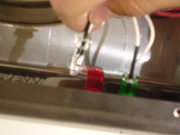

    1. Waring Pro SB30 Indicator Lights Replacement, Indicator Lights: crwdns2935265:04crwdnd2935265:01crwdnd2935265:01crwdne2935265:0
      • Using two thin screwdrivers (or similar objects) wedge them into the slots of the plastic shell of the desired light.
    2. Waring Pro SB30 Indicator Lights Replacement: crwdns2935265:05crwdnd2935265:01crwdnd2935265:02crwdne2935265:0 Waring Pro SB30 Indicator Lights Replacement: crwdns2935265:05crwdnd2935265:02crwdnd2935265:02crwdne2935265:0
      • Push the screwdrivers inward and guide the bulb outwards.
      • Gently grab by the wires and remove bulb from plastic shell.
