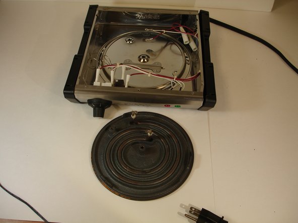

    1. Waring Pro SB30 Hot Plate Replacement, Hot Plate: crwdns2935265:04crwdnd2935265:01crwdnd2935265:02crwdne2935265:0 Waring Pro SB30 Hot Plate Replacement, Hot Plate: crwdns2935265:04crwdnd2935265:02crwdnd2935265:02crwdne2935265:0
      • Remove screws #1 Phillips screwdriver bit.
      • The interior edges of the metal frame are sharp and can cause minor cuts.
      • 3 screws on the perimeter of the circle
      • 1 screw in the circle
      • 2 screws on the eletrical stands with wires
    2. Waring Pro SB30 Hot Plate Replacement: crwdns2935265:05crwdnd2935265:01crwdnd2935265:02crwdne2935265:0 Waring Pro SB30 Hot Plate Replacement: crwdns2935265:05crwdnd2935265:02crwdnd2935265:02crwdne2935265:0
      • Remove rod from the center of the plate with a wrench.
    3. Waring Pro SB30 Hot Plate Replacement: crwdns2935265:06crwdnd2935265:01crwdnd2935265:02crwdne2935265:0 Waring Pro SB30 Hot Plate Replacement: crwdns2935265:06crwdnd2935265:02crwdnd2935265:02crwdne2935265:0
      • Remove plate carefully as to not damage internal components i.e. insulator, metal frame, wires, etc.
