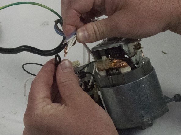

  7. Waring 51BL29 Switch Replacement: crwdns2935265:07crwdnd2935265:01crwdnd2935265:01crwdne2935265:0
    • Once motor is pulled out, unscrew the 8 mm screw for the green wire from the base of the blender.
  8. Waring 51BL29 Switch Replacement: crwdns2935265:08crwdnd2935265:01crwdnd2935265:03crwdne2935265:0 Waring 51BL29 Switch Replacement: crwdns2935265:08crwdnd2935265:02crwdnd2935265:03crwdne2935265:0 Waring 51BL29 Switch Replacement: crwdns2935265:08crwdnd2935265:03crwdnd2935265:03crwdne2935265:0
    • Unscrew each white wire cap in order to free the motor from the power cord.
    • Once wire caps are removed, separate wires carefully.
