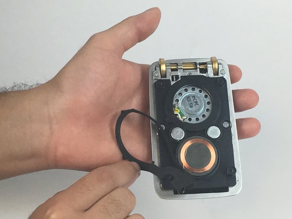

    • Remove the four T6 Torx screws (1.70mm) located on the back of the device.
    • Remove the black plastic cover by gently pulling it.
  3. Wand Company Star Trek Communicator Silver Plate Replacement: crwdns2935265:03crwdnd2935265:01crwdnd2935265:02crwdne2935265:0 Wand Company Star Trek Communicator Silver Plate Replacement: crwdns2935265:03crwdnd2935265:02crwdnd2935265:02crwdne2935265:0
    • Remove the protective foam located around the speaker and charging magnets.
    • Be careful not to lose the two magnets located between the microphone and the speaker. The magnets can be easily removed if they come in contact with other magnetic materials.

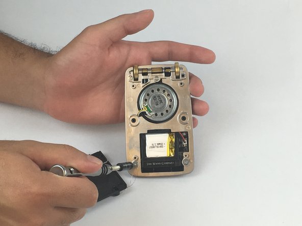

    • Remove the protective foam attached to the battery.
  7. Wand Company Star Trek Communicator Silver Plate Replacement: crwdns2935265:07crwdnd2935265:01crwdnd2935265:02crwdne2935265:0 Wand Company Star Trek Communicator Silver Plate Replacement: crwdns2935265:07crwdnd2935265:02crwdnd2935265:02crwdne2935265:0
    • Remove the five Phillips PH0 (0.9mm) screws located at the top and bottom of the silver plate.
  8. Wand Company Star Trek Communicator Silver Plate Replacement: crwdns2935265:08crwdnd2935265:01crwdnd2935265:01crwdne2935265:0
    • Remove the silver plate.
