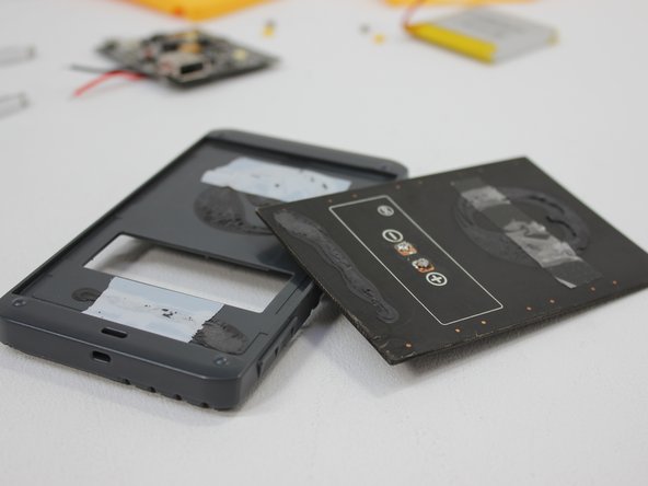

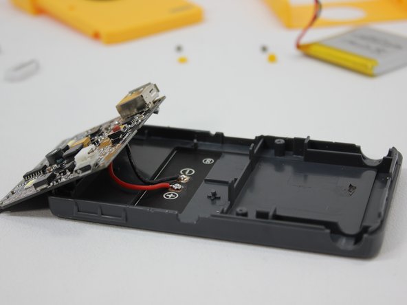

  10. Waka Waka Power Plus Teardown, Remove the PCB: crwdns2935265:010crwdnd2935265:01crwdnd2935265:03crwdne2935265:0 Waka Waka Power Plus Teardown, Remove the PCB: crwdns2935265:010crwdnd2935265:02crwdnd2935265:03crwdne2935265:0 Waka Waka Power Plus Teardown, Remove the PCB: crwdns2935265:010crwdnd2935265:03crwdnd2935265:03crwdne2935265:0
    • There are two plastic pins holding the PCB in place. You will have to break them.
    • Undo the connection between the PCB and the solar panel with a soldering iron. Do not pull the cables out, this may result in severe damage to the cables or PCB.
    • Top tip: for one time at least, you can redo the plastic pins holding the PCB by pressing a semi-hot soldering iron on the plastic.

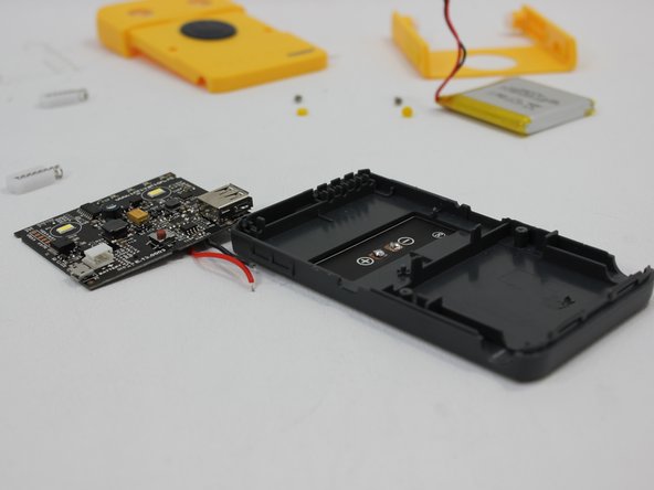

  11. Waka Waka Power Plus Teardown, PCBA: crwdns2935265:011crwdnd2935265:01crwdnd2935265:02crwdne2935265:0 Waka Waka Power Plus Teardown, PCBA: crwdns2935265:011crwdnd2935265:02crwdnd2935265:02crwdne2935265:0
    • Most important silicon:
    • Texas instruments LM358 Dual opamp
    • Fairchild Semiconductors MJD210 PNP Transistor
    • NXP 74HC595 8Bit shift register
    • Intivation SNBST3 MPPT Solar charger with integrated MCU (heart of the Waka Waka)
    • Dsunsolar High efficiency PET film solar panel. Custom made for Intivation.
  12. Waka Waka Power Plus Teardown, Pry out the solar panel: crwdns2935265:012crwdnd2935265:01crwdnd2935265:02crwdne2935265:0 Waka Waka Power Plus Teardown, Pry out the solar panel: crwdns2935265:012crwdnd2935265:02crwdnd2935265:02crwdne2935265:0
    • Use a flat object like a bank card to avoid bending the solar panel.
    • This Waka Waka has been opened up previously to this teardown. Since the solar panel was originally glued in place, the solar panel was re-attached using double sided tape. When putting your Waka Waka back together, you could either choose glue or double sided tape. Both work fine.
