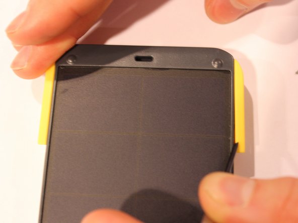

    • Lay device so power button is facing up.
    • Lift the plastic cover from the center of the device.
  2. Waka Waka Power Plus Battery Replacement, Rubber dots: crwdns2935265:02crwdnd2935265:01crwdnd2935265:02crwdne2935265:0 Waka Waka Power Plus Battery Replacement, Rubber dots: crwdns2935265:02crwdnd2935265:02crwdnd2935265:02crwdne2935265:0
    • Remove yellow rubber dots.
  3. Waka Waka Power Plus Battery Replacement, Screws: crwdns2935265:03crwdnd2935265:01crwdnd2935265:01crwdne2935265:0
    • Remove the two 5mm screws with a #0 Phillips screwdriver.

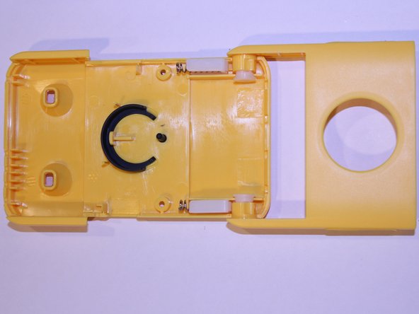

  4. Waka Waka Power Plus Battery Replacement, Remove casing: crwdns2935265:04crwdnd2935265:01crwdnd2935265:02crwdne2935265:0 Waka Waka Power Plus Battery Replacement, Remove casing: crwdns2935265:04crwdnd2935265:02crwdnd2935265:02crwdne2935265:0
    • Carefully remove yellow casing.
    • This might take prying force.

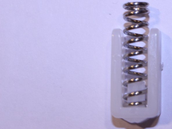

  5. Waka Waka Power Plus Battery Replacement, Black casing with battery: crwdns2935265:05crwdnd2935265:01crwdnd2935265:03crwdne2935265:0 Waka Waka Power Plus Battery Replacement, Black casing with battery: crwdns2935265:05crwdnd2935265:02crwdnd2935265:03crwdne2935265:0 Waka Waka Power Plus Battery Replacement, Black casing with battery: crwdns2935265:05crwdnd2935265:03crwdnd2935265:03crwdne2935265:0
    • You now separated the black part containing the battery and the yellow case.
    • Remove the springs and their white casings to easily reach the battery.

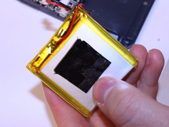

  6. Waka Waka Power Plus Battery Replacement, Unplug: crwdns2935265:06crwdnd2935265:01crwdnd2935265:01crwdne2935265:0
    • Unplug the battery from the motherboard.
  7. Waka Waka Power Plus Battery Replacement, Lift out: crwdns2935265:07crwdnd2935265:01crwdnd2935265:02crwdne2935265:0 Waka Waka Power Plus Battery Replacement, Lift out: crwdns2935265:07crwdnd2935265:02crwdnd2935265:02crwdne2935265:0
    • Remove the battery by lifting it out.
    • The battery is stuck with double sided tape and may take some effort to remove.
Replacement batteries can be found online. After placing in the new battery reassemble your device, follow these instructions in reverse order.
