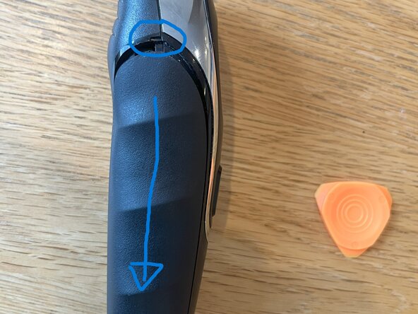

  1. Wahl Barracuda Lithium-ion Trimmer Battery Replacement, Remove side grips: crwdns2935265:01crwdnd2935265:01crwdnd2935265:01crwdne2935265:0
    • Remove the shaver blade and slide the grips off on each side. You can use a pry tool in the notch to assist.

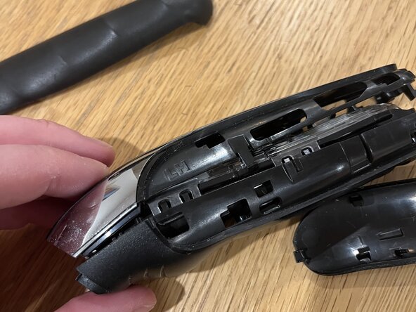

  2. Wahl Barracuda Lithium-ion Trimmer Battery Replacement, Remove outer shell: crwdns2935265:02crwdnd2935265:01crwdnd2935265:02crwdne2935265:0 Wahl Barracuda Lithium-ion Trimmer Battery Replacement, Remove outer shell: crwdns2935265:02crwdnd2935265:02crwdnd2935265:02crwdne2935265:0
    • Remove the outer shell with pry tools.
