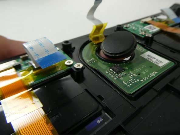

  6. Wacom Intuos4 Touch Ring Replacement, Touch Ring: crwdns2935265:06crwdnd2935265:01crwdnd2935265:02crwdne2935265:0 Wacom Intuos4 Touch Ring Replacement, Touch Ring: crwdns2935265:06crwdnd2935265:02crwdnd2935265:02crwdne2935265:0
    • Remove the plastic tracking ball by lifting it up and out of its slot.
  7. Wacom Intuos4 Touch Ring Replacement: crwdns2935265:07crwdnd2935265:01crwdnd2935265:01crwdne2935265:0
    • Use an iFixit opening tool to gently lift the circuit board from the slot.
    • If the touch ring doesn't come out immediately, do not force it or you may cause damage to the device. If it is difficult to remove, heat the front face of the touch ring to loosen the glue that holds it in.
