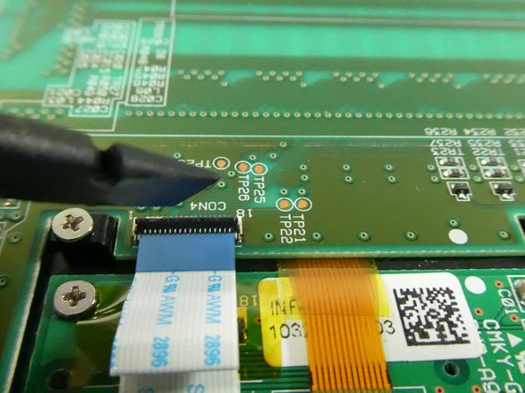

    1. Wacom Intuos4 Express Keys Replacement, Express Keys: crwdns2935265:03crwdnd2935265:01crwdnd2935265:03crwdne2935265:0 Wacom Intuos4 Express Keys Replacement, Express Keys: crwdns2935265:03crwdnd2935265:02crwdnd2935265:03crwdne2935265:0 Wacom Intuos4 Express Keys Replacement, Express Keys: crwdns2935265:03crwdnd2935265:03crwdnd2935265:03crwdne2935265:0
      • Lift yellow tape covering the flat wires with a pair of tweezers.
      • Lift the black plastic clip holding the flat wire to the connector.
      • This should be done with a plastic tool to avoid damaging the contacts.
      • Pull on the white plastic tab to disconnect the flat wire.
      • Do this for the left and right express key chips.

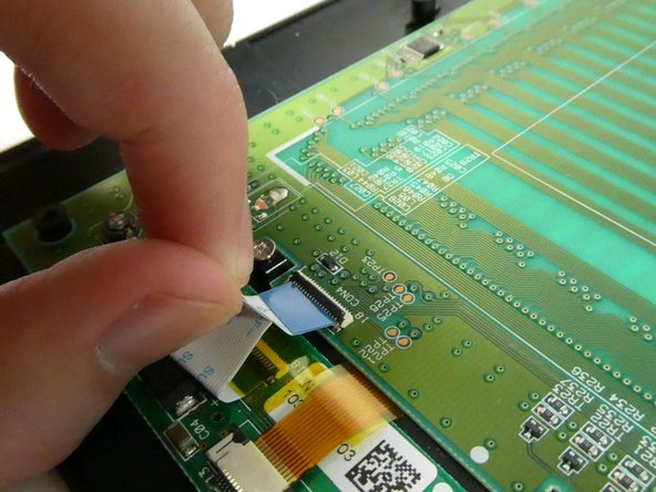

    2. Wacom Intuos4 Express Keys Replacement: crwdns2935265:04crwdnd2935265:01crwdnd2935265:01crwdne2935265:0
      • Pull the black plastic clip away from the flat wire connector, and pull the flat wire out.
      • It may be easier to pull with a tool on one side, and with your hand on the other at the same time.

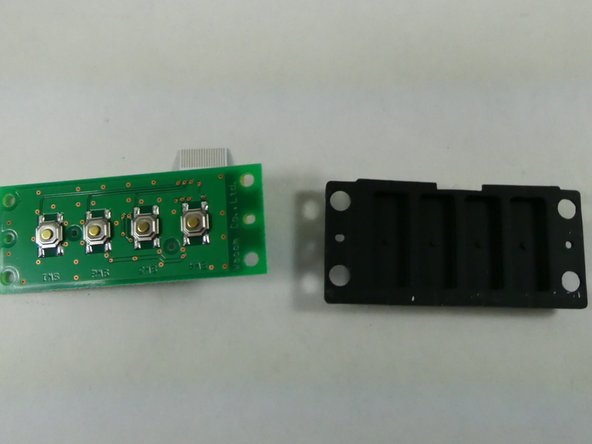

    3. Wacom Intuos4 Express Keys Replacement: crwdns2935265:05crwdnd2935265:01crwdnd2935265:01crwdne2935265:0
      • Use a #1 Phillips head screwdriver to unscrew the four 5mm screws on the express key board you want to replace.
    4. Wacom Intuos4 Express Keys Replacement: crwdns2935265:06crwdnd2935265:01crwdnd2935265:02crwdne2935265:0 Wacom Intuos4 Express Keys Replacement: crwdns2935265:06crwdnd2935265:02crwdnd2935265:02crwdne2935265:0
      • Lift the board and rubber buttons up from the case.
      • Separate the rubber buttons from the board.
