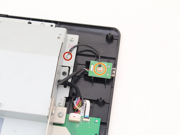

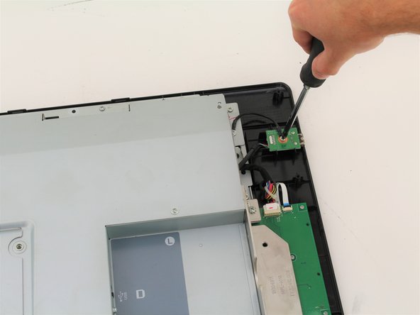

  6. Wacom Cintiq 24HD USB Accessory Port Replacement, USB Accessory Port: crwdns2935265:06crwdnd2935265:01crwdnd2935265:03crwdne2935265:0 Wacom Cintiq 24HD USB Accessory Port Replacement, USB Accessory Port: crwdns2935265:06crwdnd2935265:02crwdnd2935265:03crwdne2935265:0 Wacom Cintiq 24HD USB Accessory Port Replacement, USB Accessory Port: crwdns2935265:06crwdnd2935265:03crwdnd2935265:03crwdne2935265:0
    • Remove one 8mm Phillips #2 screw by turning the screwdriver counterclockwise
    • Remove one 9.9mm Phillips #2 screw by turning the screwdriver counterclockwise.
  7. Wacom Cintiq 24HD USB Accessory Port Replacement: crwdns2935265:07crwdnd2935265:01crwdnd2935265:02crwdne2935265:0 Wacom Cintiq 24HD USB Accessory Port Replacement: crwdns2935265:07crwdnd2935265:02crwdnd2935265:02crwdne2935265:0
    • Remove the black grounding wire by lifting up.
    • Remove the USB port board by pinching the wiring close to the connector and gently pulling out.
