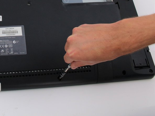

    • Place the device screen down on a flat surface.
    • Remove eight 10mm Phillips #2 screws (four on each leg of the stand) by turning the screwdriver counterclockwise.

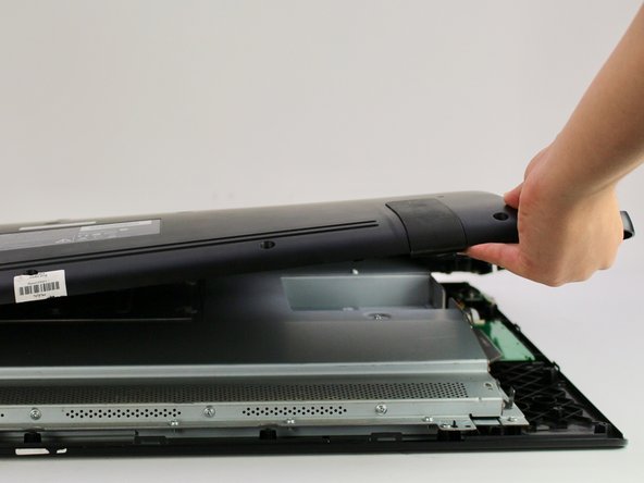

    • Lift the stand up and away from the rest of the device so the legs separate from the mounting plate.

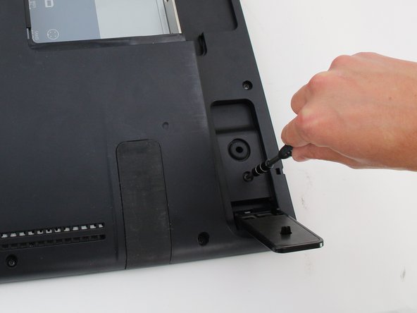

  4. Wacom Cintiq 24HD Power Port Replacement, Back Panel: crwdns2935265:04crwdnd2935265:01crwdnd2935265:03crwdne2935265:0 Wacom Cintiq 24HD Power Port Replacement, Back Panel: crwdns2935265:04crwdnd2935265:02crwdnd2935265:03crwdne2935265:0 Wacom Cintiq 24HD Power Port Replacement, Back Panel: crwdns2935265:04crwdnd2935265:03crwdnd2935265:03crwdne2935265:0
    • Remove eighteen 10.2mm Phillips #1 screws from the perimeter of the back panel by turning the screwdriver counterclockwise.
    • Remove one 11.9mm Phillips #1 screw from the center of the back panel.
    • Remove two 10.2mm Phillips #1 screws from underneath hinged panels in the bottom right and left corners.
    • Our device does not include the cover panels for the USB, DVI-D, and power ports. You must first remove these cover panels shown in green in order to remove the back panel.

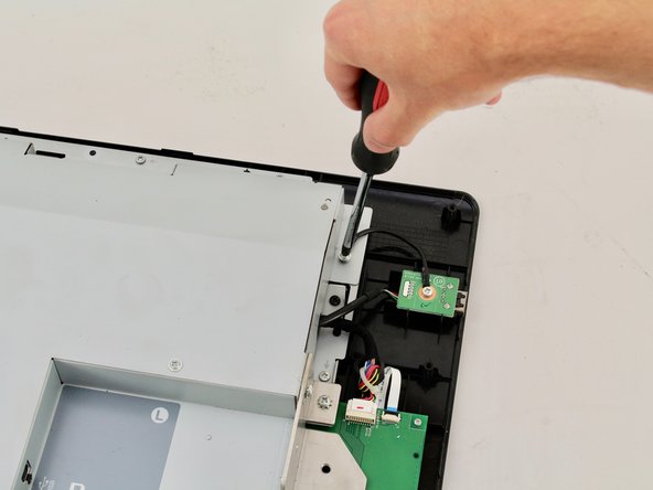

  6. Wacom Cintiq 24HD Power Port Replacement, Interior Metal Plate: crwdns2935265:06crwdnd2935265:01crwdnd2935265:03crwdne2935265:0 Wacom Cintiq 24HD Power Port Replacement, Interior Metal Plate: crwdns2935265:06crwdnd2935265:02crwdnd2935265:03crwdne2935265:0 Wacom Cintiq 24HD Power Port Replacement, Interior Metal Plate: crwdns2935265:06crwdnd2935265:03crwdnd2935265:03crwdne2935265:0
    • Detach the small black wire connecting the back metal plate to the USB video port by removing the one 8 mm Phillips #2 screw from the back metal plate and turning the screwdriver counterclockwise.

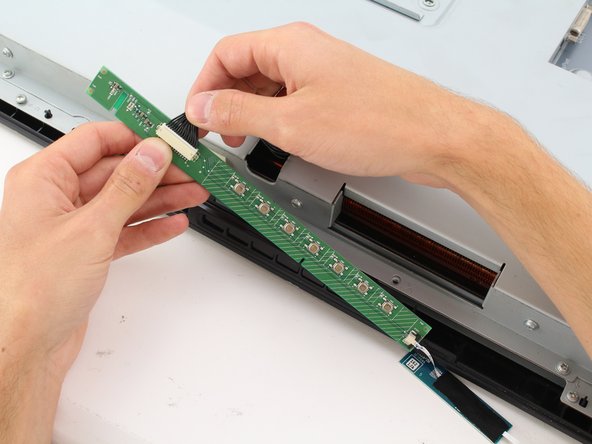

  8. Wacom Cintiq 24HD Power Port Replacement: crwdns2935265:08crwdnd2935265:01crwdnd2935265:03crwdne2935265:0 Wacom Cintiq 24HD Power Port Replacement: crwdns2935265:08crwdnd2935265:02crwdnd2935265:03crwdne2935265:0 Wacom Cintiq 24HD Power Port Replacement: crwdns2935265:08crwdnd2935265:03crwdnd2935265:03crwdne2935265:0

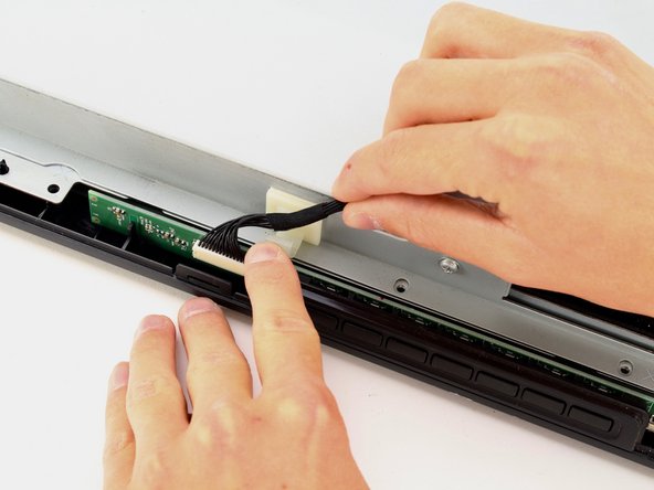

    • Remove the button wires from the support clip by pushing down on the clip.
    • Detach the button wires from the button board by pulling the button wires away from the board.
    • Place the button board back in to the device.

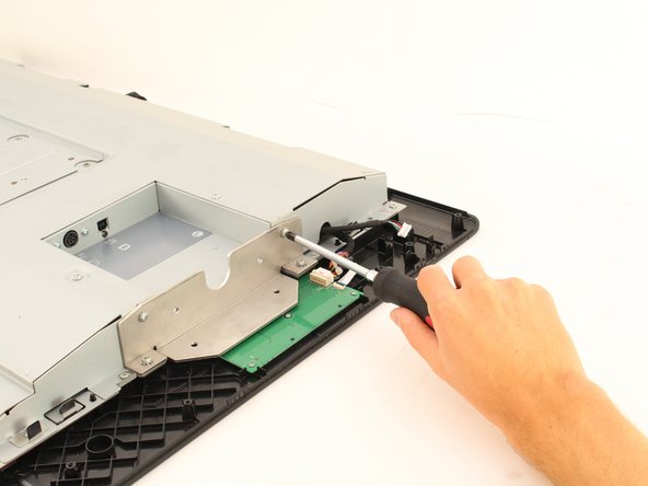

  9. Wacom Cintiq 24HD Power Port Replacement: crwdns2935265:09crwdnd2935265:01crwdnd2935265:03crwdne2935265:0 Wacom Cintiq 24HD Power Port Replacement: crwdns2935265:09crwdnd2935265:02crwdnd2935265:03crwdne2935265:0 Wacom Cintiq 24HD Power Port Replacement: crwdns2935265:09crwdnd2935265:03crwdnd2935265:03crwdne2935265:0

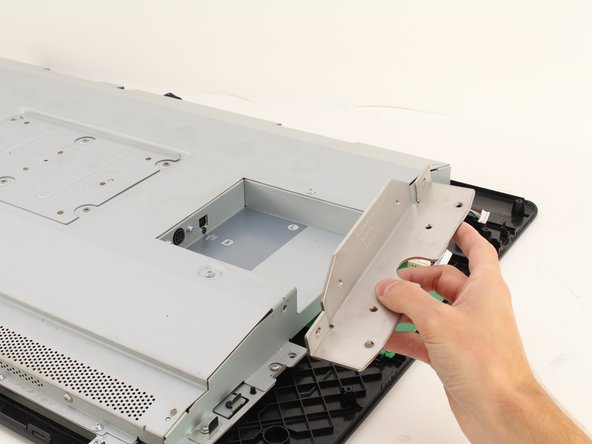

    • Remove the eight (four on each plate) 10.2mm Phillips #2 screws with locking washers from the metal mounting plates by rotating the screwdriver counterclockwise.
    • Remove the two metal mounting plates.

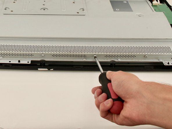

  10. Wacom Cintiq 24HD Power Port Replacement: crwdns2935265:010crwdnd2935265:01crwdnd2935265:03crwdne2935265:0 Wacom Cintiq 24HD Power Port Replacement: crwdns2935265:010crwdnd2935265:02crwdnd2935265:03crwdne2935265:0 Wacom Cintiq 24HD Power Port Replacement: crwdns2935265:010crwdnd2935265:03crwdnd2935265:03crwdne2935265:0

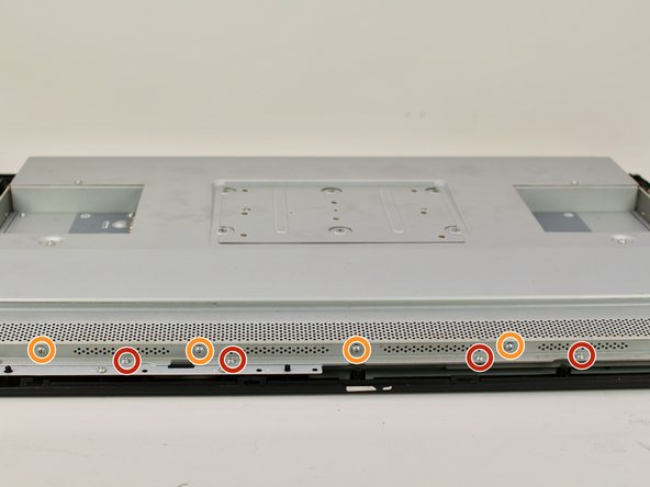

    • Remove the sixteen 8 mm Phillips #2 screws with flanges from the horizontal side of the plate by turning the screwdriver counterclockwise.
    • Remove the ten 8 mm Phillips #2 screws with flanges from the vertical sides of the plate by turning the screwdriver counterclockwise.
  11. Wacom Cintiq 24HD Power Port Replacement: crwdns2935265:011crwdnd2935265:01crwdnd2935265:01crwdne2935265:0
    • Remove the back metal plate by lifting up along one edge , then lifting the plate off and away from the device.

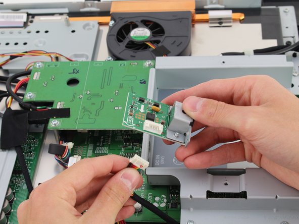

  13. Wacom Cintiq 24HD Power Port Replacement: crwdns2935265:013crwdnd2935265:01crwdnd2935265:02crwdne2935265:0 Wacom Cintiq 24HD Power Port Replacement: crwdns2935265:013crwdnd2935265:02crwdnd2935265:02crwdne2935265:0
    • Lift the power port and attached daughterboard out of the device.
    • Remove the wires from the daughterboard.
    • Pull gently on the wires when removing from the daughterboard to prevent any tearing.
  14. Wacom Cintiq 24HD Power Port Replacement: crwdns2935265:014crwdnd2935265:01crwdnd2935265:02crwdne2935265:0 Wacom Cintiq 24HD Power Port Replacement: crwdns2935265:014crwdnd2935265:02crwdnd2935265:02crwdne2935265:0
    • Remove the two 8 mm Phillips #2 screws from the daughterboard by turning the screwdriver counterclockwise.
    • Detach the metal cover from the power port.
  15. Wacom Cintiq 24HD Power Port Replacement: crwdns2935265:015crwdnd2935265:01crwdnd2935265:02crwdne2935265:0 Wacom Cintiq 24HD Power Port Replacement: crwdns2935265:015crwdnd2935265:02crwdnd2935265:02crwdne2935265:0

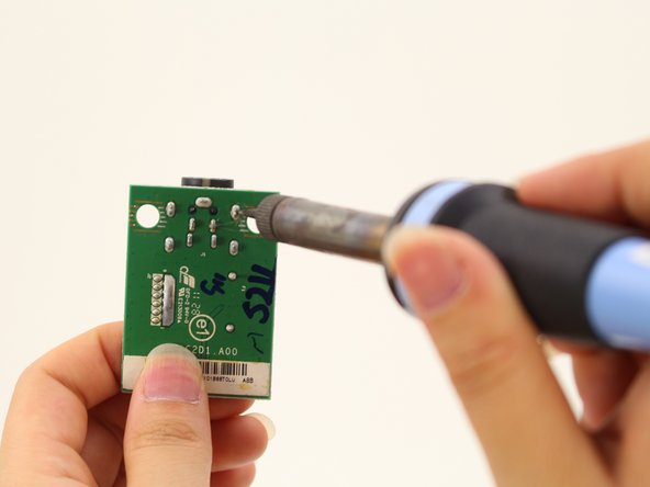

    • Desolder the connections the power port connections using a soldering iron.
    • Remove the power port from the daughterboard by lifting it off.
    • iFixit has a guide to soldering which you can find here.
