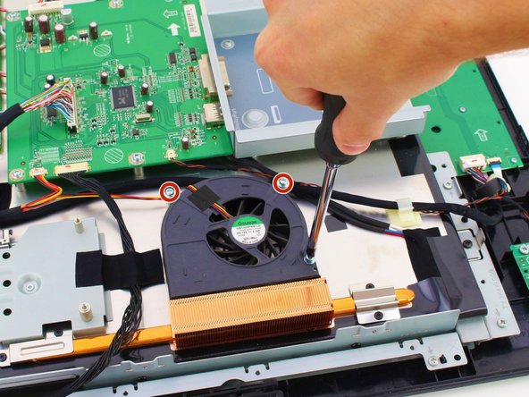

  12. Wacom Cintiq 24HD Fan Replacement, Fan: crwdns2935265:012crwdnd2935265:01crwdnd2935265:02crwdne2935265:0 Wacom Cintiq 24HD Fan Replacement, Fan: crwdns2935265:012crwdnd2935265:02crwdnd2935265:02crwdne2935265:0
    • Remove three 8 mm Phillips #2 screws by turning screwdriver counterclockwise.
    • Each screw has two washers, one flat and one split. The split washer sits between the flat washer and the screw head.

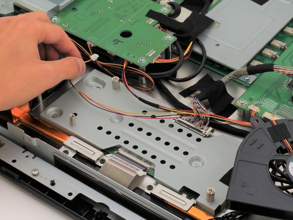

  13. Wacom Cintiq 24HD Fan Replacement: crwdns2935265:013crwdnd2935265:01crwdnd2935265:02crwdne2935265:0 Wacom Cintiq 24HD Fan Replacement: crwdns2935265:013crwdnd2935265:02crwdnd2935265:02crwdne2935265:0
    • Remove the fan wiring from the motherboard by gently pinching close to the connector and pulling outwards.
    • Handle small wires with care to avoid crimping or breaking them.
    • Untangle the fan wiring by pulling it towards the fan and under, over, or around other wiring .
    • You may have to break the black wire tape that holds down the wires to free them.
  14. Wacom Cintiq 24HD Fan Replacement: crwdns2935265:014crwdnd2935265:01crwdnd2935265:01crwdne2935265:0
    • Remove the fan by lifting it up and off of the screw shafts.
