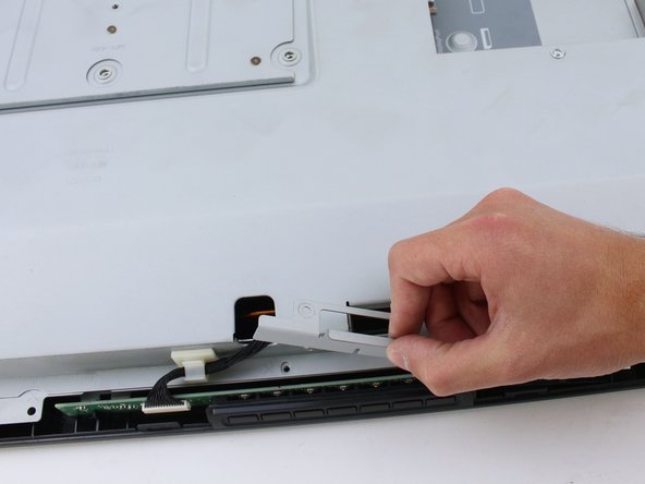

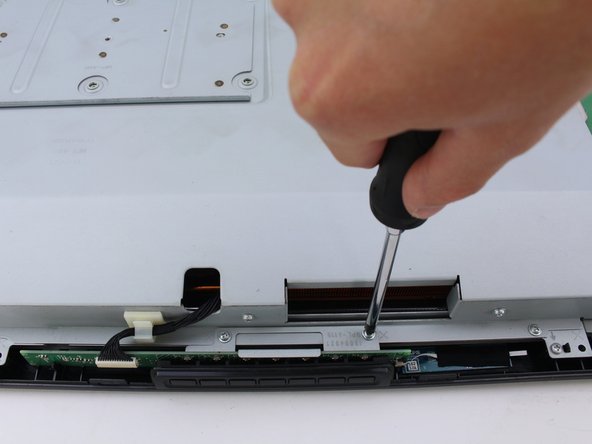

    1. Wacom Cintiq 24HD Display Control Buttons Replacement, Display Control Buttons: crwdns2935265:06crwdnd2935265:01crwdnd2935265:03crwdne2935265:0 Wacom Cintiq 24HD Display Control Buttons Replacement, Display Control Buttons: crwdns2935265:06crwdnd2935265:02crwdnd2935265:03crwdne2935265:0 Wacom Cintiq 24HD Display Control Buttons Replacement, Display Control Buttons: crwdns2935265:06crwdnd2935265:03crwdnd2935265:03crwdne2935265:0
      • Remove the two 8mm screws from the metal button plate using a Phillips #2 screwdriver and by turning clockwise.
      • Remove metal holding plate by lifting up and off of the button board.
    2. Wacom Cintiq 24HD Display Control Buttons Replacement: crwdns2935265:07crwdnd2935265:01crwdnd2935265:01crwdne2935265:0
      • Remove the button board by pinching the wiring close to the connector and gently pulling straight out from the port.
    3. Wacom Cintiq 24HD Display Control Buttons Replacement: crwdns2935265:08crwdnd2935265:01crwdnd2935265:01crwdne2935265:0
      • Remove the button cover by pushing the buttons out of their holes and pulling the cover up.
