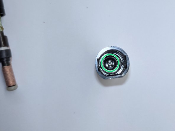

    • The pen buttons are firmly clipped in to the lower part of the pen body.
    • Press the lower button to make the insertion of a tool easier
    • Insert a thin piece of plastic underneath the button and pull it
    • The pen buttons are not required to be removed to take out the PCB board of the pen.

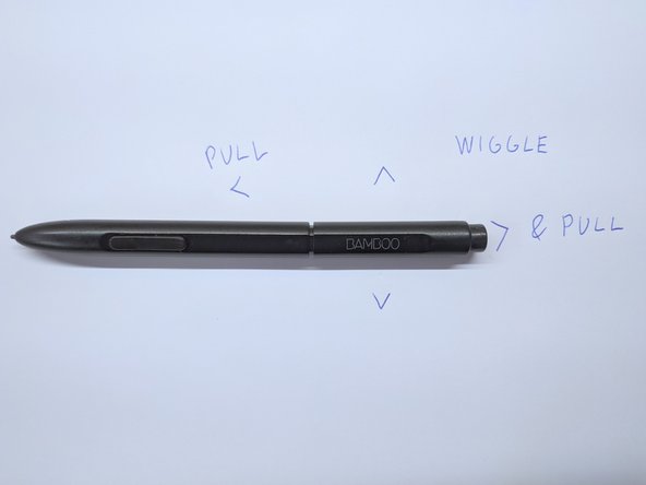

  3. Wacom Bamboo Pen LP160E Disassembly: crwdns2935265:03crwdnd2935265:01crwdnd2935265:03crwdne2935265:0 Wacom Bamboo Pen LP160E Disassembly: crwdns2935265:03crwdnd2935265:02crwdnd2935265:03crwdne2935265:0 Wacom Bamboo Pen LP160E Disassembly: crwdns2935265:03crwdnd2935265:03crwdnd2935265:03crwdne2935265:0
    • Two main elements of the body are held together with friction. No glue is present
    • Pull the body parts in opposite direction while wiggling the upper part up and down
    • SIlent creaking sounds might be emitted
    • Reduce the power of pulling if the plastic part is almost loose. Check the third image in the gallery to estimate how much of the plastic body part is still inside.

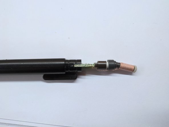

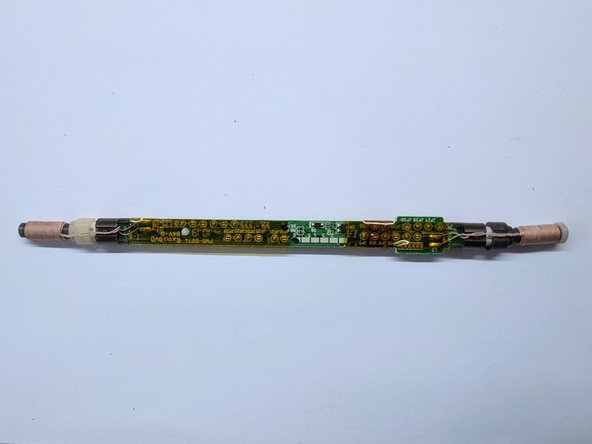

  4. Wacom Bamboo Pen LP160E Disassembly: crwdns2935265:04crwdnd2935265:01crwdnd2935265:02crwdne2935265:0 Wacom Bamboo Pen LP160E Disassembly: crwdns2935265:04crwdnd2935265:02crwdnd2935265:02crwdne2935265:0
    • Slide out the PCB board of the pen
    • The eraser and pen tip coils are loose and only held by two thin copper cables. Watch out not to break them!
    • All parts of the pen should now be loose.
  5. Wacom Bamboo Pen LP160E Disassembly: crwdns2935265:05crwdnd2935265:01crwdnd2935265:02crwdne2935265:0 Wacom Bamboo Pen LP160E Disassembly: crwdns2935265:05crwdnd2935265:02crwdnd2935265:02crwdne2935265:0
    • Upon reassembly, align the hole inside of the eraser coil to the plastic element inside of the upper part of the pen body.
The eraser sensor contains a hole that needs to align with plastic element inside of the upper part of the pen.
