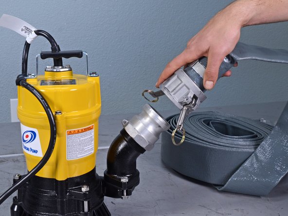

  1. Wacker Pump PST2 400 2008 Power Cable Replacement, Remove the cotter pins: crwdns2935265:01crwdnd2935265:01crwdnd2935265:03crwdne2935265:0 Wacker Pump PST2 400 2008 Power Cable Replacement, Remove the cotter pins: crwdns2935265:01crwdnd2935265:02crwdnd2935265:03crwdne2935265:0 Wacker Pump PST2 400 2008 Power Cable Replacement, Remove the cotter pins: crwdns2935265:01crwdnd2935265:03crwdnd2935265:03crwdne2935265:0
    • Before starting, ensure the device is unplugged from power.
    • Pull to remove the two cotter pins securing the hose's locking arms, one on either side.
  2. Wacker Pump PST2 400 2008 Power Cable Replacement, Unlock the collar arms: crwdns2935265:02crwdnd2935265:01crwdnd2935265:03crwdne2935265:0 Wacker Pump PST2 400 2008 Power Cable Replacement, Unlock the collar arms: crwdns2935265:02crwdnd2935265:02crwdnd2935265:03crwdne2935265:0 Wacker Pump PST2 400 2008 Power Cable Replacement, Unlock the collar arms: crwdns2935265:02crwdnd2935265:03crwdnd2935265:03crwdne2935265:0
    • Flip the two locking arms down to unlock the hose collar.
  3. Wacker Pump PST2 400 2008 Power Cable Replacement, Remove the hose: crwdns2935265:03crwdnd2935265:01crwdnd2935265:02crwdne2935265:0 Wacker Pump PST2 400 2008 Power Cable Replacement, Remove the hose: crwdns2935265:03crwdnd2935265:02crwdnd2935265:02crwdne2935265:0
    • Lift the hose away from the collar on the pump body to remove it.

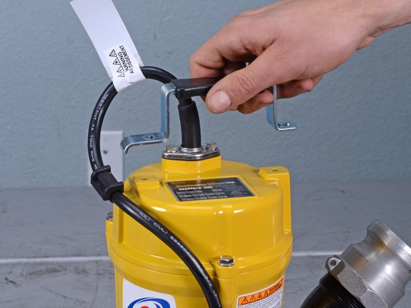

  5. Wacker Pump PST2 400 2008 Power Cable Replacement, Remove the handle: crwdns2935265:05crwdnd2935265:01crwdnd2935265:02crwdne2935265:0 Wacker Pump PST2 400 2008 Power Cable Replacement, Remove the handle: crwdns2935265:05crwdnd2935265:02crwdnd2935265:02crwdne2935265:0
    • Remove the handle.

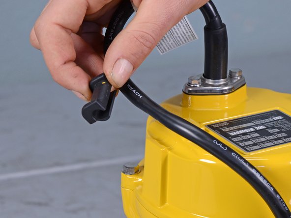

  6. Wacker Pump PST2 400 2008 Power Cable Replacement, Remove the cable guide: crwdns2935265:06crwdnd2935265:01crwdnd2935265:02crwdne2935265:0 Wacker Pump PST2 400 2008 Power Cable Replacement, Remove the cable guide: crwdns2935265:06crwdnd2935265:02crwdnd2935265:02crwdne2935265:0
    • Remove the plastic cable guide from the power cord.
    • During reassembly, ensure that the cable has enough slack and is not kinked at its flex joint before securing the cable guide with the handle bolt.

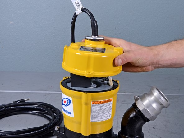

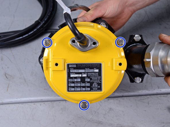

  7. Wacker Pump PST2 400 2008 Power Cable Replacement, Remove the housing cover: crwdns2935265:07crwdnd2935265:01crwdnd2935265:02crwdne2935265:0 Wacker Pump PST2 400 2008 Power Cable Replacement, Remove the housing cover: crwdns2935265:07crwdnd2935265:02crwdnd2935265:02crwdne2935265:0
    • Use an 8 mm socket to remove the two bolts securing the power cable to the housing cover.
    • Use a 10 mm socket to remove the three bolts securing the housing cover to the main body.

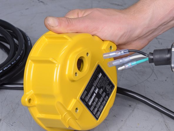

  8. Wacker Pump PST2 400 2008 Power Cable Replacement: crwdns2935265:08crwdnd2935265:01crwdnd2935265:03crwdne2935265:0 Wacker Pump PST2 400 2008 Power Cable Replacement: crwdns2935265:08crwdnd2935265:02crwdnd2935265:03crwdne2935265:0 Wacker Pump PST2 400 2008 Power Cable Replacement: crwdns2935265:08crwdnd2935265:03crwdnd2935265:03crwdne2935265:0
    • Lift the housing cover up and off of the main body.
    • The housing cover is still attached at the power cord, so don't attempt to completely remove it just yet.

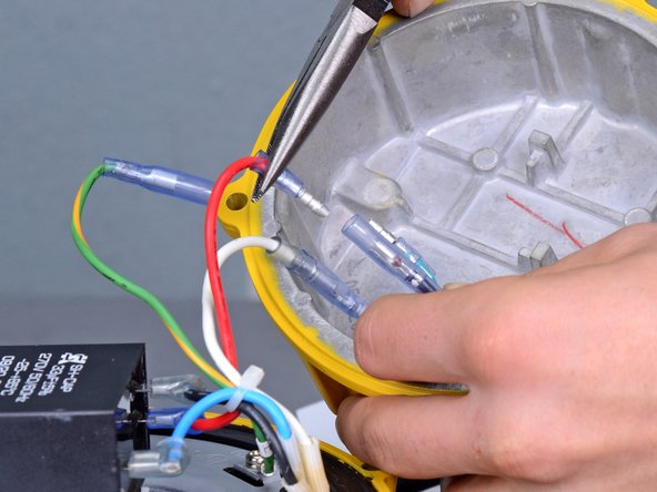

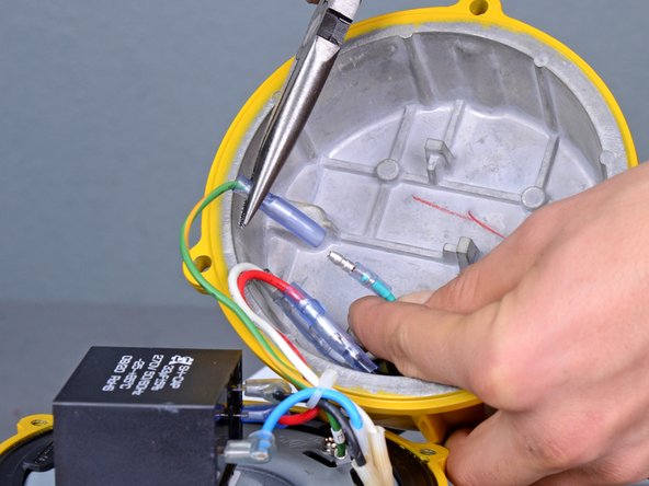

  9. Wacker Pump PST2 400 2008 Power Cable Replacement, Disconnect the ground wire: crwdns2935265:09crwdnd2935265:01crwdnd2935265:02crwdne2935265:0 Wacker Pump PST2 400 2008 Power Cable Replacement, Disconnect the ground wire: crwdns2935265:09crwdnd2935265:02crwdnd2935265:02crwdne2935265:0
    • Use a pair of needle nose pliers to disconnect the ground wire's bullet connector.

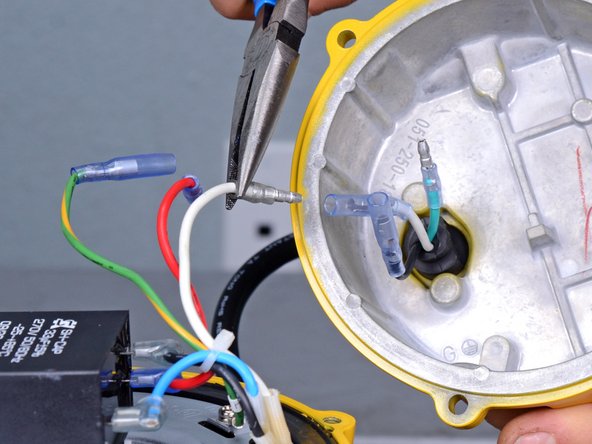

  10. Wacker Pump PST2 400 2008 Power Cable Replacement, Disconnect the power wires: crwdns2935265:010crwdnd2935265:01crwdnd2935265:03crwdne2935265:0 Wacker Pump PST2 400 2008 Power Cable Replacement, Disconnect the power wires: crwdns2935265:010crwdnd2935265:02crwdnd2935265:03crwdne2935265:0 Wacker Pump PST2 400 2008 Power Cable Replacement, Disconnect the power wires: crwdns2935265:010crwdnd2935265:03crwdnd2935265:03crwdne2935265:0
    • Use a pair of needle nose pliers to disconnect the red and white power wires' bullet connectors.
    • During reassembly:
    • Connect the power cord's black wire to the device's red wire
    • Connect the green ground wires together
    • Connect the white wires together
  11. Wacker Pump PST2 400 2008 Power Cable Replacement, Remove the power cable: crwdns2935265:011crwdnd2935265:01crwdnd2935265:02crwdne2935265:0 Wacker Pump PST2 400 2008 Power Cable Replacement, Remove the power cable: crwdns2935265:011crwdnd2935265:02crwdnd2935265:02crwdne2935265:0
    • Pull the loose power cable out through its hole on the housing cover to remove it.
