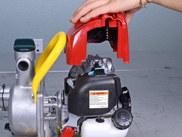

  2. Wacker Pump PG1 2014 Carburetor Replacement, Remove the engine cover: crwdns2935265:02crwdnd2935265:01crwdnd2935265:01crwdne2935265:0
    • Use a 4 mm hex key to remove the bolt securing the engine cover.
  3. Wacker Pump PG1 2014 Carburetor Replacement: crwdns2935265:03crwdnd2935265:01crwdnd2935265:02crwdne2935265:0 Wacker Pump PG1 2014 Carburetor Replacement: crwdns2935265:03crwdnd2935265:02crwdnd2935265:02crwdne2935265:0
    • Lift up to remove the engine cover.

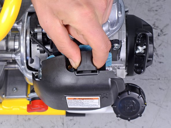

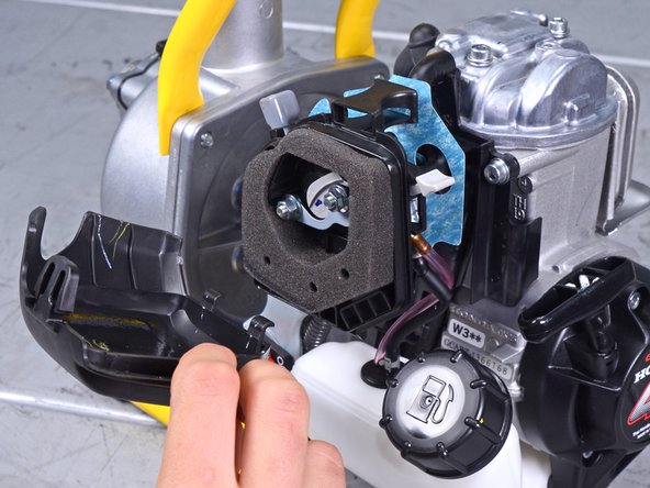

  4. Wacker Pump PG1 2014 Carburetor Replacement, Remove the air box cover: crwdns2935265:04crwdnd2935265:01crwdnd2935265:02crwdne2935265:0 Wacker Pump PG1 2014 Carburetor Replacement, Remove the air box cover: crwdns2935265:04crwdnd2935265:02crwdnd2935265:02crwdne2935265:0
    • Use your fingers to pinch the locking tab on the top of the air box cover.

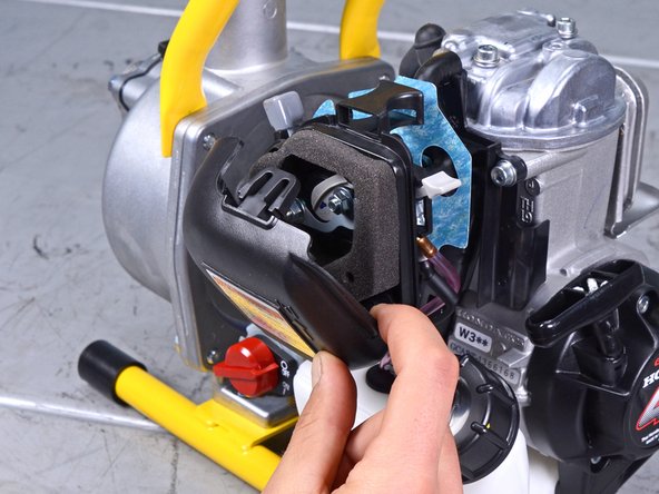

  5. Wacker Pump PG1 2014 Carburetor Replacement: crwdns2935265:05crwdnd2935265:01crwdnd2935265:03crwdne2935265:0 Wacker Pump PG1 2014 Carburetor Replacement: crwdns2935265:05crwdnd2935265:02crwdnd2935265:03crwdne2935265:0 Wacker Pump PG1 2014 Carburetor Replacement: crwdns2935265:05crwdnd2935265:03crwdnd2935265:03crwdne2935265:0
    • Tilt the unlocked air cleaner cover down and pull it away from the air box to unhook it.
    • Remove the air box cover.

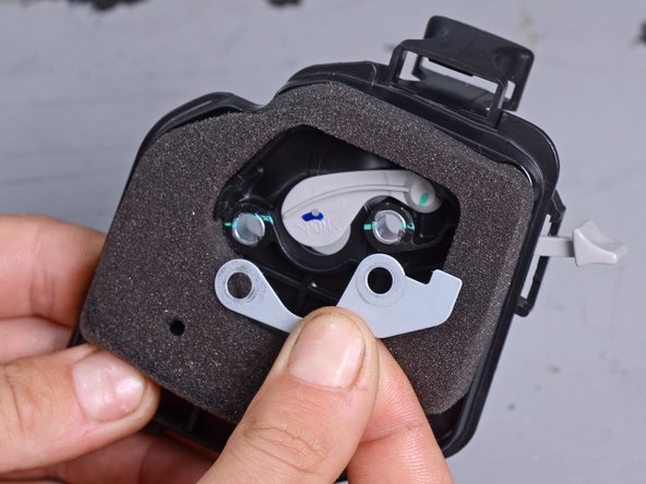

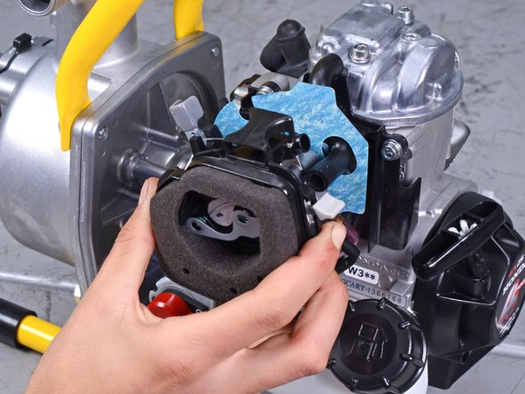

  7. Wacker Pump PG1 2014 Carburetor Replacement, Remove the air box: crwdns2935265:07crwdnd2935265:01crwdnd2935265:03crwdne2935265:0 Wacker Pump PG1 2014 Carburetor Replacement, Remove the air box: crwdns2935265:07crwdnd2935265:02crwdnd2935265:03crwdne2935265:0 Wacker Pump PG1 2014 Carburetor Replacement, Remove the air box: crwdns2935265:07crwdnd2935265:03crwdnd2935265:03crwdne2935265:0
    • Pull the air box directly away from the motor to remove it.
    • Once removed, the metal bracket inside of the air box will become loose. Don't lose it.

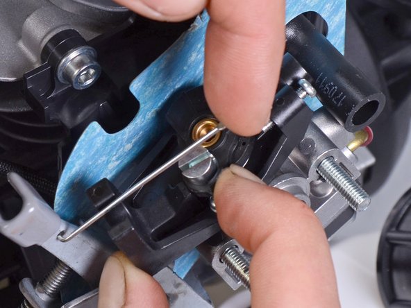

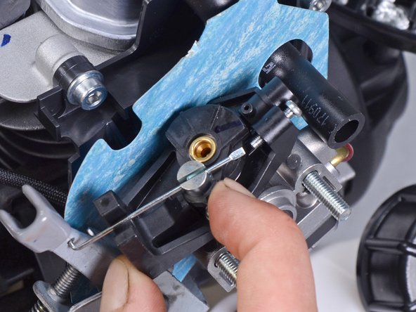

  8. Wacker Pump PG1 2014 Carburetor Replacement, Depress the throttle pulley: crwdns2935265:08crwdnd2935265:01crwdnd2935265:02crwdne2935265:0 Wacker Pump PG1 2014 Carburetor Replacement, Depress the throttle pulley: crwdns2935265:08crwdnd2935265:02crwdnd2935265:02crwdne2935265:0
    • Use your finger to pull down the spring-loaded throttle pulley.
  9. Wacker Pump PG1 2014 Carburetor Replacement, Remove the throttle linkage: crwdns2935265:09crwdnd2935265:01crwdnd2935265:02crwdne2935265:0 Wacker Pump PG1 2014 Carburetor Replacement, Remove the throttle linkage: crwdns2935265:09crwdnd2935265:02crwdnd2935265:02crwdne2935265:0
    • While pulling down on the throttle pulley, use your finger to lift the throttle linkage out of its slot on the pulley.

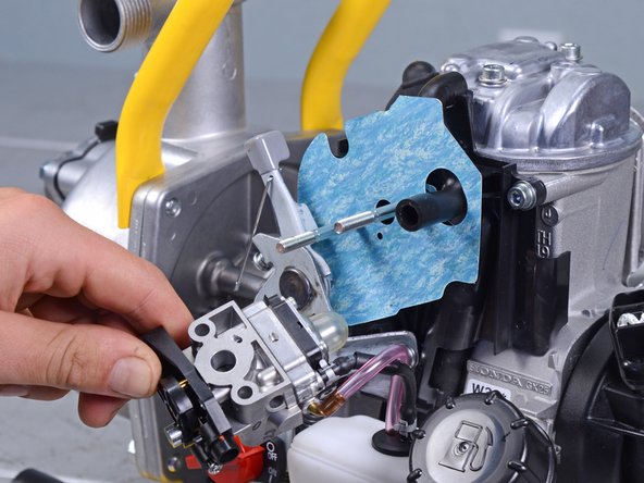

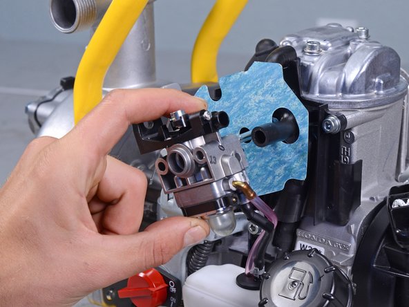

  10. Wacker Pump PG1 2014 Carburetor Replacement, Remove the carburetor from the motor: crwdns2935265:010crwdnd2935265:01crwdnd2935265:03crwdne2935265:0 Wacker Pump PG1 2014 Carburetor Replacement, Remove the carburetor from the motor: crwdns2935265:010crwdnd2935265:02crwdnd2935265:03crwdne2935265:0 Wacker Pump PG1 2014 Carburetor Replacement, Remove the carburetor from the motor: crwdns2935265:010crwdnd2935265:03crwdnd2935265:03crwdne2935265:0
    • Pull the carburetor off of the two threaded shafts.
    • The carburetor is still attached to fuel lines, so don't attempt to completely remove it yet.
    • Don't let the carburetor put tension on the fuel lines—hold onto it and continue to the next step.

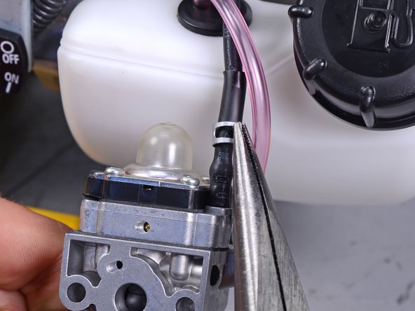

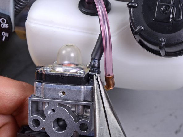

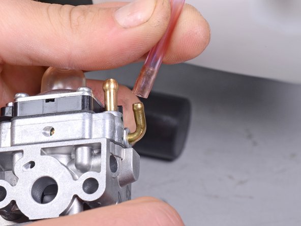

  11. Wacker Pump PG1 2014 Carburetor Replacement, Remove the fuel lines: crwdns2935265:011crwdnd2935265:01crwdnd2935265:03crwdne2935265:0 Wacker Pump PG1 2014 Carburetor Replacement, Remove the fuel lines: crwdns2935265:011crwdnd2935265:02crwdnd2935265:03crwdne2935265:0 Wacker Pump PG1 2014 Carburetor Replacement, Remove the fuel lines: crwdns2935265:011crwdnd2935265:03crwdnd2935265:03crwdne2935265:0
    • Use a pair of needle nose pliers to compress the two hose clamp tabs on the black hose.
    • While compressing the tabs, slide the hose clamp up and off of the carburetor nipple.

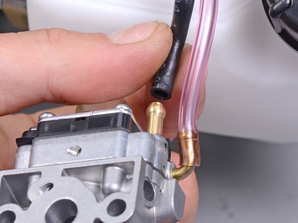

  12. Wacker Pump PG1 2014 Carburetor Replacement: crwdns2935265:012crwdnd2935265:01crwdnd2935265:02crwdne2935265:0 Wacker Pump PG1 2014 Carburetor Replacement: crwdns2935265:012crwdnd2935265:02crwdnd2935265:02crwdne2935265:0
    • Residual fuel in the carburetor or hoses may leak out during the following steps. Have shop towels or rags handy to catch any drips.
    • Use your fingers to pull the black hose off of the straight carburetor nipple.
  13. Wacker Pump PG1 2014 Carburetor Replacement: crwdns2935265:013crwdnd2935265:01crwdnd2935265:02crwdne2935265:0 Wacker Pump PG1 2014 Carburetor Replacement: crwdns2935265:013crwdnd2935265:02crwdnd2935265:02crwdne2935265:0
    • Use your fingers to pull the pink hose off of the angled carburetor nipple.
  14. Wacker Pump PG1 2014 Carburetor Replacement: crwdns2935265:014crwdnd2935265:01crwdnd2935265:01crwdne2935265:0
    • Only the carburetor remains.
