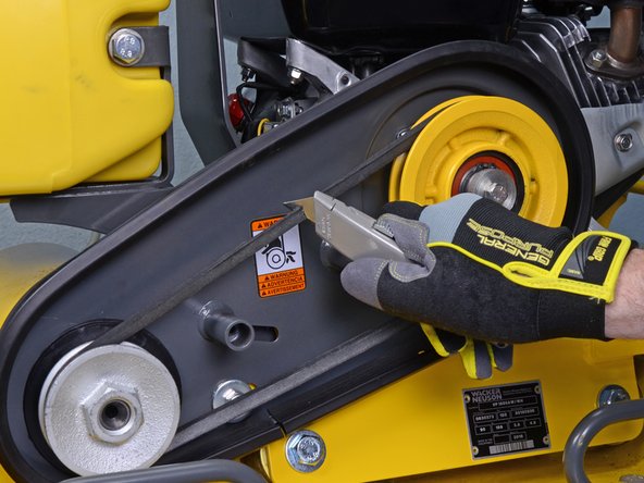

  4. Wacker Compactor Plate VP1550AW 2014 V-Belt Replacement, Remove the drive belt: crwdns2935265:04crwdnd2935265:01crwdnd2935265:03crwdne2935265:0 Wacker Compactor Plate VP1550AW 2014 V-Belt Replacement, Remove the drive belt: crwdns2935265:04crwdnd2935265:02crwdnd2935265:03crwdne2935265:0 Wacker Compactor Plate VP1550AW 2014 V-Belt Replacement, Remove the drive belt: crwdns2935265:04crwdnd2935265:03crwdnd2935265:03crwdne2935265:0
    • Use scissors or a blade to cut the drive belt.
    • Remove the drive belt.

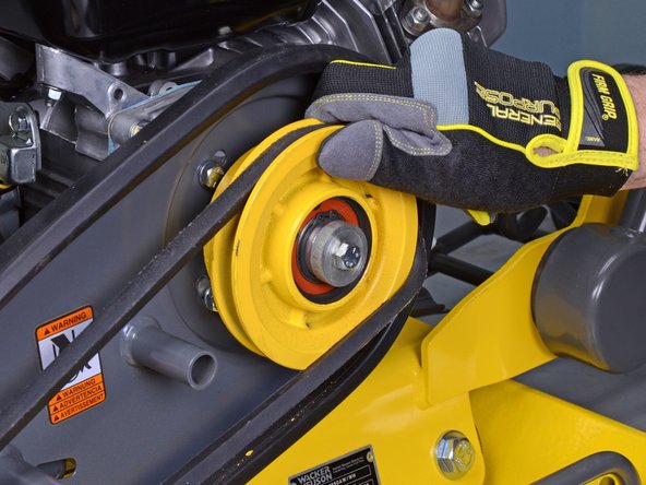

  5. Wacker Compactor Plate VP1550AW 2014 V-Belt Replacement, Install a replacement belt: crwdns2935265:05crwdnd2935265:01crwdnd2935265:01crwdne2935265:0
    • Loop the replacement belt onto the small pulley.
  6. Wacker Compactor Plate VP1550AW 2014 V-Belt Replacement: crwdns2935265:06crwdnd2935265:01crwdnd2935265:03crwdne2935265:0 Wacker Compactor Plate VP1550AW 2014 V-Belt Replacement: crwdns2935265:06crwdnd2935265:02crwdnd2935265:03crwdne2935265:0 Wacker Compactor Plate VP1550AW 2014 V-Belt Replacement: crwdns2935265:06crwdnd2935265:03crwdnd2935265:03crwdne2935265:0
    • Replacing the belt poses a substantial pinching hazard. Wear safety gloves and be mindful where you position your fingers.
    • Guide the belt over the top of the clutch pulley.
    • Loop the belt underneath the pulley axle.
    • Rotate the pulley slowly and guide the built into the groove.
    • Getting the replacement belt back onto the drive pulley requires considerable strength.
