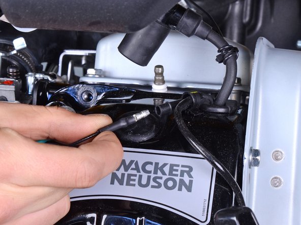

  3. Wacker 4-Stroke Rammer BS504AS REV 101 (2019) Petcock Replacement, Remove the power wire: crwdns2935265:03crwdnd2935265:01crwdnd2935265:02crwdne2935265:0 Wacker 4-Stroke Rammer BS504AS REV 101 (2019) Petcock Replacement, Remove the power wire: crwdns2935265:03crwdnd2935265:02crwdnd2935265:02crwdne2935265:0
    • Grip the throttle cable's black wire bullet connecter and pull to disconnect it from the engine.

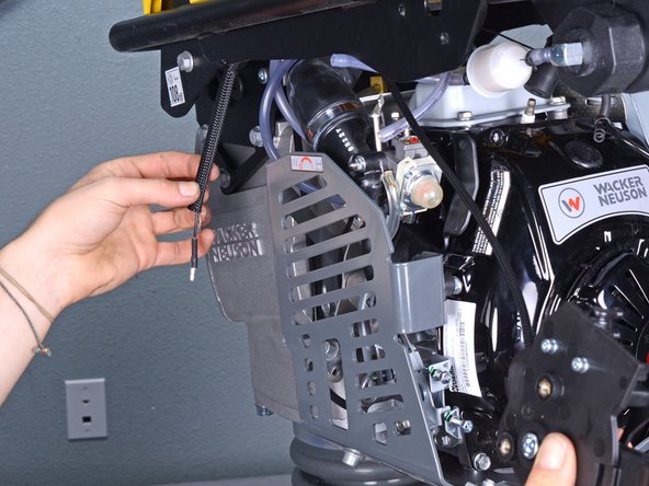

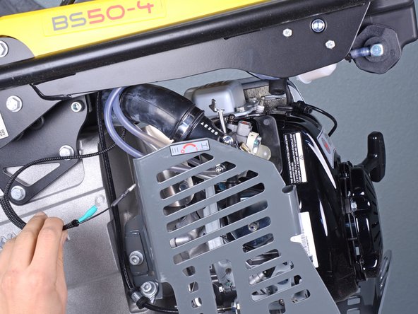

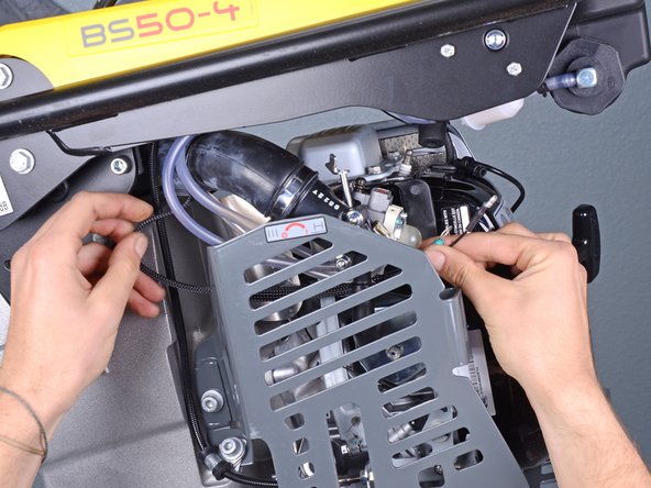

  4. Wacker 4-Stroke Rammer BS504AS REV 101 (2019) Petcock Replacement, De-route the wires: crwdns2935265:04crwdnd2935265:01crwdnd2935265:03crwdne2935265:0 Wacker 4-Stroke Rammer BS504AS REV 101 (2019) Petcock Replacement, De-route the wires: crwdns2935265:04crwdnd2935265:02crwdnd2935265:03crwdne2935265:0 Wacker 4-Stroke Rammer BS504AS REV 101 (2019) Petcock Replacement, De-route the wires: crwdns2935265:04crwdnd2935265:03crwdnd2935265:03crwdne2935265:0
    • Grab both ends of the throttle wires and feed them out, past the metal engine guard.

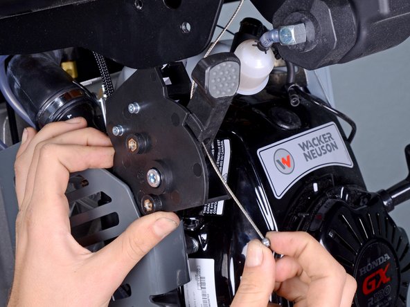

    • Move the throttle lever all the way into the SLOW position, towards the front of the device, to loosen tension on the throttle cable.

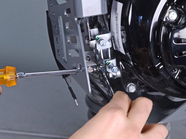

  7. Wacker 4-Stroke Rammer BS504AS REV 101 (2019) Petcock Replacement, Remove the throttle cable screw: crwdns2935265:07crwdnd2935265:01crwdnd2935265:02crwdne2935265:0 Wacker 4-Stroke Rammer BS504AS REV 101 (2019) Petcock Replacement, Remove the throttle cable screw: crwdns2935265:07crwdnd2935265:02crwdnd2935265:02crwdne2935265:0
    • Use a Phillips driver to remove the screw securing the throttle cable to the actuator arm on the motor.
    • You may need to use a 10 mm wrench to hold the nut in place as you remove the screw.

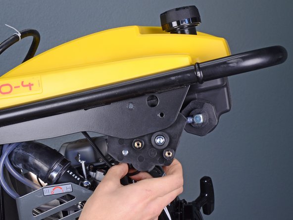

  8. Wacker 4-Stroke Rammer BS504AS REV 101 (2019) Petcock Replacement, Remove the throttle assembly bolts: crwdns2935265:08crwdnd2935265:01crwdnd2935265:01crwdne2935265:0
    • Use an 8 mm socket to remove the two bolts securing the throttle assembly to the frame.
  9. Wacker 4-Stroke Rammer BS504AS REV 101 (2019) Petcock Replacement, Lower the throttle assembly: crwdns2935265:09crwdnd2935265:01crwdnd2935265:02crwdne2935265:0 Wacker 4-Stroke Rammer BS504AS REV 101 (2019) Petcock Replacement, Lower the throttle assembly: crwdns2935265:09crwdnd2935265:02crwdnd2935265:02crwdne2935265:0
    • Grip the throttle assembly from underneath and lower it down through its cutout in the frame.
    • Don't attempt to fully remove the throttle assembly yet. Let the assembly hang in place.

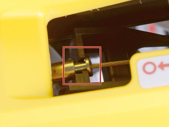

  10. Wacker 4-Stroke Rammer BS504AS REV 101 (2019) Petcock Replacement, Remove the throttle cable: crwdns2935265:010crwdnd2935265:01crwdnd2935265:03crwdne2935265:0 Wacker 4-Stroke Rammer BS504AS REV 101 (2019) Petcock Replacement, Remove the throttle cable: crwdns2935265:010crwdnd2935265:02crwdnd2935265:03crwdne2935265:0 Wacker 4-Stroke Rammer BS504AS REV 101 (2019) Petcock Replacement, Remove the throttle cable: crwdns2935265:010crwdnd2935265:03crwdnd2935265:03crwdne2935265:0
    • Holding the throttle assembly in place, pull the throttle cable through the hole on the throttle lever.
    • Remove the throttle cable.
    • During reassembly, be careful not to fray the throttle cable tip, or you won't be able to install the cable.
    • During reassembly, ensure the throttle cable guide shoulder is fully recessed into its section on the throttle assembly.

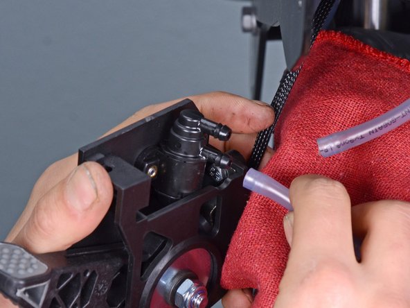

  11. Wacker 4-Stroke Rammer BS504AS REV 101 (2019) Petcock Replacement, Prepare for fuel drips and spills: crwdns2935265:011crwdnd2935265:01crwdnd2935265:01crwdne2935265:0
    • Place a rag or shop towel underneath the petcock fuel lines to prevent drips and spills from getting on the device.

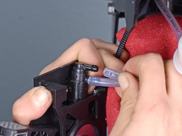

  12. Wacker 4-Stroke Rammer BS504AS REV 101 (2019) Petcock Replacement, Remove the fuel tubes: crwdns2935265:012crwdnd2935265:01crwdnd2935265:03crwdne2935265:0 Wacker 4-Stroke Rammer BS504AS REV 101 (2019) Petcock Replacement, Remove the fuel tubes: crwdns2935265:012crwdnd2935265:02crwdnd2935265:03crwdne2935265:0 Wacker 4-Stroke Rammer BS504AS REV 101 (2019) Petcock Replacement, Remove the fuel tubes: crwdns2935265:012crwdnd2935265:03crwdnd2935265:03crwdne2935265:0
    • Grip one of the clear fuel tubes near where it connects to the petcock and squeeze it completely closed.
    • Pull the tube directly away from the petcock nipple to remove it.
    • This may require some force due to suction within the tubes.
    • Use a pick tool to lift one end of the tube up to break suction if needed.
    • Residual fuel in the fuel lines may leak out after the tube is removed.
    • Disconnect the second fuel tube from the petcock.
  13. Wacker 4-Stroke Rammer BS504AS REV 101 (2019) Petcock Replacement, Remove the throttle assembly: crwdns2935265:013crwdnd2935265:01crwdnd2935265:03crwdne2935265:0 Wacker 4-Stroke Rammer BS504AS REV 101 (2019) Petcock Replacement, Remove the throttle assembly: crwdns2935265:013crwdnd2935265:02crwdnd2935265:03crwdne2935265:0 Wacker 4-Stroke Rammer BS504AS REV 101 (2019) Petcock Replacement, Remove the throttle assembly: crwdns2935265:013crwdnd2935265:03crwdnd2935265:03crwdne2935265:0
    • Thread the throttle wires out from underneath the metal engine guard.
    • Remove the throttle assembly.
    • Only the throttle assembly remains.

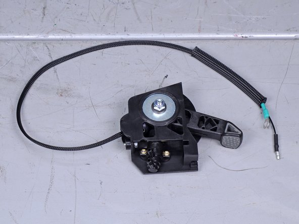

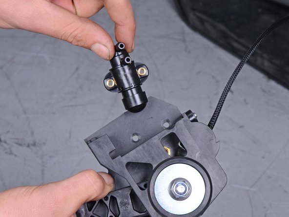

  14. Wacker 4-Stroke Rammer BS504AS REV 101 (2019) Petcock Replacement, Remove the petcock bolts: crwdns2935265:014crwdnd2935265:01crwdnd2935265:01crwdne2935265:0
    • Use a 3 mm hex key to remove the two bolts securing the petcock to the throttle assembly.
  15. Wacker 4-Stroke Rammer BS504AS REV 101 (2019) Petcock Replacement, Remove the petcock: crwdns2935265:015crwdnd2935265:01crwdnd2935265:02crwdne2935265:0 Wacker 4-Stroke Rammer BS504AS REV 101 (2019) Petcock Replacement, Remove the petcock: crwdns2935265:015crwdnd2935265:02crwdnd2935265:02crwdne2935265:0
    • Remove the petcock.
