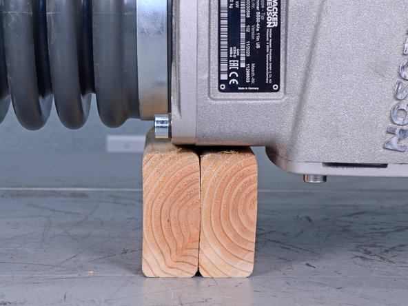

  5. Wacker 4-Stroke Rammer BS504AS REV 101 (2019) Clutch Drum Replacement, Support the device: crwdns2935265:05crwdnd2935265:01crwdnd2935265:02crwdne2935265:0 Wacker 4-Stroke Rammer BS504AS REV 101 (2019) Clutch Drum Replacement, Support the device: crwdns2935265:05crwdnd2935265:02crwdnd2935265:02crwdne2935265:0
    • Flip the device onto the work surface such that the motor and handles face up.
    • Place two separate blocks of wood underneath the seam between the leg assembly and crankcase.
    • Once the two halves separate, each side will need to be supported.

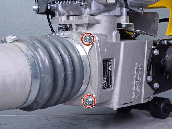

  6. Wacker 4-Stroke Rammer BS504AS REV 101 (2019) Clutch Drum Replacement, Remove the leg assembly bolts: crwdns2935265:06crwdnd2935265:01crwdnd2935265:02crwdne2935265:0 Wacker 4-Stroke Rammer BS504AS REV 101 (2019) Clutch Drum Replacement, Remove the leg assembly bolts: crwdns2935265:06crwdnd2935265:02crwdnd2935265:02crwdne2935265:0
    • Use an 8 mm hex key socket to remove the four bolts securing the leg's guiding cylinder to the crankcase.
    • You may need to use an impact driver or breaker bar to break these bolts loose.
    • During reassembly, ensure each bolt has its accompanying lock washer.

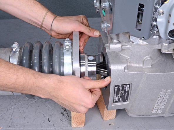

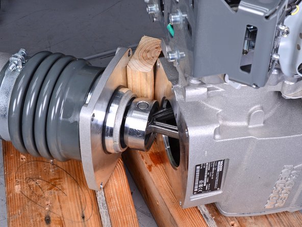

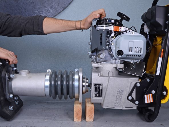

  7. Wacker 4-Stroke Rammer BS504AS REV 101 (2019) Clutch Drum Replacement, Begin to separate the halves: crwdns2935265:07crwdnd2935265:01crwdnd2935265:02crwdne2935265:0 Wacker 4-Stroke Rammer BS504AS REV 101 (2019) Clutch Drum Replacement, Begin to separate the halves: crwdns2935265:07crwdnd2935265:02crwdnd2935265:02crwdne2935265:0
    • Pull the leg assembly away from the rest of the device.
    • Ensure each half stays adequately supported.

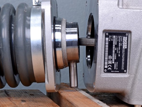

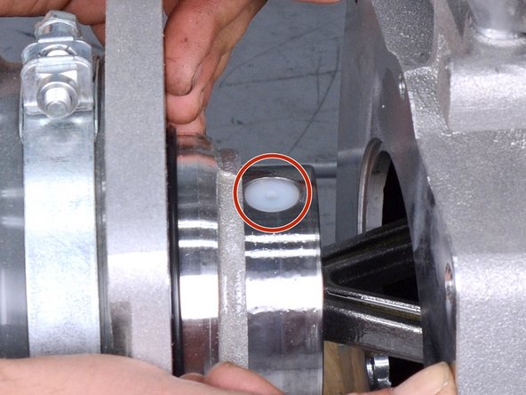

  8. Wacker 4-Stroke Rammer BS504AS REV 101 (2019) Clutch Drum Replacement, Reveal the pin: crwdns2935265:08crwdnd2935265:01crwdnd2935265:03crwdne2935265:0 Wacker 4-Stroke Rammer BS504AS REV 101 (2019) Clutch Drum Replacement, Reveal the pin: crwdns2935265:08crwdnd2935265:02crwdnd2935265:03crwdne2935265:0 Wacker 4-Stroke Rammer BS504AS REV 101 (2019) Clutch Drum Replacement, Reveal the pin: crwdns2935265:08crwdnd2935265:03crwdnd2935265:03crwdne2935265:0
    • Continue to separate the two halves by compressing the bellows until the nylon plug covering the piston pin is visible.
  9. Wacker 4-Stroke Rammer BS504AS REV 101 (2019) Clutch Drum Replacement, Procedure tip: crwdns2935265:09crwdnd2935265:01crwdnd2935265:02crwdne2935265:0 Wacker 4-Stroke Rammer BS504AS REV 101 (2019) Clutch Drum Replacement, Procedure tip: crwdns2935265:09crwdnd2935265:02crwdnd2935265:02crwdne2935265:0
    • Tip: To compress the bellows, insert a block of wood between the two halves and pivot the leg assembly off of the crankcase to compress the guide cylinder, revealing the pin.

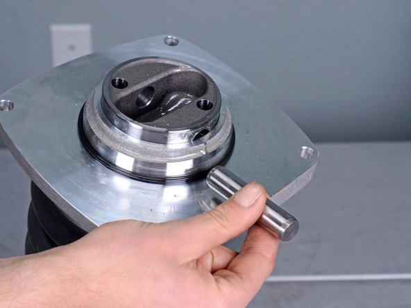

  10. Wacker 4-Stroke Rammer BS504AS REV 101 (2019) Clutch Drum Replacement, Remove the pin: crwdns2935265:010crwdnd2935265:01crwdnd2935265:03crwdne2935265:0 Wacker 4-Stroke Rammer BS504AS REV 101 (2019) Clutch Drum Replacement, Remove the pin: crwdns2935265:010crwdnd2935265:02crwdnd2935265:03crwdne2935265:0 Wacker 4-Stroke Rammer BS504AS REV 101 (2019) Clutch Drum Replacement, Remove the pin: crwdns2935265:010crwdnd2935265:03crwdnd2935265:03crwdne2935265:0
    • Use an appropriately-sized punch and a ball-peen hammer to tap the pin out of its hole on the guide piston until it is no longer securing the connecting rod.
    • Once the piston and connecting rod are separated, the two halves become completely disconnected and will need to be adequately supported.
    • During reassembly, ensure that both nylon plugs are reinstalled and are flush with the surface of the guide piston.

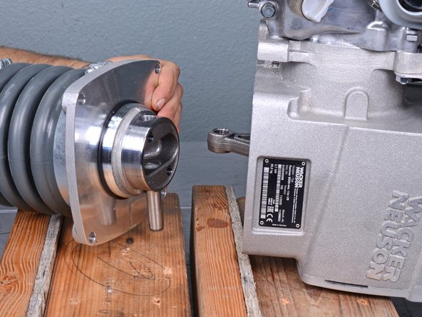

  11. Wacker 4-Stroke Rammer BS504AS REV 101 (2019) Clutch Drum Replacement, Remove the leg assembly: crwdns2935265:011crwdnd2935265:01crwdnd2935265:02crwdne2935265:0 Wacker 4-Stroke Rammer BS504AS REV 101 (2019) Clutch Drum Replacement, Remove the leg assembly: crwdns2935265:011crwdnd2935265:02crwdnd2935265:02crwdne2935265:0
    • Remove the leg assembly from the crankcase.

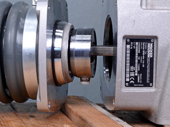

  12. Wacker 4-Stroke Rammer BS504AS REV 101 (2019) Clutch Drum Replacement, Completely remove the pin: crwdns2935265:012crwdnd2935265:01crwdnd2935265:02crwdne2935265:0 Wacker 4-Stroke Rammer BS504AS REV 101 (2019) Clutch Drum Replacement, Completely remove the pin: crwdns2935265:012crwdnd2935265:02crwdnd2935265:02crwdne2935265:0
    • Use a punch and hammer to tap the pin out of the guide piston.
    • Once the pin is removed, the guide cylinder may spring up due to the compression of the bellows.
    • During reassembly, the bellows will need to be compressed to uncover the pin hole on the guide piston.

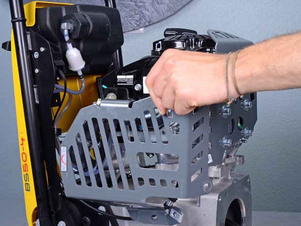

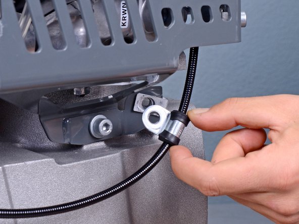

  14. Wacker 4-Stroke Rammer BS504AS REV 101 (2019) Clutch Drum Replacement, Remove the engine guard: crwdns2935265:014crwdnd2935265:01crwdnd2935265:01crwdne2935265:0
    • Use a 6 mm hex socket to remove the engine guard bolt securing the cable guide.
  15. Wacker 4-Stroke Rammer BS504AS REV 101 (2019) Clutch Drum Replacement: crwdns2935265:015crwdnd2935265:01crwdnd2935265:02crwdne2935265:0 Wacker 4-Stroke Rammer BS504AS REV 101 (2019) Clutch Drum Replacement: crwdns2935265:015crwdnd2935265:02crwdnd2935265:02crwdne2935265:0
    • Pull the cable guide away from the engine guard.
  16. Wacker 4-Stroke Rammer BS504AS REV 101 (2019) Clutch Drum Replacement: crwdns2935265:016crwdnd2935265:01crwdnd2935265:02crwdne2935265:0 Wacker 4-Stroke Rammer BS504AS REV 101 (2019) Clutch Drum Replacement: crwdns2935265:016crwdnd2935265:02crwdnd2935265:02crwdne2935265:0
    • Use a 6 mm hex socket to remove the three remaining bolts securing the engine guard: two on the outer edge and one near the crankcase.
  17. Wacker 4-Stroke Rammer BS504AS REV 101 (2019) Clutch Drum Replacement: crwdns2935265:017crwdnd2935265:01crwdnd2935265:02crwdne2935265:0 Wacker 4-Stroke Rammer BS504AS REV 101 (2019) Clutch Drum Replacement: crwdns2935265:017crwdnd2935265:02crwdnd2935265:02crwdne2935265:0
    • Remove the engine guard.

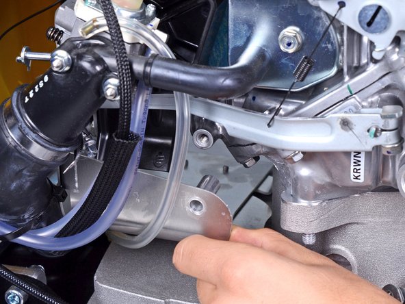

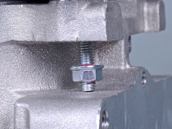

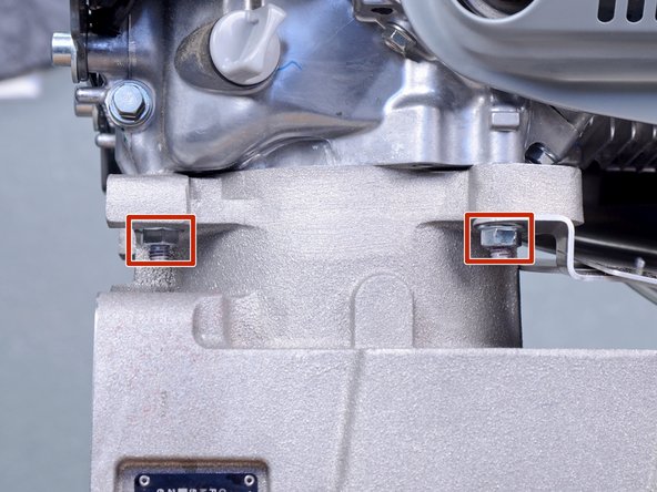

  18. Wacker 4-Stroke Rammer BS504AS REV 101 (2019) Clutch Drum Replacement, Remove the motor nuts: crwdns2935265:018crwdnd2935265:01crwdnd2935265:03crwdne2935265:0 Wacker 4-Stroke Rammer BS504AS REV 101 (2019) Clutch Drum Replacement, Remove the motor nuts: crwdns2935265:018crwdnd2935265:02crwdnd2935265:03crwdne2935265:0 Wacker 4-Stroke Rammer BS504AS REV 101 (2019) Clutch Drum Replacement, Remove the motor nuts: crwdns2935265:018crwdnd2935265:03crwdnd2935265:03crwdne2935265:0
    • Use a 13 mm wrench to remove the four nuts securing the motor to the crankcase, two on each side.
    • When removing the nuts, the crankcase bolts may also become unthreaded, preventing its accompanying nut from being removed. This is fine.

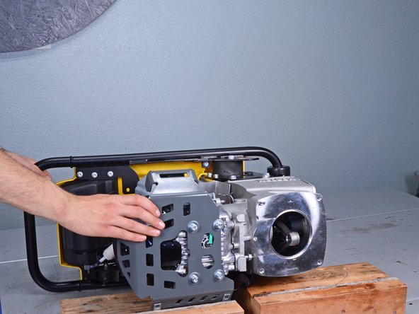

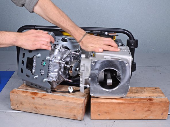

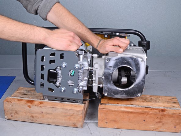

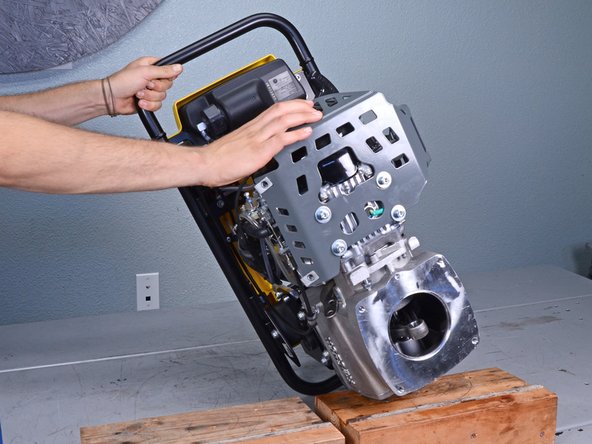

  21. Wacker 4-Stroke Rammer BS504AS REV 101 (2019) Clutch Drum Replacement, Separate the motor from the crankcase: crwdns2935265:021crwdnd2935265:01crwdnd2935265:03crwdne2935265:0 Wacker 4-Stroke Rammer BS504AS REV 101 (2019) Clutch Drum Replacement, Separate the motor from the crankcase: crwdns2935265:021crwdnd2935265:02crwdnd2935265:03crwdne2935265:0 Wacker 4-Stroke Rammer BS504AS REV 101 (2019) Clutch Drum Replacement, Separate the motor from the crankcase: crwdns2935265:021crwdnd2935265:03crwdnd2935265:03crwdne2935265:0
    • Tilt the device down onto its side, supporting both the crankcase and motor with blocks of wood.
    • The motor is loose from the crankcase, so support the motor as you lower the device down.
  22. Wacker 4-Stroke Rammer BS504AS REV 101 (2019) Clutch Drum Replacement: crwdns2935265:022crwdnd2935265:01crwdnd2935265:03crwdne2935265:0 Wacker 4-Stroke Rammer BS504AS REV 101 (2019) Clutch Drum Replacement: crwdns2935265:022crwdnd2935265:02crwdnd2935265:03crwdne2935265:0 Wacker 4-Stroke Rammer BS504AS REV 101 (2019) Clutch Drum Replacement: crwdns2935265:022crwdnd2935265:03crwdnd2935265:03crwdne2935265:0
    • Hold the crankcase steady and pull the motor directly away from it.
    • The motor is still attached to the rest of the device via various hoses and cables, so don't attempt to completely remove it.

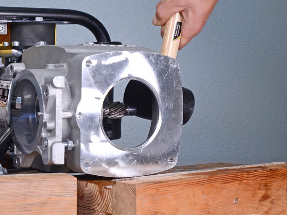

  23. Wacker 4-Stroke Rammer BS504AS REV 101 (2019) Clutch Drum Replacement, Remove the crankcase cover bolts: crwdns2935265:023crwdnd2935265:01crwdnd2935265:01crwdne2935265:0
    • Use an 8 mm hex socket to remove the four bolts securing the crankcase cover.

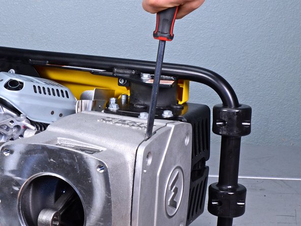

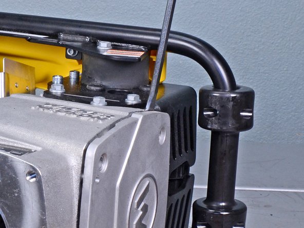

  24. Wacker 4-Stroke Rammer BS504AS REV 101 (2019) Clutch Drum Replacement, Separate the crankcase cover from the crankcase: crwdns2935265:024crwdnd2935265:01crwdnd2935265:03crwdne2935265:0 Wacker 4-Stroke Rammer BS504AS REV 101 (2019) Clutch Drum Replacement, Separate the crankcase cover from the crankcase: crwdns2935265:024crwdnd2935265:02crwdnd2935265:03crwdne2935265:0 Wacker 4-Stroke Rammer BS504AS REV 101 (2019) Clutch Drum Replacement, Separate the crankcase cover from the crankcase: crwdns2935265:024crwdnd2935265:03crwdnd2935265:03crwdne2935265:0
    • Any excess oil that did not drain out of the drain plug may leak out here. Be prepared with a shop rag or shop towel to catch any drips.
    • Insert a flathead screwdriver into one of the side gaps between the crankcase cover and the crankcase.
    • Twist the screwdriver to begin to pull the crankcase cover away from the crankcase.
    • Repeat for the opposite side gap, and repeat until the crankcase cover comes loose from the crankcase.
    • During reassembly, check that the crankcase cover O-ring is in good condition, and replace it if it is cracked or deformed.

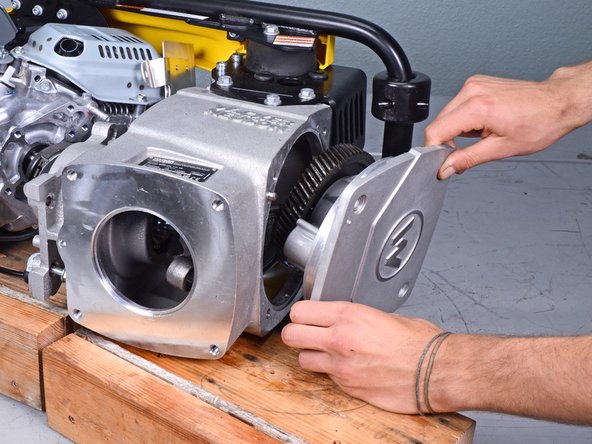

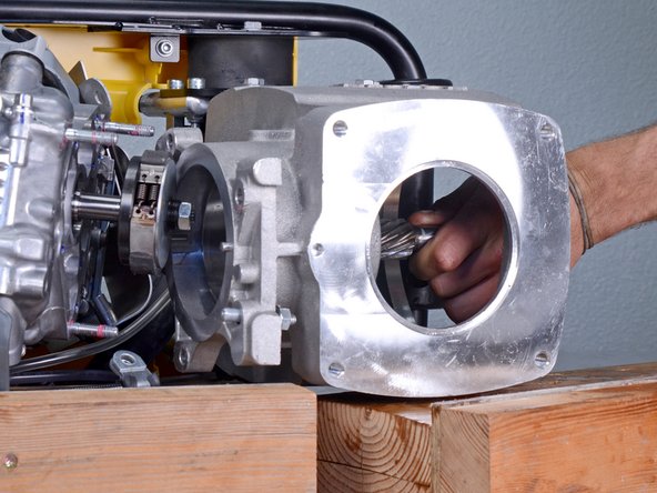

  25. Wacker 4-Stroke Rammer BS504AS REV 101 (2019) Clutch Drum Replacement, Remove the crankcase cover: crwdns2935265:025crwdnd2935265:01crwdnd2935265:03crwdne2935265:0 Wacker 4-Stroke Rammer BS504AS REV 101 (2019) Clutch Drum Replacement, Remove the crankcase cover: crwdns2935265:025crwdnd2935265:02crwdnd2935265:03crwdne2935265:0 Wacker 4-Stroke Rammer BS504AS REV 101 (2019) Clutch Drum Replacement, Remove the crankcase cover: crwdns2935265:025crwdnd2935265:03crwdnd2935265:03crwdne2935265:0
    • Use your fingers to pull the crankcase cover off of the crankcase.
    • Feed the connecting rod around the clutch drum shaft and out through the crankcase cover hole.
    • During reassembly, feed the connecting rod around the clutch drum shaft and ensure the helical gears fully mesh.

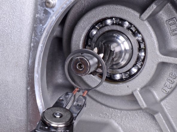

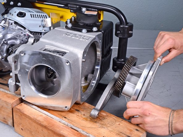

  26. Wacker 4-Stroke Rammer BS504AS REV 101 (2019) Clutch Drum Replacement, Remove the clutch drum snap ring: crwdns2935265:026crwdnd2935265:01crwdnd2935265:02crwdne2935265:0 Wacker 4-Stroke Rammer BS504AS REV 101 (2019) Clutch Drum Replacement, Remove the clutch drum snap ring: crwdns2935265:026crwdnd2935265:02crwdnd2935265:02crwdne2935265:0
    • Use a pair of snap ring pliers to remove the snap ring securing the clutch drum to the crankcase bearing assembly.
    • During reassembly, ensure the clutch drum shaft is fully seated in the bearing assembly before attempting to reinstall the snap ring.

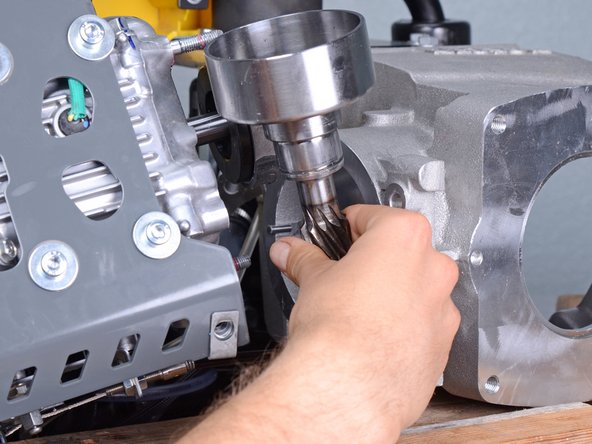

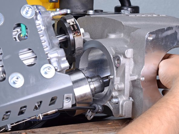

  27. Wacker 4-Stroke Rammer BS504AS REV 101 (2019) Clutch Drum Replacement, Tap out the clutch drum: crwdns2935265:027crwdnd2935265:01crwdnd2935265:03crwdne2935265:0 Wacker 4-Stroke Rammer BS504AS REV 101 (2019) Clutch Drum Replacement, Tap out the clutch drum: crwdns2935265:027crwdnd2935265:02crwdnd2935265:03crwdne2935265:0 Wacker 4-Stroke Rammer BS504AS REV 101 (2019) Clutch Drum Replacement, Tap out the clutch drum: crwdns2935265:027crwdnd2935265:03crwdnd2935265:03crwdne2935265:0
    • Use a rubber mallet to tap the end of the clutch drum shaft through its hole on the top of the crankcase until it becomes loose enough to be moved by hand.
    • During reassembly, reseat the clutch drum into the bearing assembly by tapping it by the drum end.
    • Oil the new clutch drum shaft to ease installation.
  28. Wacker 4-Stroke Rammer BS504AS REV 101 (2019) Clutch Drum Replacement, Remove the clutch drum: crwdns2935265:028crwdnd2935265:01crwdnd2935265:03crwdne2935265:0 Wacker 4-Stroke Rammer BS504AS REV 101 (2019) Clutch Drum Replacement, Remove the clutch drum: crwdns2935265:028crwdnd2935265:02crwdnd2935265:03crwdne2935265:0 Wacker 4-Stroke Rammer BS504AS REV 101 (2019) Clutch Drum Replacement, Remove the clutch drum: crwdns2935265:028crwdnd2935265:03crwdnd2935265:03crwdne2935265:0
    • Push the clutch drum shaft with your fingers until it can be gripped from the top of the crankcase.
    • Since the motor is still connected to the crankcase, you may need to shift the motor's position on the wood blocks in order to fully remove the clutch drum.
    • Remove the clutch drum.
After reassembly, tilt the device upright and check the oil level through the sight glass. The oil should cover 1/2 to 3/4 of the sight glass to be considered full. This model requires up to 0.7 liters of SAE 10W-40 oil.
