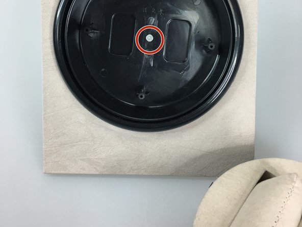

WWB222324 Watch Winder Motor Replacement
  1. WWB222324 Watch Winder Motor Replacement, Motor: crwdns2935265:01crwdnd2935265:01crwdnd2935265:01crwdne2935265:0
    • Turn the winder off
    • Unplug the power cord
  2. WWB222324 Watch Winder Motor Replacement: crwdns2935265:02crwdnd2935265:01crwdnd2935265:02crwdne2935265:0 WWB222324 Watch Winder Motor Replacement: crwdns2935265:02crwdnd2935265:02crwdnd2935265:02crwdne2935265:0
    • Pull angled turntable platform toward you by upper seam
  3. WWB222324 Watch Winder Motor Replacement: crwdns2935265:03crwdnd2935265:01crwdnd2935265:01crwdne2935265:0
    • Unplug motor connection cable from circuit board
  4. WWB222324 Watch Winder Motor Replacement: crwdns2935265:04crwdnd2935265:01crwdnd2935265:02crwdne2935265:0 WWB222324 Watch Winder Motor Replacement: crwdns2935265:04crwdnd2935265:02crwdnd2935265:02crwdne2935265:0
    • Unscrew two retaining screws from gearbox
    • Remove round watch insert
    • Unscrew single retaining screw from cup
  5. WWB222324 Watch Winder Motor Replacement: crwdns2935265:05crwdnd2935265:01crwdnd2935265:01crwdne2935265:0
    • Pull gearbox and motor out from back of the turntable platform
    • Follow steps in reverse order to replace motor
