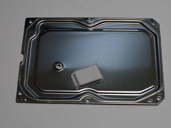

  4. WD Blue Hard Drive Teardown, Removing top cover: crwdns2935265:04crwdnd2935265:01crwdnd2935265:03crwdne2935265:0 WD Blue Hard Drive Teardown, Removing top cover: crwdns2935265:04crwdnd2935265:02crwdnd2935265:03crwdne2935265:0 WD Blue Hard Drive Teardown, Removing top cover: crwdns2935265:04crwdnd2935265:03crwdnd2935265:03crwdne2935265:0
    • Remove 6 perimeter screws
    • Remove screw from under sticker
    • Lift cover off

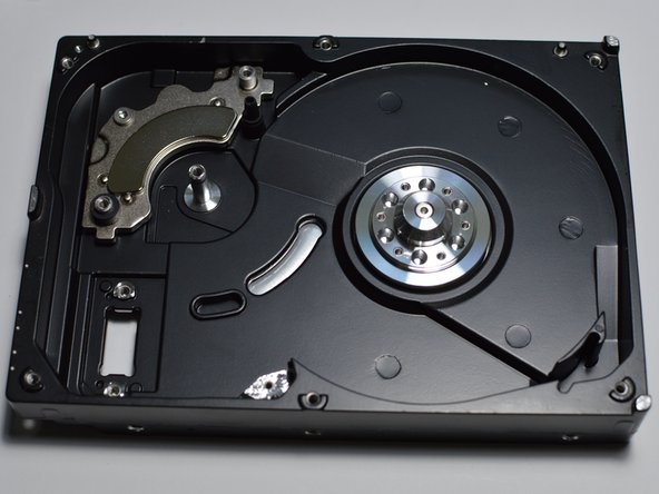

  5. WD Blue Hard Drive Teardown, Inside details: crwdns2935265:05crwdnd2935265:01crwdnd2935265:03crwdne2935265:0 WD Blue Hard Drive Teardown, Inside details: crwdns2935265:05crwdnd2935265:02crwdnd2935265:03crwdne2935265:0 WD Blue Hard Drive Teardown, Inside details: crwdns2935265:05crwdnd2935265:03crwdnd2935265:03crwdne2935265:0
    • Inside of hard drive
    • Desiccant packet removed from lower right corner
    • Inside of cover

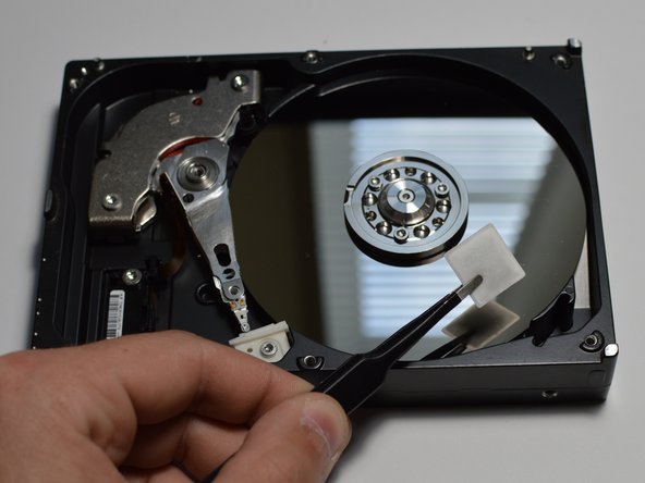

  6. WD Blue Hard Drive Teardown, Head details and dock removal: crwdns2935265:06crwdnd2935265:01crwdnd2935265:03crwdne2935265:0 WD Blue Hard Drive Teardown, Head details and dock removal: crwdns2935265:06crwdnd2935265:02crwdnd2935265:03crwdne2935265:0 WD Blue Hard Drive Teardown, Head details and dock removal: crwdns2935265:06crwdnd2935265:03crwdnd2935265:03crwdne2935265:0
    • Head in dock
    • Head on disk
    • Dock removed

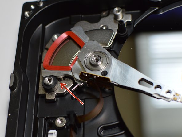

  8. WD Blue Hard Drive Teardown, Head travel limits: crwdns2935265:08crwdnd2935265:01crwdnd2935265:02crwdne2935265:0 WD Blue Hard Drive Teardown, Head travel limits: crwdns2935265:08crwdnd2935265:02crwdnd2935265:02crwdne2935265:0
    • Stops to limit head travel
    • Red coil over magnet cause the head to rotate

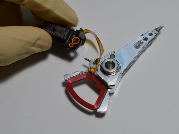

    • Contact block installed
    • Remove two screws, contact block is now loose but connected to head by a ribbon cable

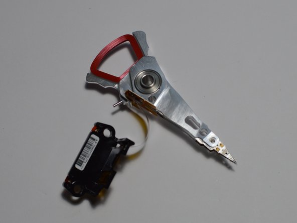

  12. WD Blue Hard Drive Teardown, Head removal p2: crwdns2935265:012crwdnd2935265:01crwdnd2935265:03crwdne2935265:0 WD Blue Hard Drive Teardown, Head removal p2: crwdns2935265:012crwdnd2935265:02crwdnd2935265:03crwdne2935265:0 WD Blue Hard Drive Teardown, Head removal p2: crwdns2935265:012crwdnd2935265:03crwdnd2935265:03crwdne2935265:0
    • Head installed, simply lift head out of case
    • Remove head
    • Case without head

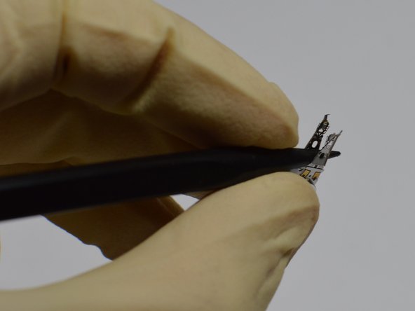

  13. WD Blue Hard Drive Teardown, Head details: crwdns2935265:013crwdnd2935265:01crwdnd2935265:03crwdne2935265:0 WD Blue Hard Drive Teardown, Head details: crwdns2935265:013crwdnd2935265:02crwdnd2935265:03crwdne2935265:0 WD Blue Hard Drive Teardown, Head details: crwdns2935265:013crwdnd2935265:03crwdnd2935265:03crwdne2935265:0
    • Removed head
    • Contacts for data and head control
    • Head interface to disk
  14. WD Blue Hard Drive Teardown, Empty case: crwdns2935265:014crwdnd2935265:01crwdnd2935265:02crwdne2935265:0 WD Blue Hard Drive Teardown, Empty case: crwdns2935265:014crwdnd2935265:02crwdnd2935265:02crwdne2935265:0
    • Remove magnet
    • Remove stop for head on disk
    • Remove head docked stop

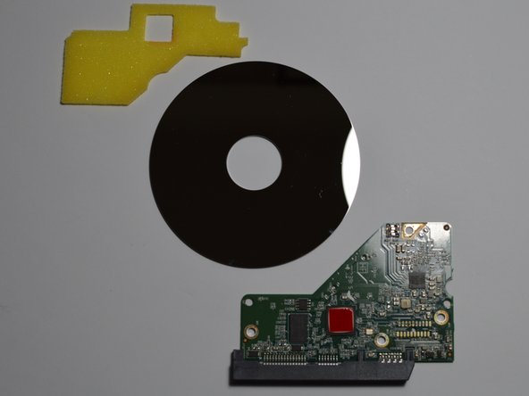

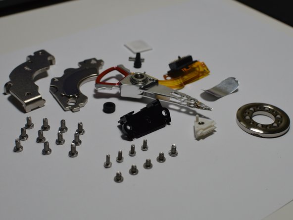

  15. WD Blue Hard Drive Teardown, Components laid out: crwdns2935265:015crwdnd2935265:01crwdnd2935265:03crwdne2935265:0 WD Blue Hard Drive Teardown, Components laid out: crwdns2935265:015crwdnd2935265:02crwdnd2935265:03crwdne2935265:0 WD Blue Hard Drive Teardown, Components laid out: crwdns2935265:015crwdnd2935265:03crwdnd2935265:03crwdne2935265:0
    • All components arranged

Well done Wieli! Your photographs are very clear and well lighted. Should you decide to edit the guide may I suggest (1) you add what screwdriver tips you used to remove screws and (2) at step 10, highlight the three screws. The screw tips blend in with the collar.
