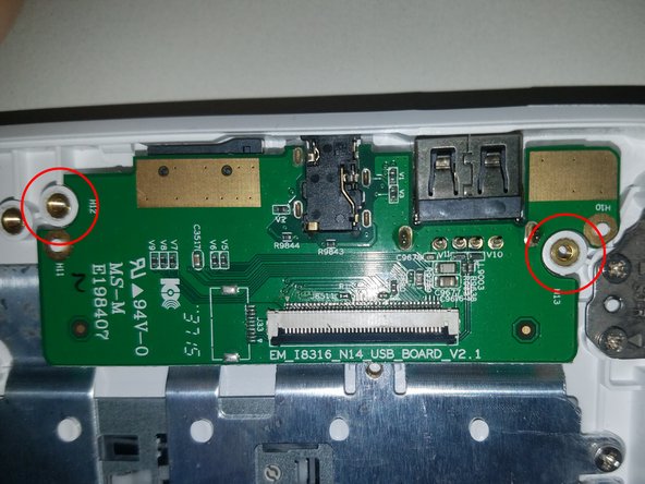

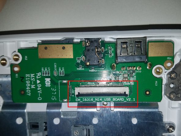

  3. Vulcan Venture II VNB14002IE I/O Board Replacement, I/O Board: crwdns2935265:03crwdnd2935265:01crwdnd2935265:01crwdne2935265:0
    • Locate the IO board on the back panel.
  4. Vulcan Venture II VNB14002IE I/O Board Replacement: crwdns2935265:04crwdnd2935265:01crwdnd2935265:02crwdne2935265:0 Vulcan Venture II VNB14002IE I/O Board Replacement: crwdns2935265:04crwdnd2935265:02crwdnd2935265:02crwdne2935265:0
    • Locate the ribbon connector on the IO board, and lift the black bar closest the the ribbon.
    • Pull the ribbon cable away from the connector, releasing it.
  5. Vulcan Venture II VNB14002IE I/O Board Replacement: crwdns2935265:05crwdnd2935265:01crwdnd2935265:02crwdne2935265:0 Vulcan Venture II VNB14002IE I/O Board Replacement: crwdns2935265:05crwdnd2935265:02crwdnd2935265:02crwdne2935265:0
    • Locate the screws on the IO panel, and use the J00+ bit to unscrew them.
  6. Vulcan Venture II VNB14002IE I/O Board Replacement: crwdns2935265:06crwdnd2935265:01crwdnd2935265:01crwdne2935265:0
    • The IO Board is now safe to remove from the computer.
