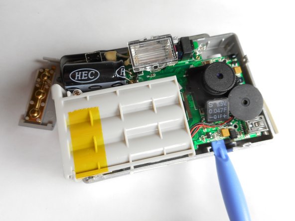

  4. VuPoint DC-ST210-VP Shutter Button Replacement, Remove Circuit Board: crwdns2935265:04crwdnd2935265:01crwdnd2935265:02crwdne2935265:0 VuPoint DC-ST210-VP Shutter Button Replacement, Remove Circuit Board: crwdns2935265:04crwdnd2935265:02crwdnd2935265:02crwdne2935265:0
    • With the back plate off, use a screw driver to remove the 6 screws shown to the left.
    • Gently separate the circuit board from frame, by prying the circuit board from base.

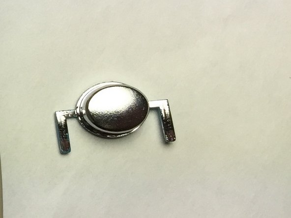

  5. VuPoint DC-ST210-VP Shutter Button Replacement, Move Plastic Protector: crwdns2935265:05crwdnd2935265:01crwdnd2935265:01crwdne2935265:0
    • Using your finger rotate the dark grey piece away from the shutter button.
  6. VuPoint DC-ST210-VP Shutter Button Replacement, Remove Shutter Button: crwdns2935265:06crwdnd2935265:01crwdnd2935265:02crwdne2935265:0 VuPoint DC-ST210-VP Shutter Button Replacement, Remove Shutter Button: crwdns2935265:06crwdnd2935265:02crwdnd2935265:02crwdne2935265:0
    • Remove the shutter button by gently pressing the button from the top, pushing it towards the inside of the camera. Press shutter button down and wiggle slightly until the shutter button comes loose from housing.
    • Replace as necessary.
