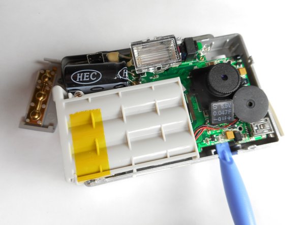

  3. VuPoint DC-ST210-VP LCD Screen Replacement, Pry Backplate Off: crwdns2935265:03crwdnd2935265:01crwdnd2935265:02crwdne2935265:0 VuPoint DC-ST210-VP LCD Screen Replacement, Pry Backplate Off: crwdns2935265:03crwdnd2935265:02crwdnd2935265:02crwdne2935265:0
    • Using a prying tool or fingernail, gently separate the back plate from the front plate, exposing the inside of the camera.

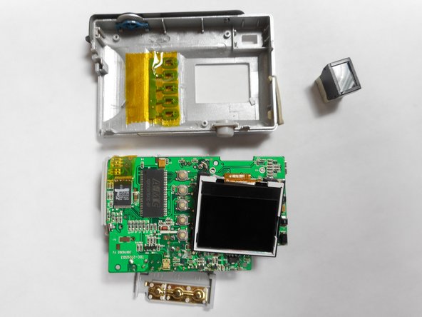

  5. VuPoint DC-ST210-VP LCD Screen Replacement, Seperate Circuit Board: crwdns2935265:05crwdnd2935265:01crwdnd2935265:03crwdne2935265:0 VuPoint DC-ST210-VP LCD Screen Replacement, Seperate Circuit Board: crwdns2935265:05crwdnd2935265:02crwdnd2935265:03crwdne2935265:0 VuPoint DC-ST210-VP LCD Screen Replacement, Seperate Circuit Board: crwdns2935265:05crwdnd2935265:03crwdnd2935265:03crwdne2935265:0
    • Using a pry tool or fingernail, gently pry the circuit board from the base.
    • Gently lift the lower right hand corner of the circuit board, separating it from the base.

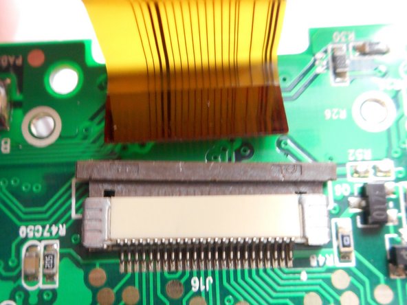

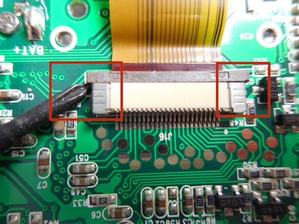

  6. VuPoint DC-ST210-VP LCD Screen Replacement, Remove LCD from Connector: crwdns2935265:06crwdnd2935265:01crwdnd2935265:03crwdne2935265:0 VuPoint DC-ST210-VP LCD Screen Replacement, Remove LCD from Connector: crwdns2935265:06crwdnd2935265:02crwdnd2935265:03crwdne2935265:0 VuPoint DC-ST210-VP LCD Screen Replacement, Remove LCD from Connector: crwdns2935265:06crwdnd2935265:03crwdnd2935265:03crwdne2935265:0
    • Locate LCD and gently bend it back to reveal ribbon cable connector.
    • Using small screw driver or tweezers gently slide the edges of the ribbon lock towards the direction of the cable.
    • Once the lock is opened, use tweezers to slide the ribbon cable from the connector.
    • Replace LCD as needed and repeat steps in reverse to reassemble.
