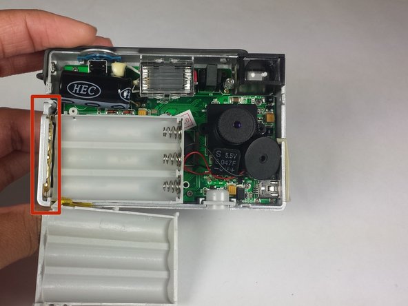

  4. VuPoint DC-ST210-VP Battery Door Cover Replacement, Remove Battery Case Screw: crwdns2935265:04crwdnd2935265:01crwdnd2935265:01crwdne2935265:0
    • Remove the 4.5mm screw with the iFixit ph#00 screwdriver
  5. VuPoint DC-ST210-VP Battery Door Cover Replacement, Open the Battery Case: crwdns2935265:05crwdnd2935265:01crwdnd2935265:02crwdne2935265:0 VuPoint DC-ST210-VP Battery Door Cover Replacement, Open the Battery Case: crwdns2935265:05crwdnd2935265:02crwdnd2935265:02crwdne2935265:0
    • With your fingers, gently pull the two pieces of the battery case apart. At this point, the battery door should be exposed
  6. VuPoint DC-ST210-VP Battery Door Cover Replacement, Remove the Battery Cover: crwdns2935265:06crwdnd2935265:01crwdnd2935265:01crwdne2935265:0
    • With your fingers, gently remove the battery door.
    • Now you are free to repair or replace the battery door! Follow these steps in reverse order to reassemble the camera.
