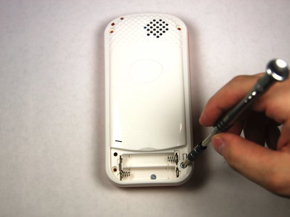

    • Using a Phillips #1 screwdriver, remove the 4.8mm screw on the battery cover by twisting the screwdriver counter-clockwise.
  2. Vtech Touch and Swipe Baby Phone Power Switch Replacement: crwdns2935265:02crwdnd2935265:01crwdnd2935265:03crwdne2935265:0 Vtech Touch and Swipe Baby Phone Power Switch Replacement: crwdns2935265:02crwdnd2935265:02crwdnd2935265:03crwdne2935265:0 Vtech Touch and Swipe Baby Phone Power Switch Replacement: crwdns2935265:02crwdnd2935265:03crwdnd2935265:03crwdne2935265:0
    • Remove the two AAA batteries by pulling on one end of the battery and lifting it straight out.

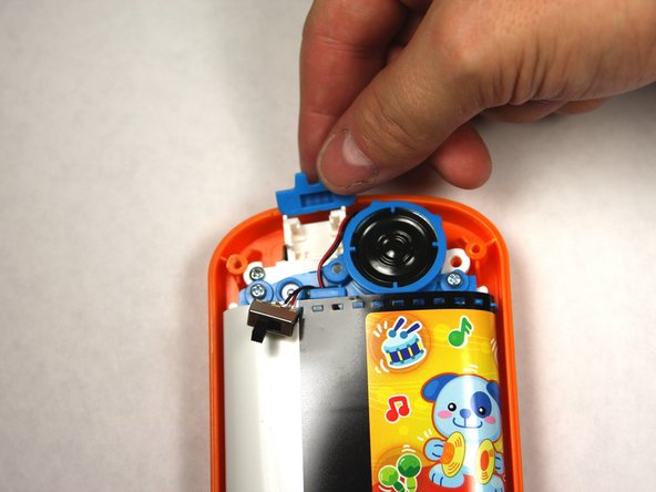

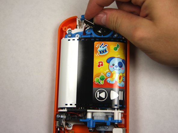

    • Lift directly up to remove the switch and lay the wire down to the side.
    • Once the switch has been taken out you can remove the switch's casing.

Good work.
I have done it the same way,
the wire at the switch was bad soldered,
but it was easy to repair it and i soldered it new.
