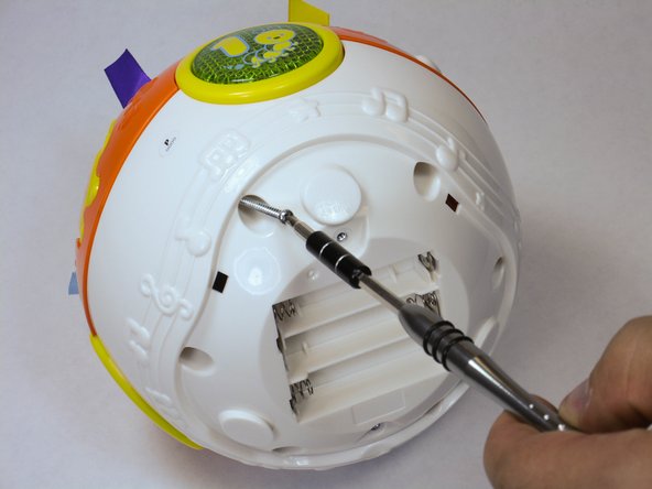

    • There are two screws that require a 4.0mm flat head screwdriver. Twist them counter clockwise to remove. When you remove them they stay contained within the blue outer case.
  2. Vtech Move and Crawl Ball Speaker Replacement: crwdns2935265:02crwdnd2935265:01crwdnd2935265:03crwdne2935265:0 Vtech Move and Crawl Ball Speaker Replacement: crwdns2935265:02crwdnd2935265:02crwdnd2935265:03crwdne2935265:0 Vtech Move and Crawl Ball Speaker Replacement: crwdns2935265:02crwdnd2935265:03crwdnd2935265:03crwdne2935265:0
    • Pry the batteries out with your finger. When you replace them be sure to orient them correctly according to the markings in the slots. Match the plus symbol on the battery to the plus symbol in the slot.

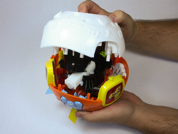

    • Remove 6 screws in order to pop off the outer shell and reach the inside components.

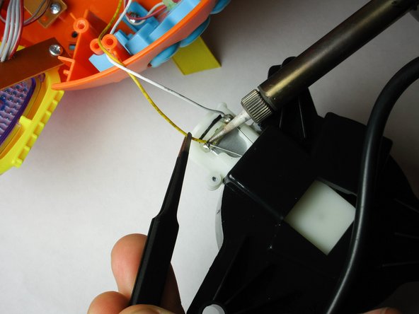

    • Remove the motor by lifting it out of the shell, and find the attached wires at both ends: the circuit board and the motor itself. Use the soldering iron to remove the existing attachments by heating the solder joint with the solder iron tip while pulling on the wire.
    • Make sure the motor is aligned over the correct holes during reassembly.

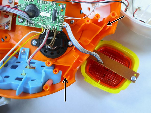

    • When the white cover and the ball motor have been removed, the 6 push buttons will be easily accessible. 3 of the buttons can be removed from their slots by gently pulling up on each. The other 3 buttons are located lower in the unit and are held in by 1 phillips screw each.
    • When reassembling ensure that the button is in the inner slot circled in the picture with the button, and shown by the arrows with the button removed.

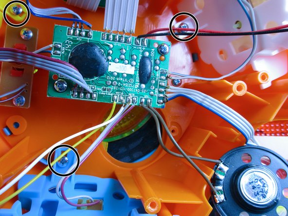

  6. Vtech Move and Crawl Ball Speaker Replacement: crwdns2935265:06crwdnd2935265:01crwdnd2935265:01crwdne2935265:0

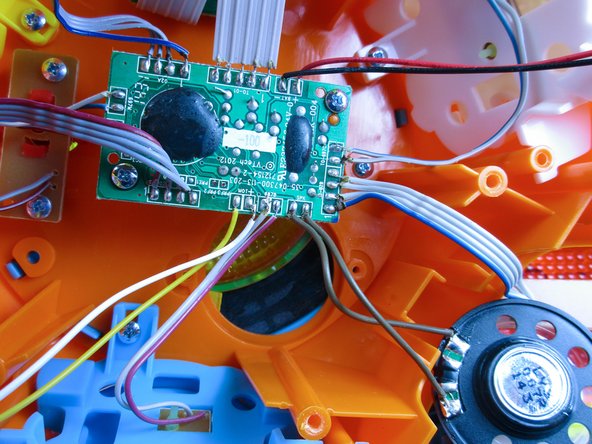

    • The button which is being replaced needs to be disconnected from the motherboard using the soldering iron. The replacement should be soldered into the same place.
  7. Vtech Move and Crawl Ball Speaker Replacement, Speaker: crwdns2935265:07crwdnd2935265:01crwdnd2935265:01crwdne2935265:0
    • Remove the two 9mm phillips head screws, located on either side of the speaker housing.
  8. Vtech Move and Crawl Ball Speaker Replacement: crwdns2935265:08crwdnd2935265:01crwdnd2935265:03crwdne2935265:0 Vtech Move and Crawl Ball Speaker Replacement: crwdns2935265:08crwdnd2935265:02crwdnd2935265:03crwdne2935265:0 Vtech Move and Crawl Ball Speaker Replacement: crwdns2935265:08crwdnd2935265:03crwdnd2935265:03crwdne2935265:0

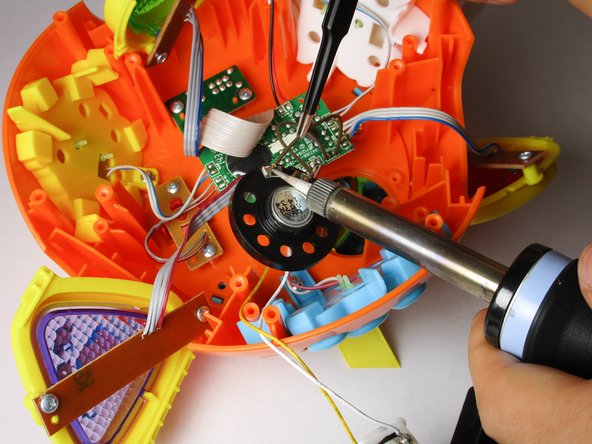

    • Remove the solder from the wire connections on the speaker by heating the solder joints with the solder iron and pulling on the wire at the same time.
    • Solder the wires to the new speaker by touching the wire to the speaker contact while heating with the solder iron and feeding solder wire into the joint.
    • When soldering the wires to the new speaker it does not matter which wire is attached to which speaker connector.
    • Ensure that the speaker connections on the main circuit board are not damaged during the speaker replacement.
