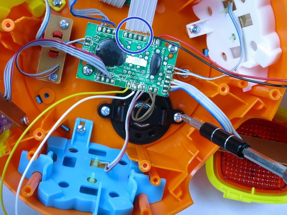

  5. Vtech Move and Crawl Ball Power Switch Replacement, Power Switch: crwdns2935265:05crwdnd2935265:01crwdnd2935265:01crwdne2935265:0
    • Unscrew the two screws to the power switch located beside the circuit board

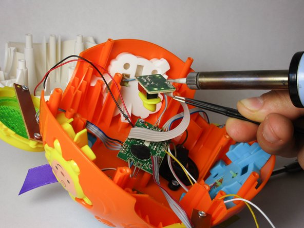

  6. Vtech Move and Crawl Ball Power Switch Replacement: crwdns2935265:06crwdnd2935265:01crwdnd2935265:03crwdne2935265:0 Vtech Move and Crawl Ball Power Switch Replacement: crwdns2935265:06crwdnd2935265:02crwdnd2935265:03crwdne2935265:0 Vtech Move and Crawl Ball Power Switch Replacement: crwdns2935265:06crwdnd2935265:03crwdnd2935265:03crwdne2935265:0
    • Remove the existing attachments at both ends of the wires with the soldering iron. Heat the solder joint with the solder iron tip and pull the wire.
